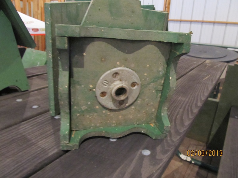

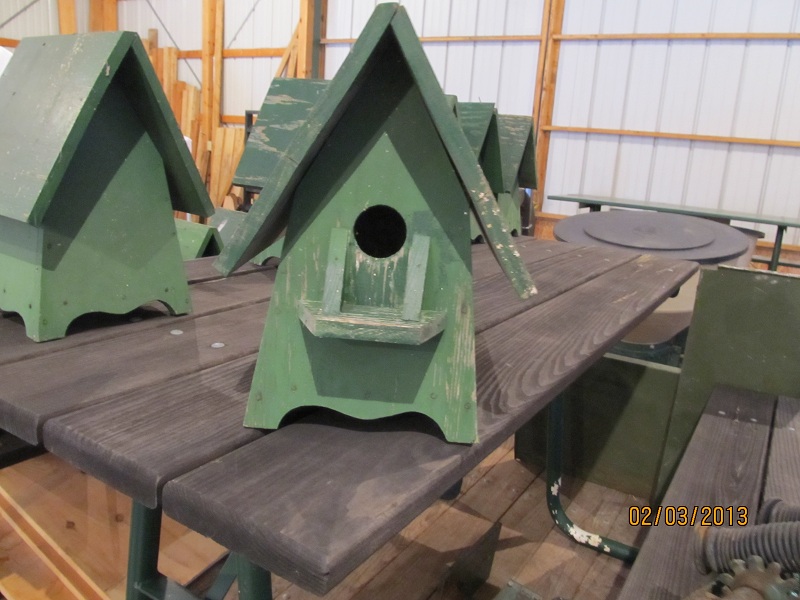

These are my birdhouses for tree swallows that I built many years ago out of white pine. Problem is the wood is half inch thick and you can see the tops have warped and the pieces are loose and shaky. My plan is to replace the wooden top and bottom with something more durable . I'd take them all apart and nail and glue everything. Trouble is, what should I use for wood?
Years ago I made some signs out of some sort of a paper coated plywood looking stuff that nailed and painted well but I can't recall what it was or where I got it. It was left over from some road signs. It seems like a good choice since plywood would curl up like the pine already on there. Pine would work, maybe, but that in 1/2" would curl as well. I've got about 20 of these I think.

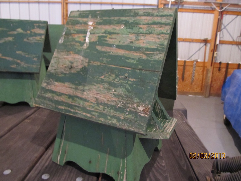

Attached are some photos and you can see the curling roof I want to prevent. Any advice appreciated.

solid wood planed to 1/2" is vulnerable regardless...if you can find something that is suitable "quartersawn" boards are more stable...
I like to use cypress for bird boxes and feeders (weathers well without any finish) I usually use bronze ring shank nails (except for the clean out panels)...

I believe you are thinking of Medium Density Overlay (MDO). Lumber yards may not stock it, but they should be able to order it.

There's nothing wrong with your bird houses. but... just like your own home. It requires some upkeep. My suggestion to make your bird houses more maintenance free is to take some thin sheet metal and cover the roof, paint it and it will last a long long time. Pine is by far IMHO the best material to build them out of.

use some roofers tin for the roof.

You could always make them out of some Azek trim-boards. and be truly maintenance free. I save all the extra pieces from the house and find them handy for small weather proof projects.
