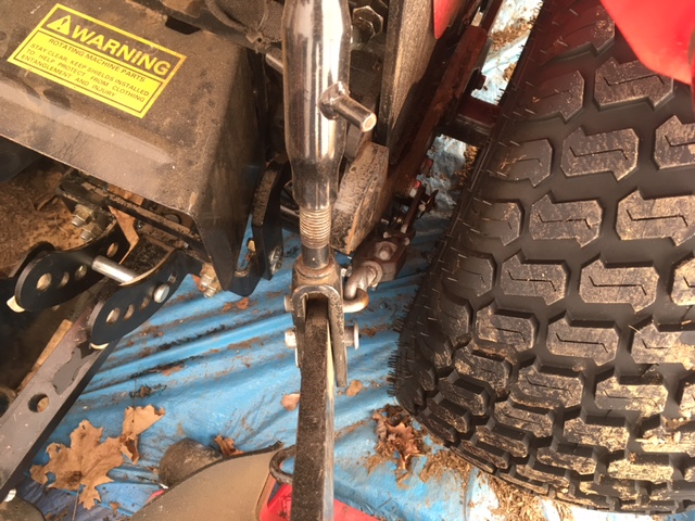

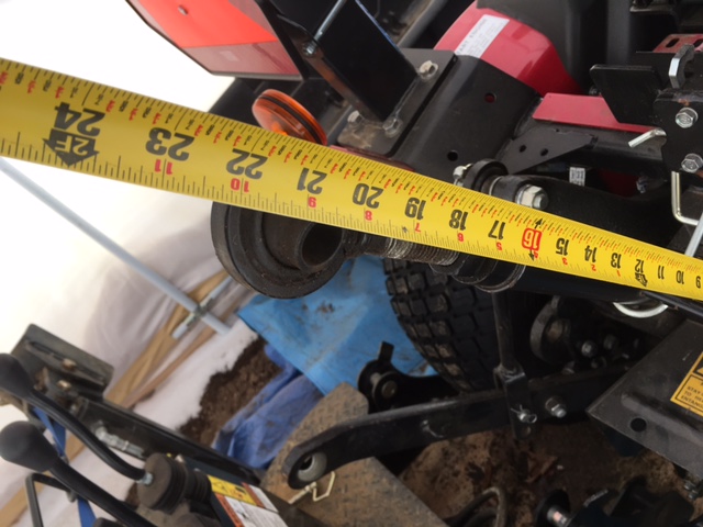

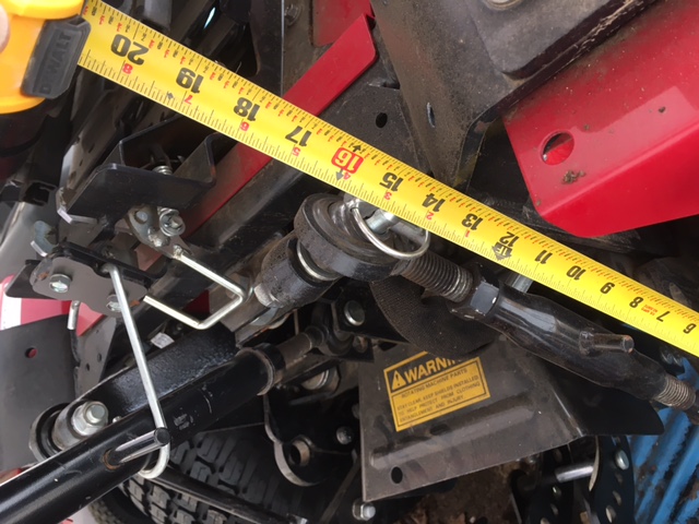

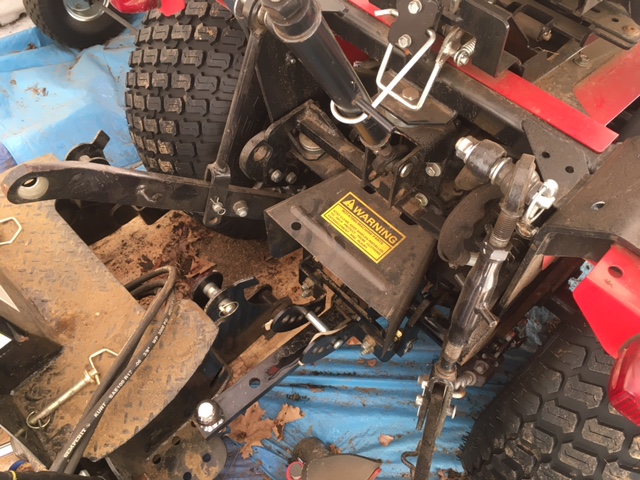

I just bought a Max 25 with backhoe, MMM, and fel it was a repo and it did not have the 3 pint side links and top link on tractor because backhoe was installed.
What I need help with if someone with a Max 22 or Max 25 could give me the dimensions for the top link Hole to hole dimensions installed and the side links hole to hole dimensions installed
I priced these at Mahindra and it will be over $1000.00 to buy the 3 links. I think I would be able to buy universal 3 point setup for alot less money if I had the dimensions .
Thanks
   / Need Help #2
IMG_0299.JPGI think this is what you are looking for. I have a Max 22. The top and right bottom links are adjustable. Also note the bottom of the lower links are offset at an angle.
