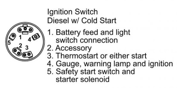

Aug 20, 2023 / need help #1 H H L T 49 New member Joined Aug 20, 2023 Messages 3 Tractor ford 4610SU wiring position on key switch on ford 4610SU diesel no cab and starter
Aug 20, 2023 / need help #2 T TractorTech Elite Member Joined Jan 26, 2012 Messages 2,766 Location California Tractor Ford 7710, Ford 550, Ford 1910, Ford 4430, KD Forklift, Ford LGT17H, New Holland L255 Skidsteer Welcome to TBN. Here is a diagram Attachments Ignition Switch Terminals.jpg 70.7 KB · Views: 94 Last edited: Aug 20, 2023

Aug 20, 2023 / need help Thread Starter #4 OP H H L T 49 New member Joined Aug 20, 2023 Messages 3 Tractor ford 4610SU would you have a picture of it with wires hooked up
Aug 20, 2023 / need help #5 T TractorTech Elite Member Joined Jan 26, 2012 Messages 2,766 Location California Tractor Ford 7710, Ford 550, Ford 1910, Ford 4430, KD Forklift, Ford LGT17H, New Holland L255 Skidsteer Hope you can read this Attachments Ford Tractor Ignition Switch 5 Position.jpg 159.1 KB · Views: 101
