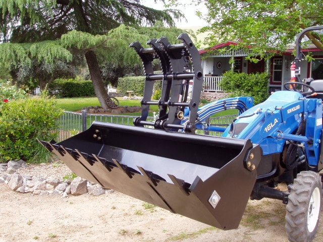

I recently posted a four part grapple install on my TC40. It took me over a month of work to finally pull the lever and see it in action-and that was today! The grapple is as yours, running off of the rear remotes and I too had no other example to fall back on and duplicate. There might be some helpful info for you in that read which is posted in the ATTACHMENTS section.

You will find that the lines will need to be the longest with the grapple in the dumped postion.
I would mount quick couplers to my loader mast near the bucket pivot and run lines from them to your rear SCV. Then make separate lines from the couplers to the grapple. Lot easier to remove the grapple and these will be the lines that get damaged and need to be replaced. I'd rather replace a 4' line than a 16' line.
   / Need hydraulic lines for Grapple (advice) #5
You're probably done with the project but if not, use an air hose line (or garden hose) threaded where you want and mark the end with a marking pen, unravel it, lay it flat on the floor and measure. Add a foot or so for last minute mind changes. Go to the hydraulic shop and have ONE end of each new hose crimped with your fitting of choice. Take it home, thread it through the tractor and final mark it by wrapping each hose in tape and strike a final/final marking pen line on them. Back to the hydraulic shop for the last set if crimped fittings. They will not be of equal length due to the staggered connections on the hydraulic cylinder.
