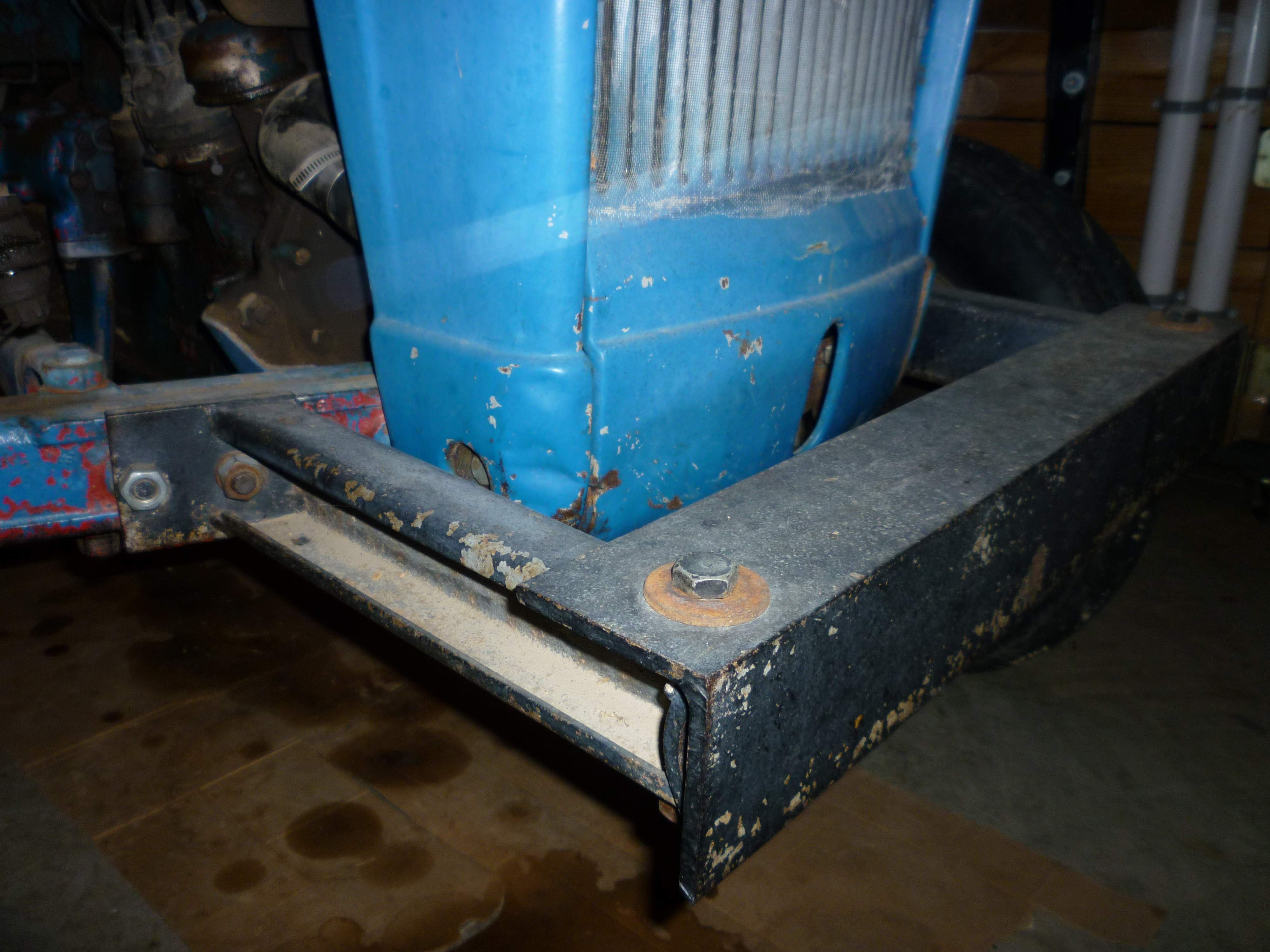

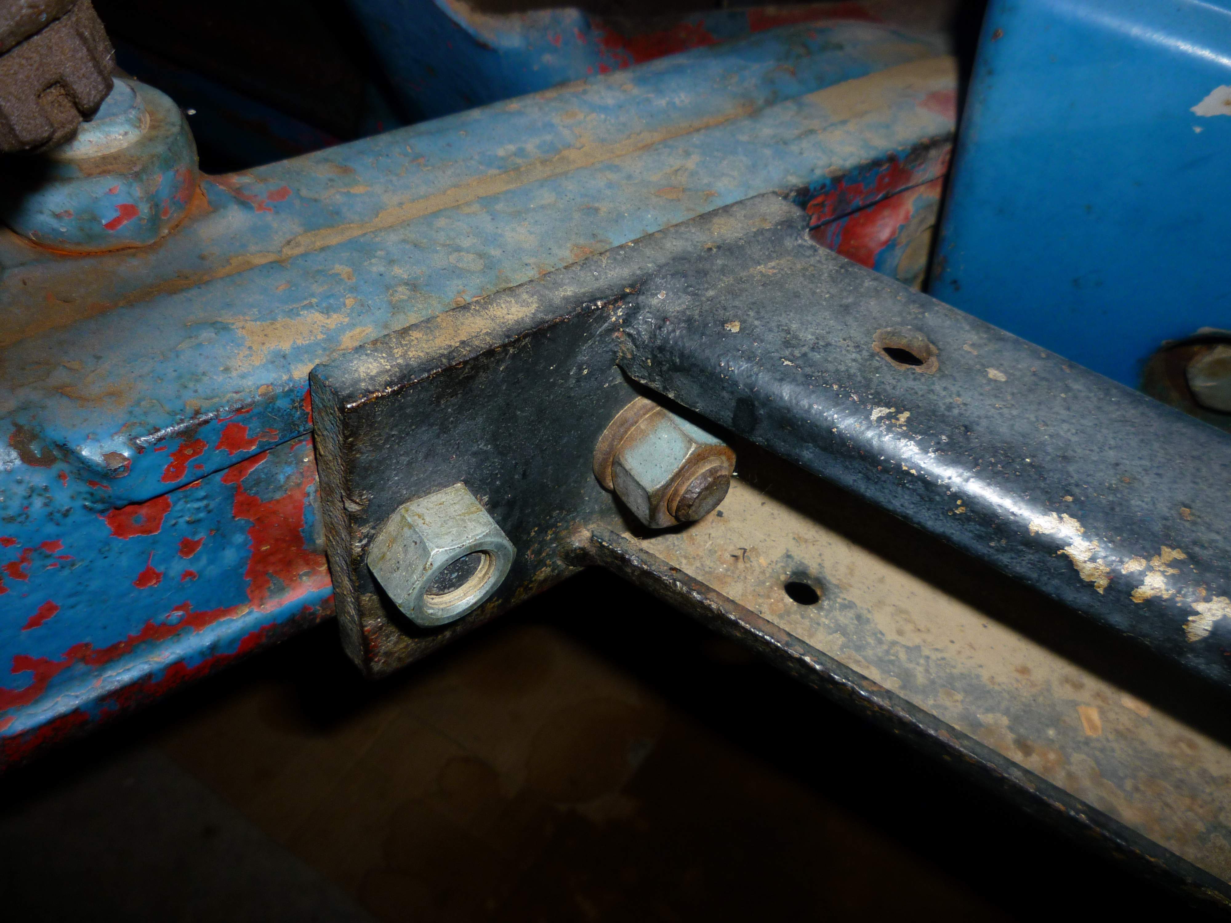

The front end on my Ford 800 is too light.I need some type of weight up front so when plowing or disking the front end is not always in the air when turning.Thought about bolting 50 lbs or so to each axle side where the line of holes are.Any other thoughts ? Thanks

I snapped a couple pictures of the front bumper of my 850. You should be able to fab something similar to line up with the holes and bolt through like this is, and then any sort of cross bar to attach the weights.
