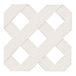

1) Use the three-rail vinyl fence and complement this with a 'privacy lattice' that I cut into three slats to be placed between the bottom rail and the ground. I can screw this into the bottom rail and have it staked into the ground. The benefit is it will complement the look of the current fence.

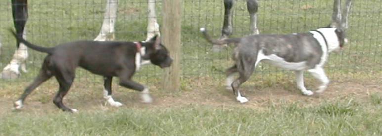

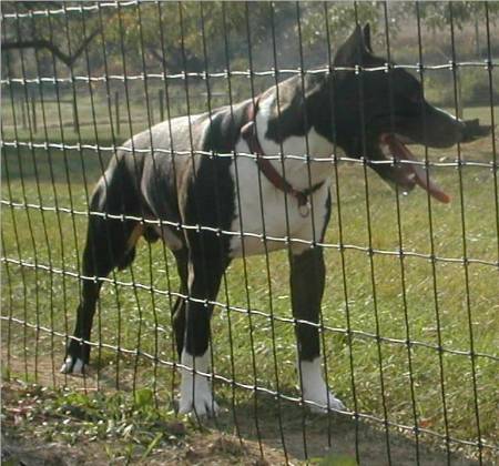

We went with black Woven Wire, and used this at two different properties. Some people call this no-climb. It is horse fence, and does exactly what you are looking to do: Keep the horses out, and the dogs in. If you go with the black, it really disappears giving you total view of your horses in their pasture. We simply pounded wood posts every 8 feet, then stretched/attached this wire to the posts at ground level. At a previous property I actually went to the effort of sinking the wire 6 inches into the ground... this would make our dogs dig about 18" down to have enough room to escape. Well, the dogs never once tried to dig under the fence! It was a tremendous amount of work, so I vowed never to do it again. Glad I don't own Bassets like Phiferpharm, because at our second property I just attached the woven wire to the posts at ground level. We installed 60" wire in 300' rolls. I attached a link to the place we purchased it from (Kencove Fence)... I could not find 60" high wire, rather only the 48" and only in a 200' roll. I am sure other places have something similar. I would highly recommend the black wire. Here is the link: Woven 13/48/2 Class III 200 ft Black
All that said, this stuff has been great! We have never had an issue with it. Our stallions are often in the pastures that touch our fenced-in back yard, and they have never damaged this fencing (our post and rail is another story!). I will try to find a picture of our fencing. Out of 4 dogs, only one escapes by jumping the 5' fence. His motivation is to eat horse manure!

I will try to attach a couple of pics... first one is of Rommel, our 5' fence jumping, horse poop eatin', American Staffordshire. Second pic shows two of our dogs making sure the horses stay on their side of the fence!
