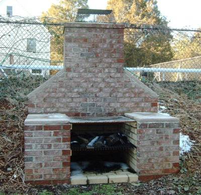

My FIL built us a stone fireplace next to the pool in NJ. Got some photos of it that I can scan in. However, our brick one out back is the same design and is actually bigger. Just checked my photo stuff for the house and haven't taken one or scanned in the image of it yet. Let me know if you want a pic. I've a digital camera now. It's just out the back door of the basement built into the sloping dirt bank on the east end of the pool.
Used fire brick inside the cooking pit and the chimney on this one and the one in NJ.
Ralph

   / Need Info on Building an Outdoor Fireplace #6
Here's the front of the fireplace.
Ralph

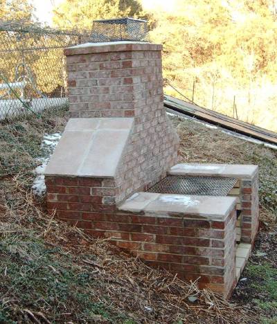

   / Need Info on Building an Outdoor Fireplace #7
Here's the fireplace from the side.
The wife dug out for the footings for this beast.
Ralph
Nice ... you did the brickwork?
   / Need Info on Building an Outdoor Fireplace #9
No, we paid a mason about $2,000 to build it.
I tried some brick work in Baton Rouge over the sides of a culvert and then on a barbeque. Didn't do so well. Got several snide remarks about it. Didn't use firebrick either. It was starting to crumble inside when we sold the house.
My FIL was a good mason. Should have learned something from him but never was around when he did the work for us in NJ. He built a tad smaller version of the brick one out of NJ field stone, all from our 1/3 acre. Don't have enough field stone here.
Ralph
   / Need Info on Building an Outdoor Fireplace #10
Fire brick does not do well when moistened and heated such as would occur in an outdoor fireplace. Just plain bricks may also suffer the same spalling effects.
It is made for dry operation.
I'd try for the firebox area to be heavilly parged with concrete mixture using mortar sand, excess cement for strenght and mortar cement for stickiness. Use a few layers of chicken wire or equvalent with smaller holes with the cement. The more layers the better. You'll have to concote this mixture youself and avoid all premix bags.
