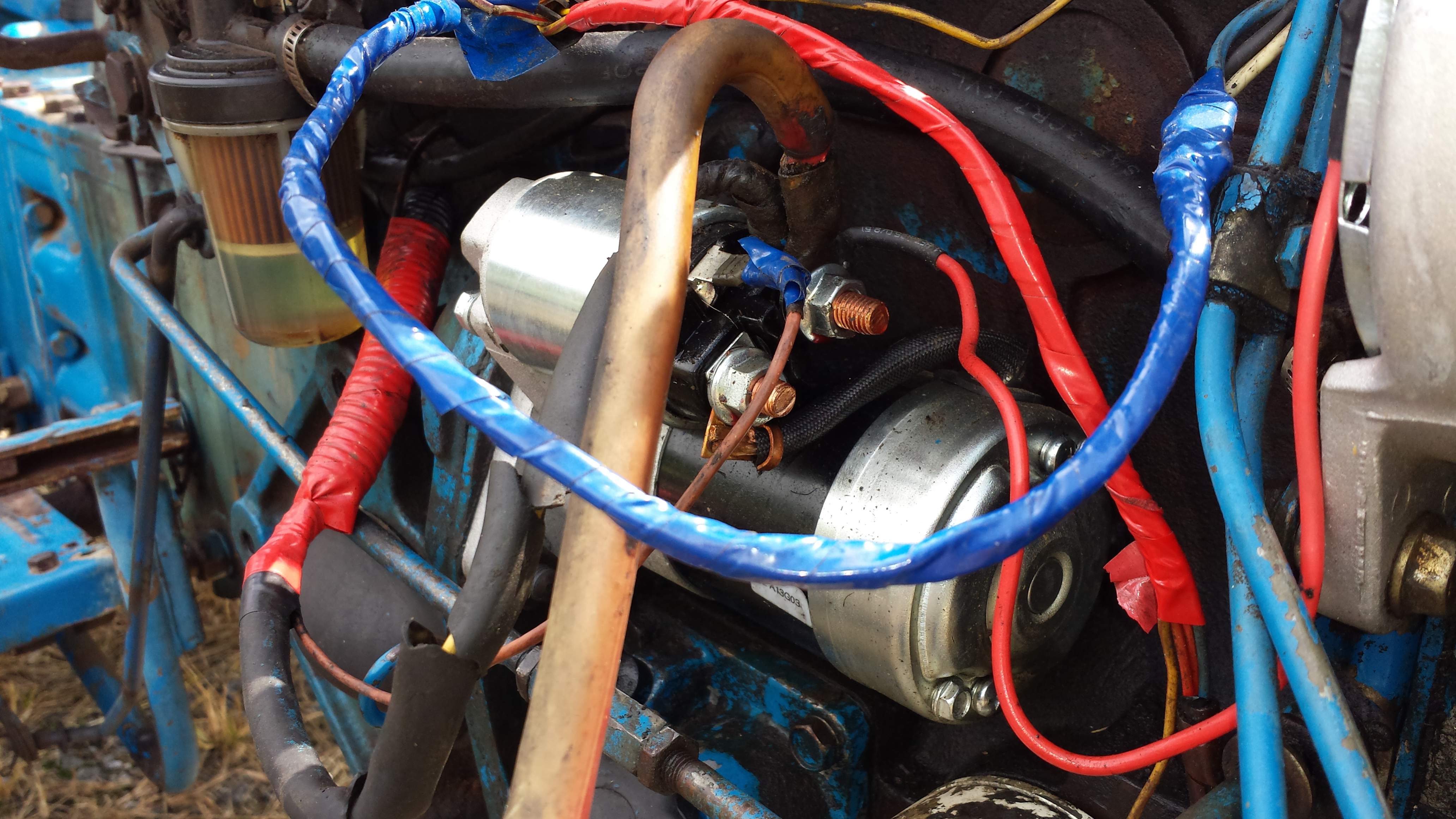

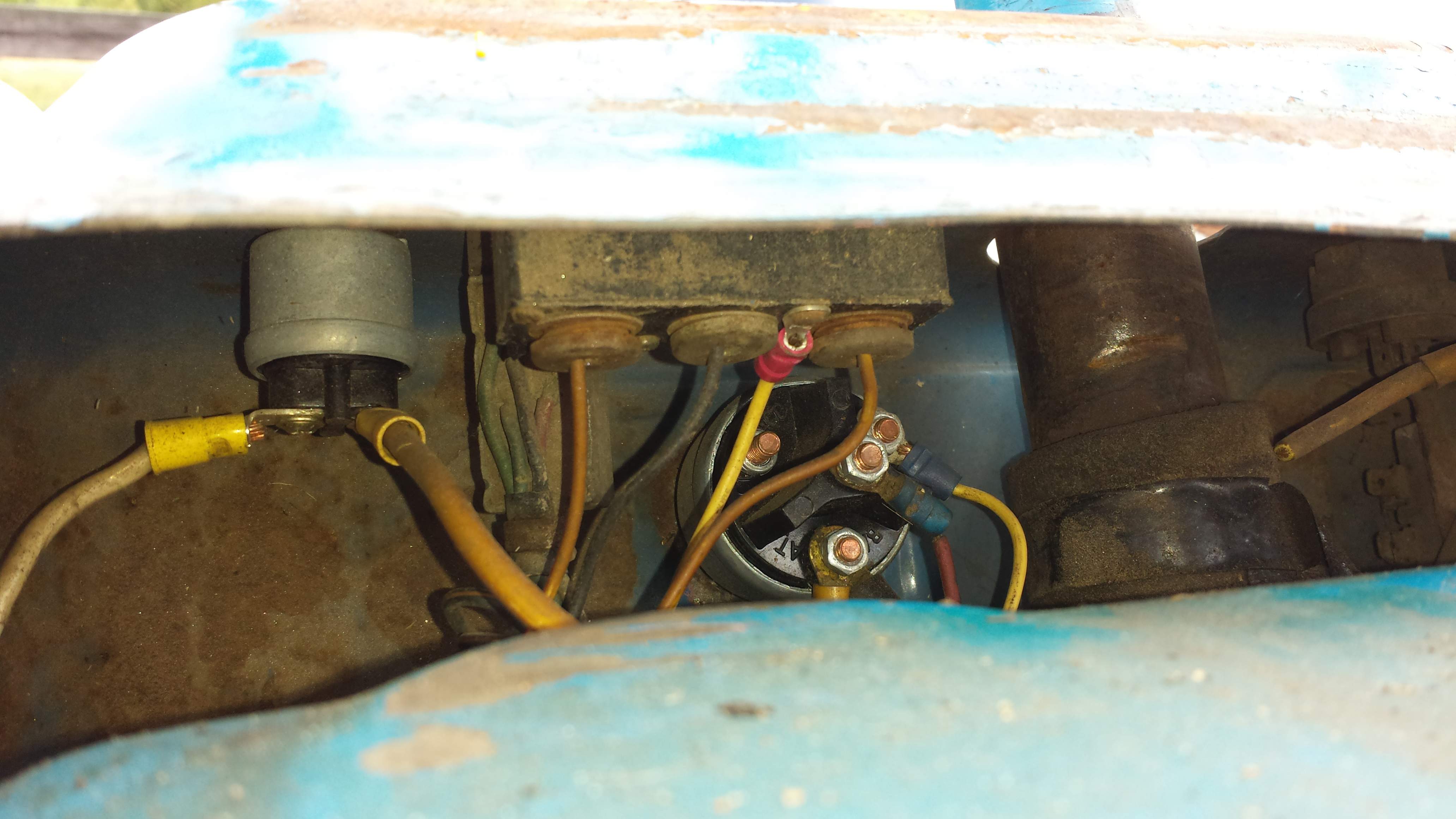

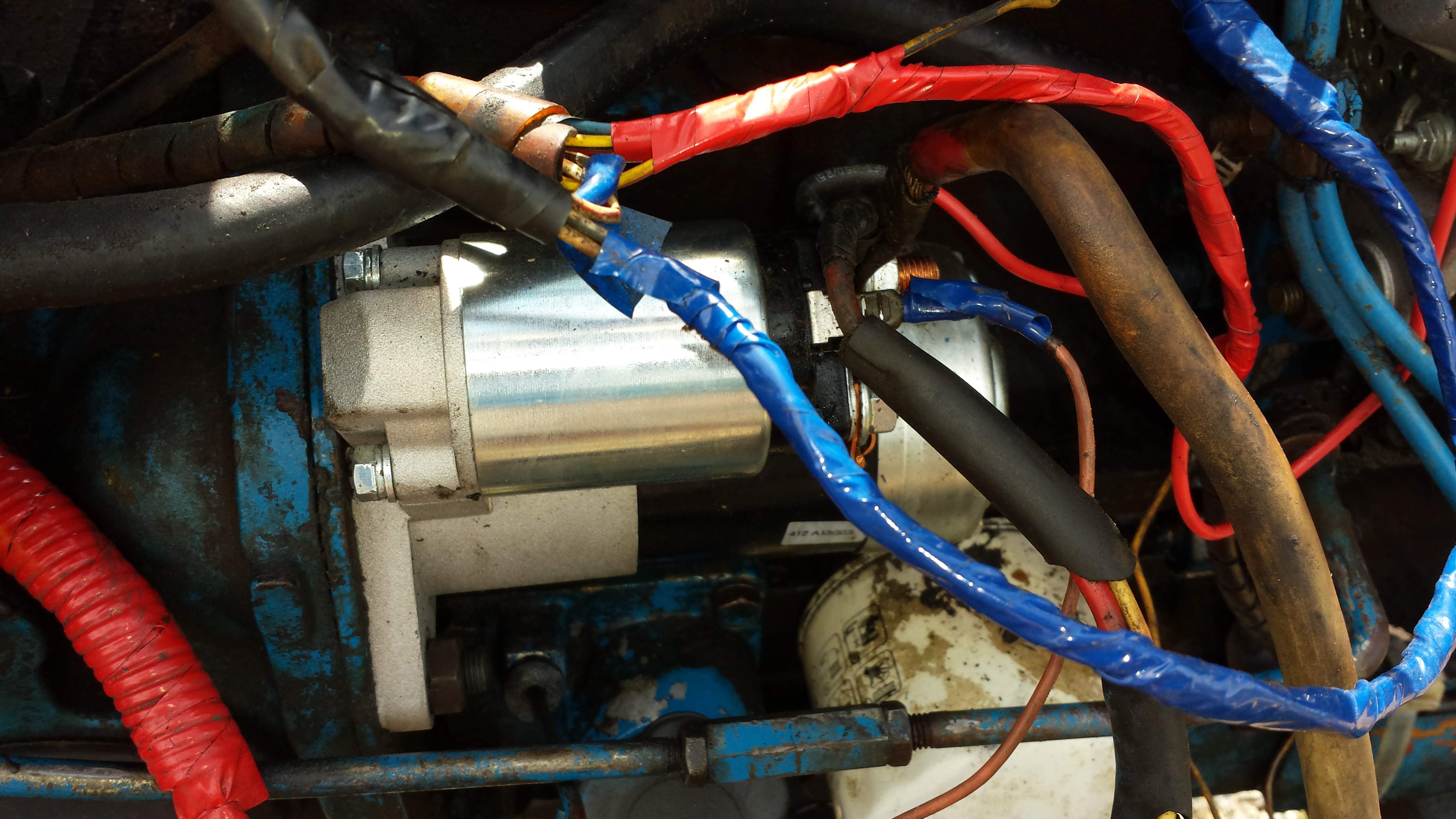

Here are some pictures..

yuo need to check the wire that energizes the solenoid. it the starter is turning after releasing key, then check that line. put a test lamp to it.. something must be shorted in the wire harness or behind the kew switch..
