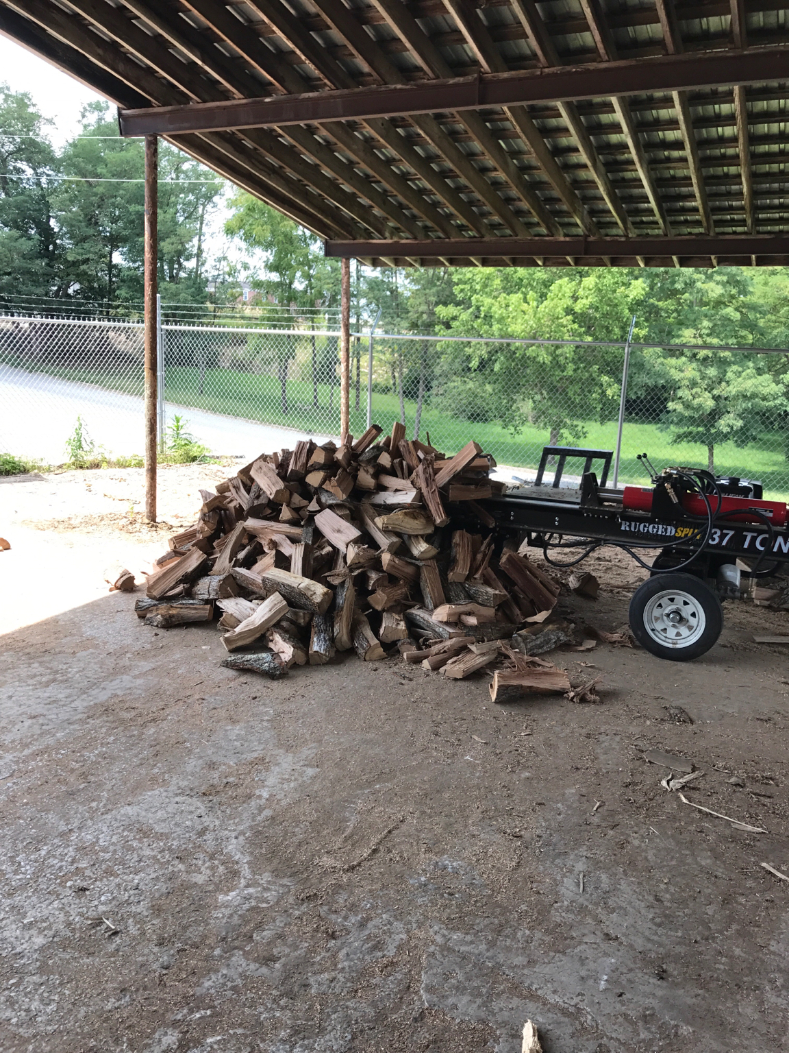

I've got a custom fabricated 4 way. The 4 way that came with my splitter was awful. It's not adjustable height but it's still a slip on. It very rarely rides up and only does so if you've got a nasty piece. Here's about an hours worth by myself. If you're running wood that's the right size to shove through once ( that pile was mostly 12-16" stuff) and have a helper you could do a lot better. Just having a lever pusher helps quite a bit. IMG_0390.JPG I figure I can cut and split a rick by myself in an hour, but I couldn't hold that rate very long.
