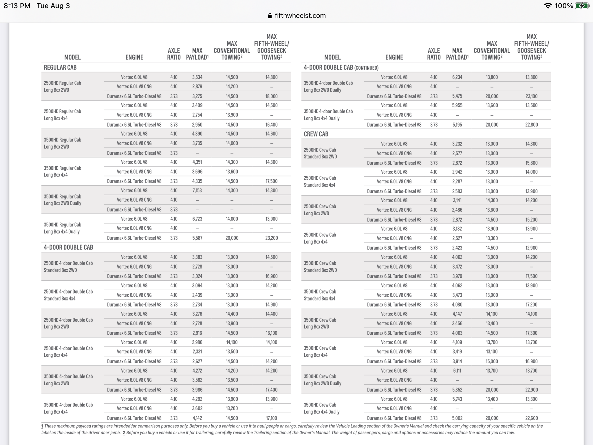

Not the best market to buy in right now I know. Looking at this truck, 6.0 gas, 2wd, 4.11 gears for our farm tow vehicle. Work truck package. Power windows, power locks, vinyl seats and rubber floors. Give me some opinions. I am familiar with GM as we own a 2015 Yukon XL, but never owner a 2500 or 6.0.
   / Need opinions 2016 Chevrolet 2500HD #2
The 6.0L gas engine was around a very long time and though not very powerful, compared to its competition, it is known for its incredible reliability, even under work conditions. I would be more concerned about 2wd, on a farm.
Conventional tow rating of 13k, gooseneck/fifth wheel at 14,300, isn’t bad.
Here is a factory brochure on it.
I never owned one, but when I worked for the county, the shop had several of them. Theirs were all boringly reliable and trouble-free. Of course, they bought new and buying used always has its risks.
