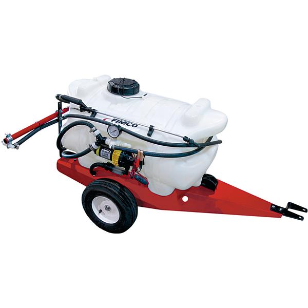

VistanTN,
Actually, the unit I would buy instead of repairing this tank is a 30 gal tow-behind that TSC sells for about $285. I only have about 7 acres in pasture and about 1 1/2 in yard so a pull behind would work with the Kubota and the lawn tractor. I've attached a photo.
I've also looked at TSC and Northern for parts. I have yet to see a boom that I could incorporate into my unit, but the parts I have found sure aren't cheap!
As with so many other things, I was hoping one of the veterans would come up with a site like Sprayers-are-Us or some such that sold exactly what I'm looking for. For me the trade-off mark will be $200.00. If I start getting close to that in parts and my labor, I think I'll be better served by buying the new unit.
