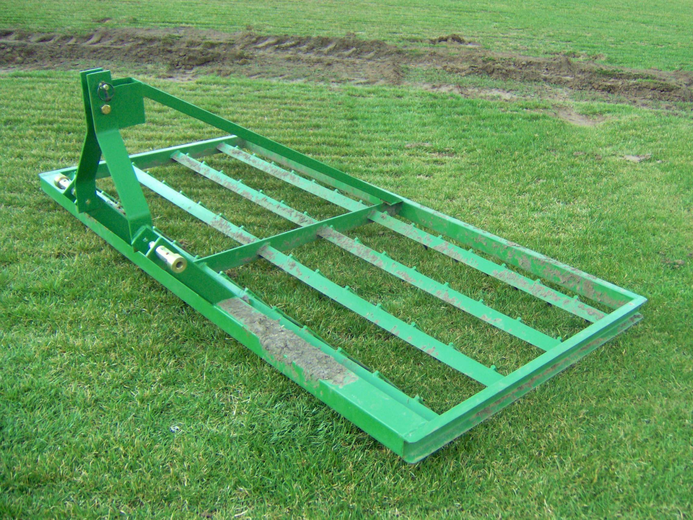

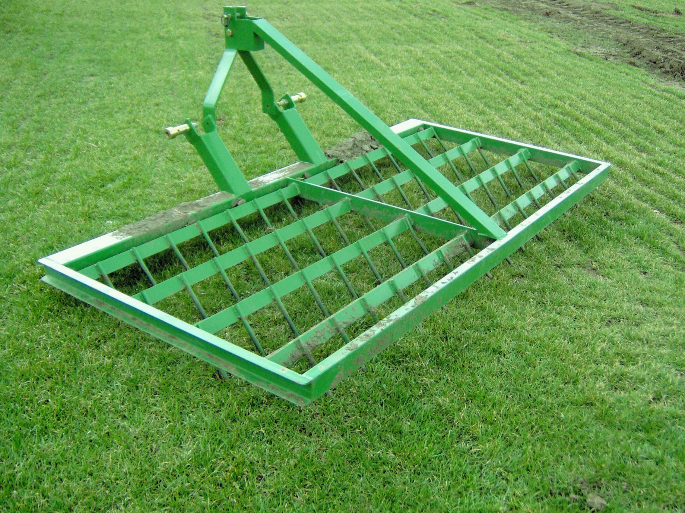

I have an older 3 point 4 section spike harrow that I converted to a pull type. Only problem is the pipe is bent, the flip up points are worn severely and in general it plugs with debris when pulled because of the 3 point arrangement. Does anyone have a good picture of the cables and tow bar used on a pull type harrow?? I want to redo it by making a tow bar with pivot ends. I would sure appreciate any good pictures of a harrow of this arrangement.

Don posted some good pics and site for harrows. I think the important thing to consider when using a 3ph setup is to make sure your linkage or towing point is close to the ground so that you get a level straight line pull.
When i first built this three point harrow i had planned to use a chain on the rear to allow it to flex. i quick saw the error of having the hitch point too high as the back would rise up. i then added the sitffeners and let it float along with the tractor, in most cases that works pretty well. If you look at the hitch closely you can see where i welded the hitch point ridge where i initially had it bolted and hinged. Live and learn i guess.:ashamed:
