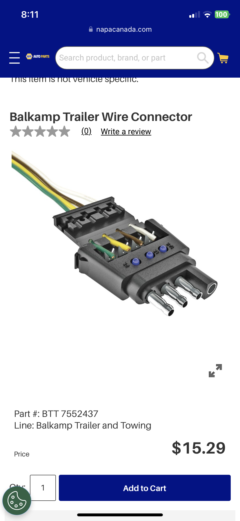

Something like this may be an option.
I’m not a fan of the pinch blade connections but it may be doable.
Yeah I always use corrugated wire conduit and good straps/routing.
Grounds can become an issue with weather.
There’s always a length of wire that’s exposed or on a bend and those cheap wires will let you know they dont like it once the seemingly biodegradable insulation wears down and the piddly stranded wires corrode.
