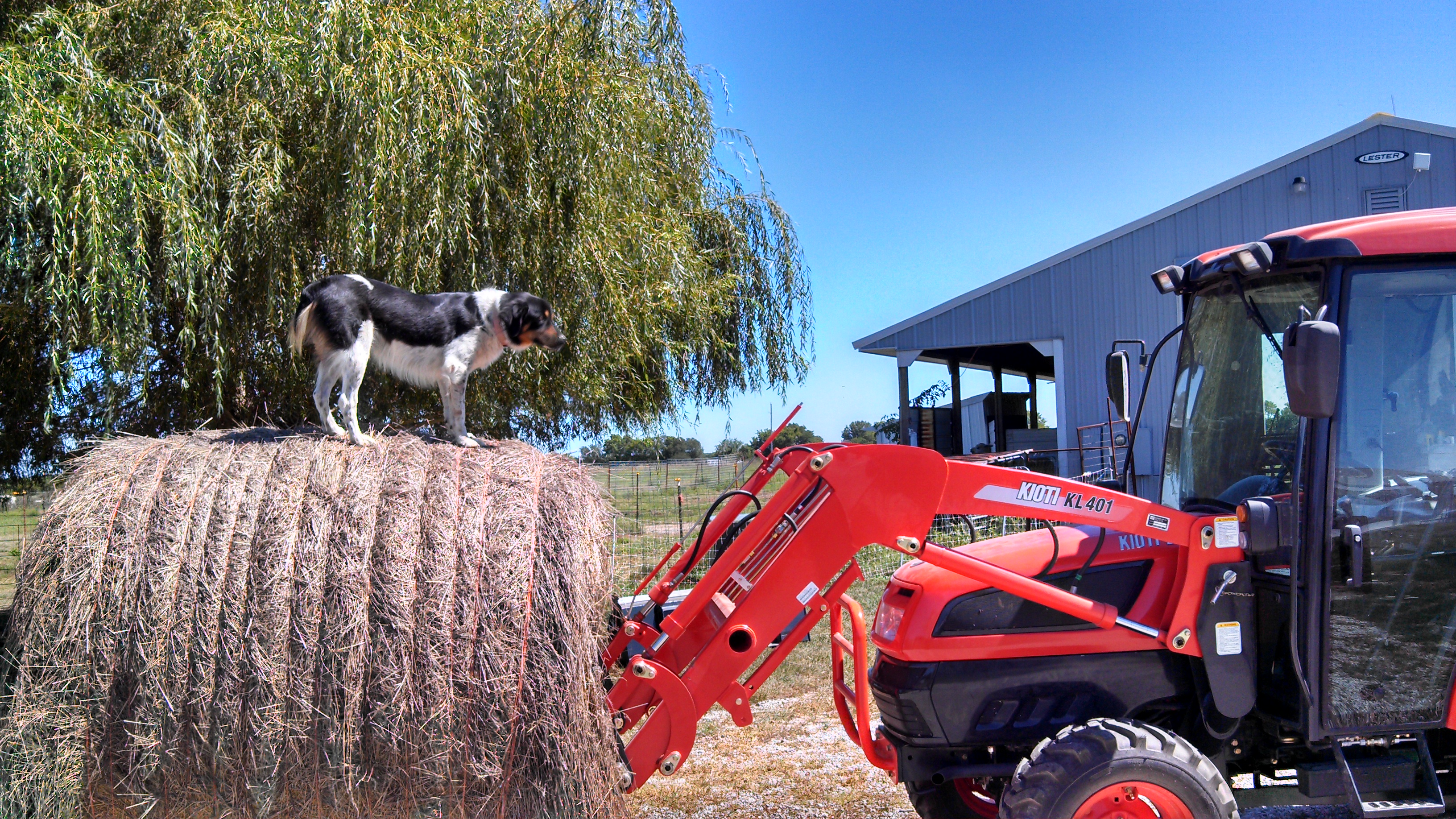

I use my DK45 for feeding 5x6 bales but need the rear bale on first. The loader lifts ok but the tractor wheel base is to small to make movement safe at speeds needed to move a lot of bales. My NH TN55 is what I use to move 200+ bales in from the field. IMG_20130903_122506_477.jpg
