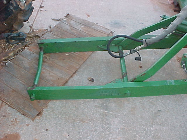

Bill,
My backhoe came with subframe attached, and bracket hardware to mount under the tractor. Only problem was the brackets were made for a different model tractor. Here's a picture of the BH subframe.
OkieG

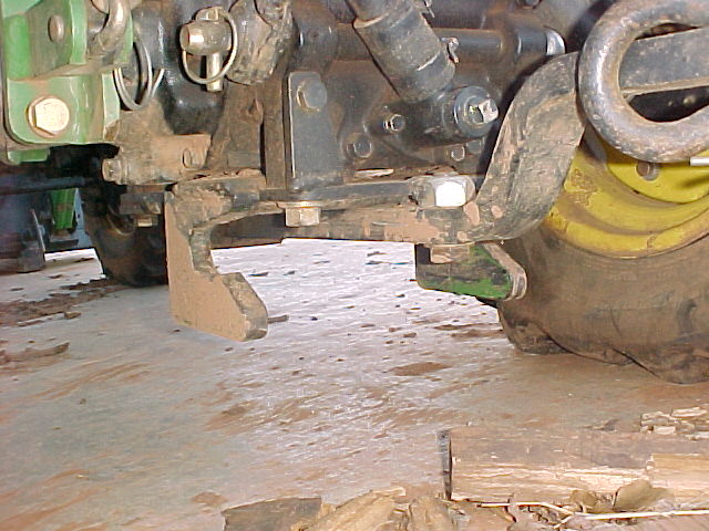

<font color="blue"> not sure where to attach on the rear of the tractor frame. </font>
After cutting the "hooks" off the original rear brackets ('cuz the original brackets wouldn't fit my tractor at all), I welded them onto a plate and used existing bolts to attach to the bottom of the hydrostat transaxle. Pic attached.
The drawbar is installed in the picture, but is removed to mount the BH.
OkieG

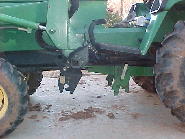

<font color="blue"> The front is not a problem as I planned on making a sub frame when I mounted the snow plow hitch </font>
Bill,
I'm not quite sure what you mean by this. I believe you plan to have your snow plow mounting hardware do double duty and secure the front of your BH subframe? If it's sturdy, that might work fine. I had to modify the OEM backhoe front bracket to fit my tractor. Right now I have the BH brackets mounted and also Front Blade brackets.
This picture shows both sets of brackets. The forward ones are for the front blade, the rear ones are for the backhoe. They look and work similarly. If building a subframe from scratch, I'm pretty sure the front blade brackets could be used to secure the front of a BH subframe. The subframe would just have to be made a bit longer than OEM, to reach the more forward location of the front blade/snow plow brackets.

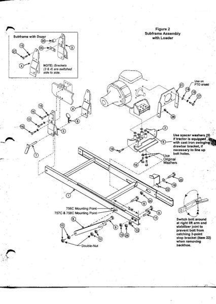

Bill see if this drawing helps you out any. It's pretty straightforward.

Okie and PineRidge thanks for the pics, they are a big help. I just wish there was some bigger hardware under my L2900, I have all 10mm bolts I believe so I will need to attach to many of them to spread the load.

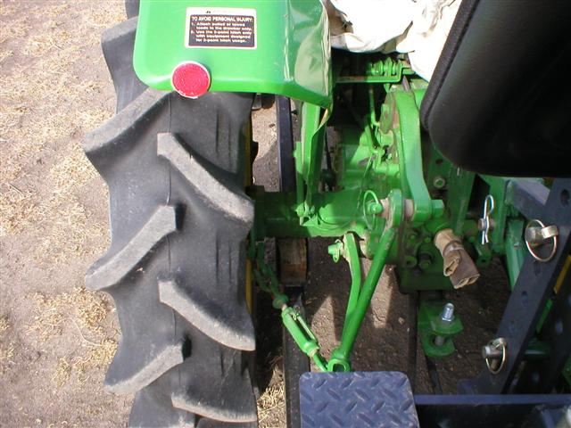

I made a simple backhoe subframe by bolting a piece of 2x2x1/4 inch tube to each side of the hoe frame and to the FEL where it attaches to the tractor midsection.
With the hoe feet down in dig position, I can use the hoe to lift the tractor up on its front wheels so that I can move the machine right or left in order to center myself on the dig line.
The tube is painted black and can be (barely) seen on each side of the rear tire in the attached photo. It has made quite a bit of difference in the hoe's performance.
Hope this helps,
Bill Vorhies

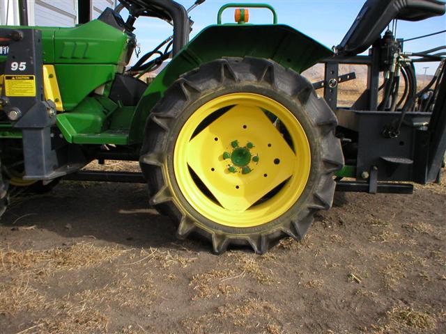

   / Need some help with fabricating hoe sub-frame. #10
Another View: This shows where a block of wood sitting on a piece of channel hits the axel when the tractor is in dig position --hoe feet down. The 2x2x1/4 is doubled in this section for strength.
Regards,
Bill Vorhies
