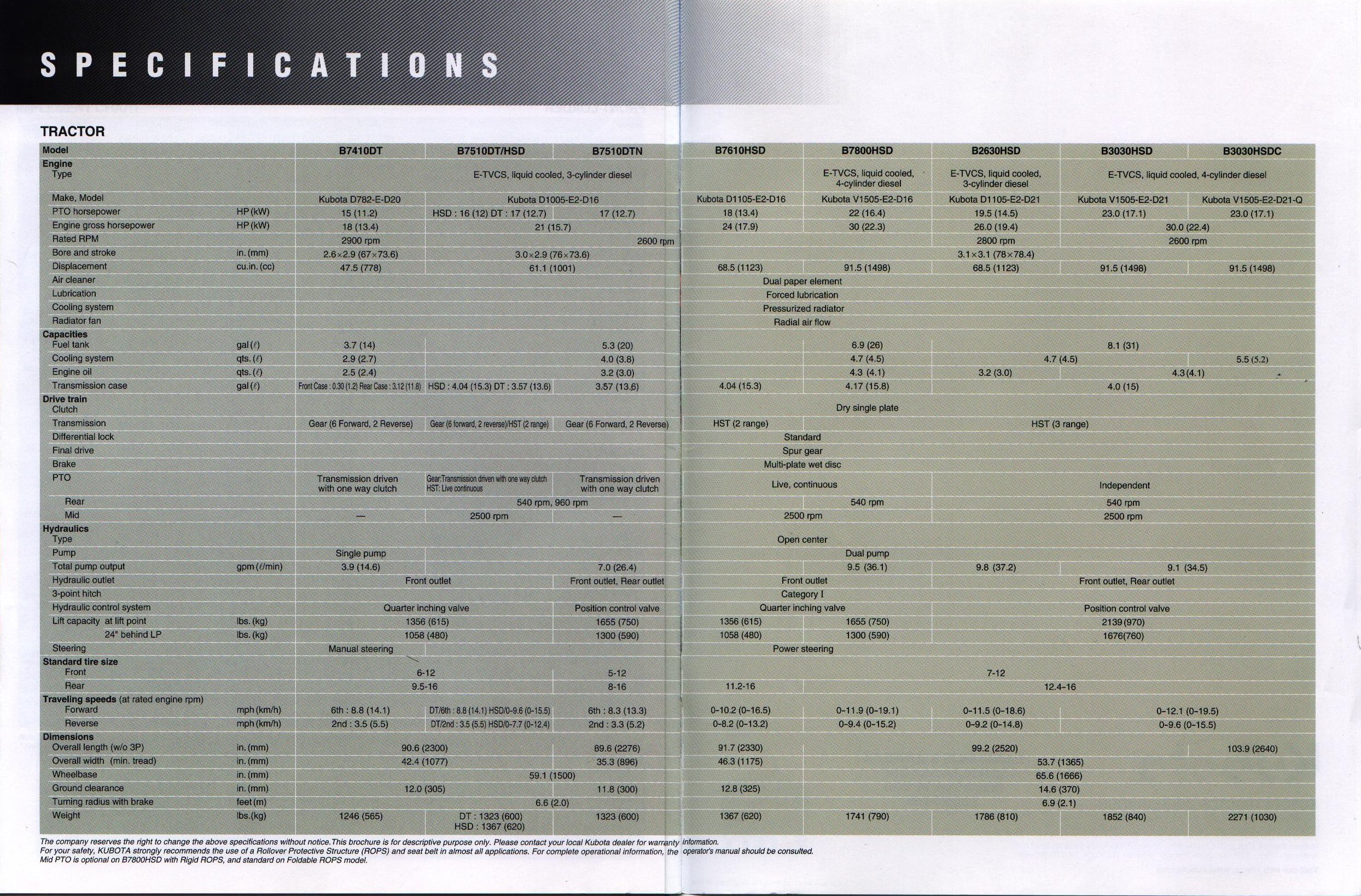

Looking at the B2630 and the B3030.
Looking at the specs, both models have the same lift capacities front and back, and
the same break out force. What will I be missing on the 2630?

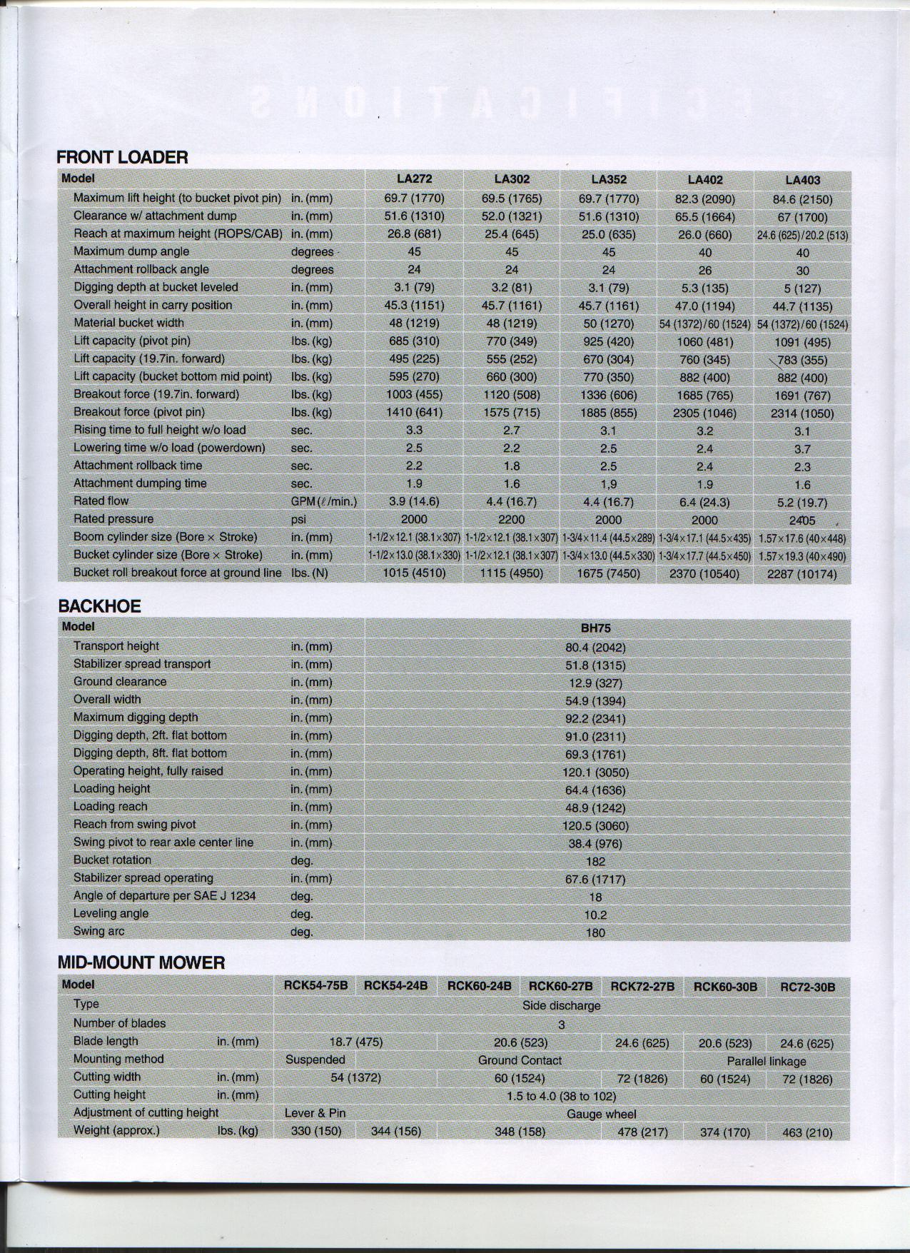

I'm getting differing information when I read various threads.
Can anyone tell me if the B2630 has greater lift capacity (both front and rear pto) that the B7800?
And, does the the B3030 have greater lift capacity than the B2630?
Are there any additional features found on the B3030 that are not on the B2630?
What are the differences between the la402 and la403 loaders?
This will be very helpful-thanks!

Here's some scans from an old brochure I have - approx 2007. Maybe they will help.
