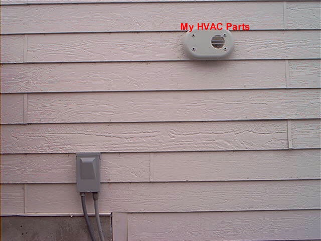

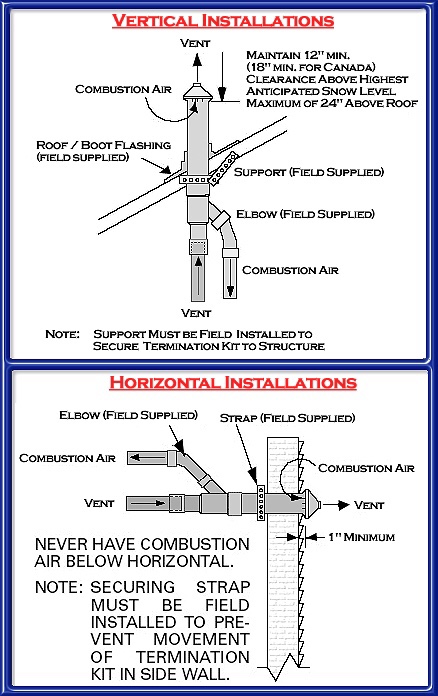

Here in Columbus Ohio, nobody puts 80%ers in a new construction, only place 80%ers go anymore is existing apartment complex/ condos where running PVC is out of the question.
There is both side discharge and above roof concentric kits for forced air flues, the ones that shoot out the side are flat, kinda oval shaped and can match the siding, the roof concentric is kinda large and looks like 4in PVC with a nozzle IMG_1151.JPGIMG_1153.JPG
There is both side discharge and above roof concentric kits for forced air flues, the ones that shoot out the side are flat, kinda oval shaped and can match the siding, the roof concentric is kinda large and looks like 4in PVC with a nozzle View attachment 560382View attachment 560383
