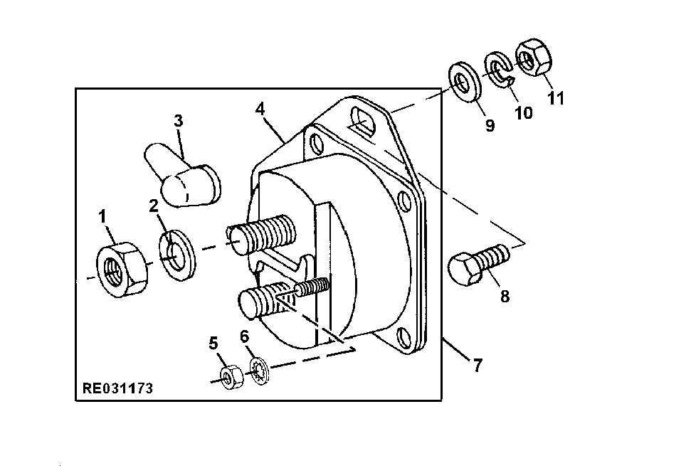

Hi all,
I tried this over on the Ford /NH board with no takers. Thought I might have some luck here. I'm continuing the reassembly of my F/NH 1715 (It's a 15 series 3 cylinder diesel 27hp 4X4) after a crazy few months with clutch replacement and came to the instrument panel wiring harness and noticed that a blue connector was just hanging loose. Odd thing was it had a jumper wire connected to one of the contacts, but just hanging loose on the other end. I apparently didn't notice it when disassembling as I only marked connections I removed. Anyway, after some investigating of the wiring diagram, I've identified it as the starter safety relay socket and the relay itself seems to have been removed from the instrument panel bracket. Since I'm no electronics expert and my ability to follow an electronic diagram accurately is not guaranteed, my question is this. Is this safety relay likely required for engine starting or will it just not prevent an engine start if the clutch is not pressed or the shifter not in neutral. Bottom line, is that jumper that has been jerry rigged necessary? Has it been starting fine since I owned it with the jumper disconnected or was one end most likely knocked out during the disassembly process. I'm assuming, since the connected end of the jumper goes to the keyed ignition switch, the other end was meant to attach to the starter pin of the socket. I'd appreciate any knowledge on this issue. Kind of don't want to spring for a new relay cause of the outrageous $$$, and the setup prior to the clutch job worked just fine for the 5 years I've owned this tractor. Thanks!
   / Need some input on a starter safety relay #2
I'm not familiar with your model tractor BUT on tractors that I'm familiar with the starter relay is designed to utilize a shorter length of wiring harness which gives starter engagement electricity a shorter path with less connections from battery to starter solenoid "S" terminal. This normally sends more amps down the start circuit to starter solenoid for better more reliable starter engagement. Utilizing a starter relay lowers the amount of amperage that otherwise would have to travel through ign & neutral start switches.You could substitute the factory relay for a generic type($25 or less) with minimal wiring alterations. I hope you're not more confused now than before.

Hey Tx, thanks for the input. I think I understand the concept you're getting at but not sure it applies in this case. I'll study the wiring diagram some more and see if I can make some sense out of it. Otherwise, I guess the best course of action would be try it first with the jumper not connected, if it dont work connect the jumper and see if that gets starter working. If that fails, I'll need to dig some more. Thanks again for your input!
