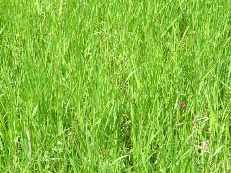

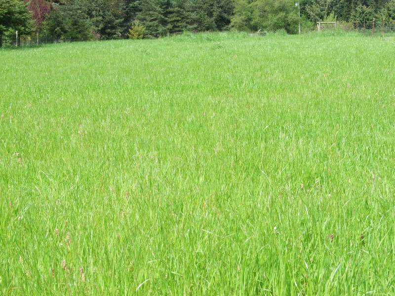

Not know where you are so this may apply or not.
I agree with other about the 15#/A guideline. Location and type of grass plays a big part.
I tilled my old pasture last fall and replanted. Applied 50# on about 2.75 - 3/A. I used a small broadcast spreader.
No fert applied and here is what it looks like now. In the one pic you can see how dense the growth looks. Maybe this can give you an idea on the planting rate.
