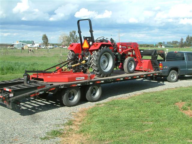

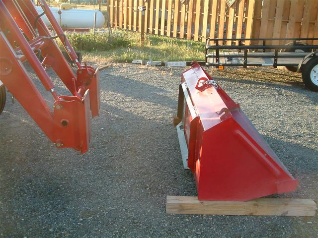

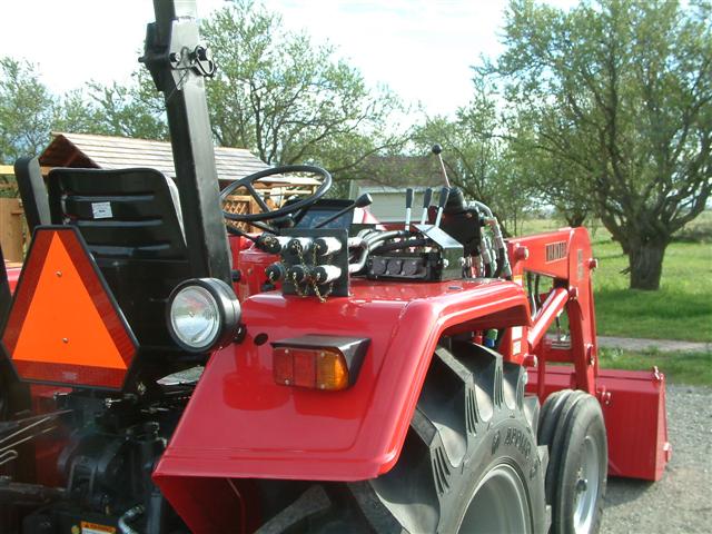

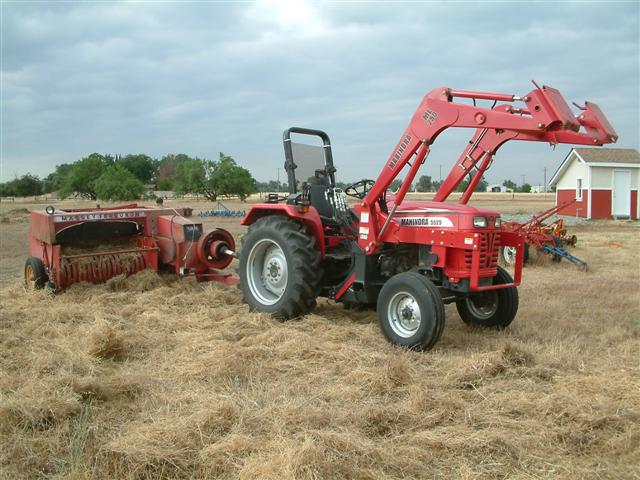

Identify nearby tractor dealers (within ~100 mile radius) and look at models in the 40-50 hp (pto) range. Get one with a front end loader (FEL) that has a 6-ft wide bucket and get the skid steer quick attach (SSQA) option for the loader. For example, mine is a 2008 Mahindra 5525 (54 hp engine, 45 hp pto, 2WD, power steering, gear tranny 8F/2R, triple rear hydraulic remotes) with the ML250 FEL (6-ft wide bucket, 2950 lb lift to 10.5 ft height, three chain hooks on the top edge of the bucket, SSQA). Cost: about $19K.
Something this size would handle your jobs.
Good luck.
