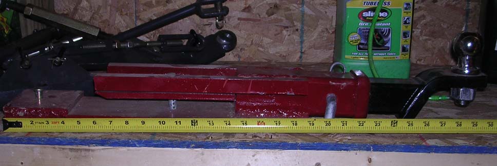

I think that's awesome! You should quickly patent that? Do you have approx. or actual dimensions? I like the visibility you have from the driver's seat AND the fact you can leave the hoe on the back. In order to get that visibility I can see where the length dimension is critical without making it stick out too far. Nice job!
   / Need Suggestions For Mounting 2" Ball / Receiver #8
Re: Need Suggestions For Mounting 2\" Ball / Receiver
I do have to tip the bucket up just a little to get the visibility. If the receiver tube is level I can't see it easily. I tip it up until I start to insert into the trailer, then level it out.
The overall length of the steel including the receiver tube is 22.5" (see attached photo). The bottom is 3/8" plate 4 or 4.5" wide. The top bars are 1"x1" steel stock that are 13" long, sticking out 8" past the end of the receiver tube. Note the horizontal gap between the top plate and the bottom plate -- this is critical to get around your cutting edge; without that gap, you would not be able to get it on and off (without leaving a lot of slop between the top and bottom plates). Happy welding...

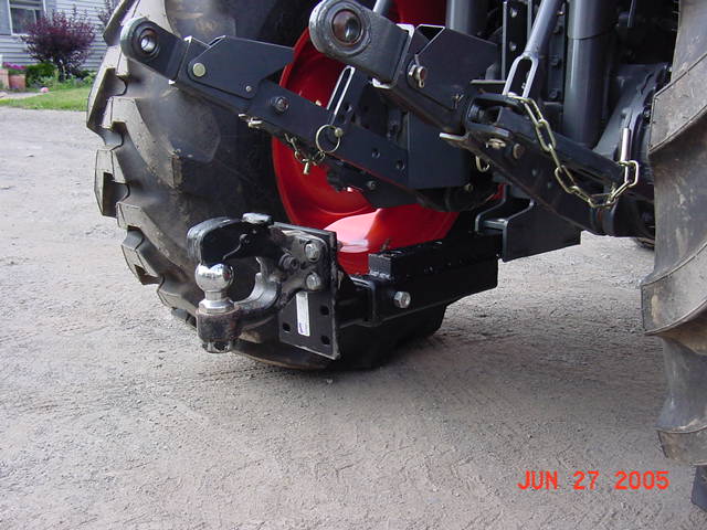

Here was my solution:

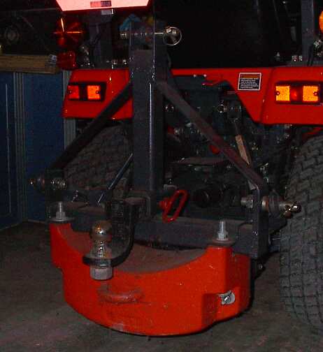

Attachment is combination 3PH 2" receiver & rear weight (~350#). Weight is an old front tractor weight.
