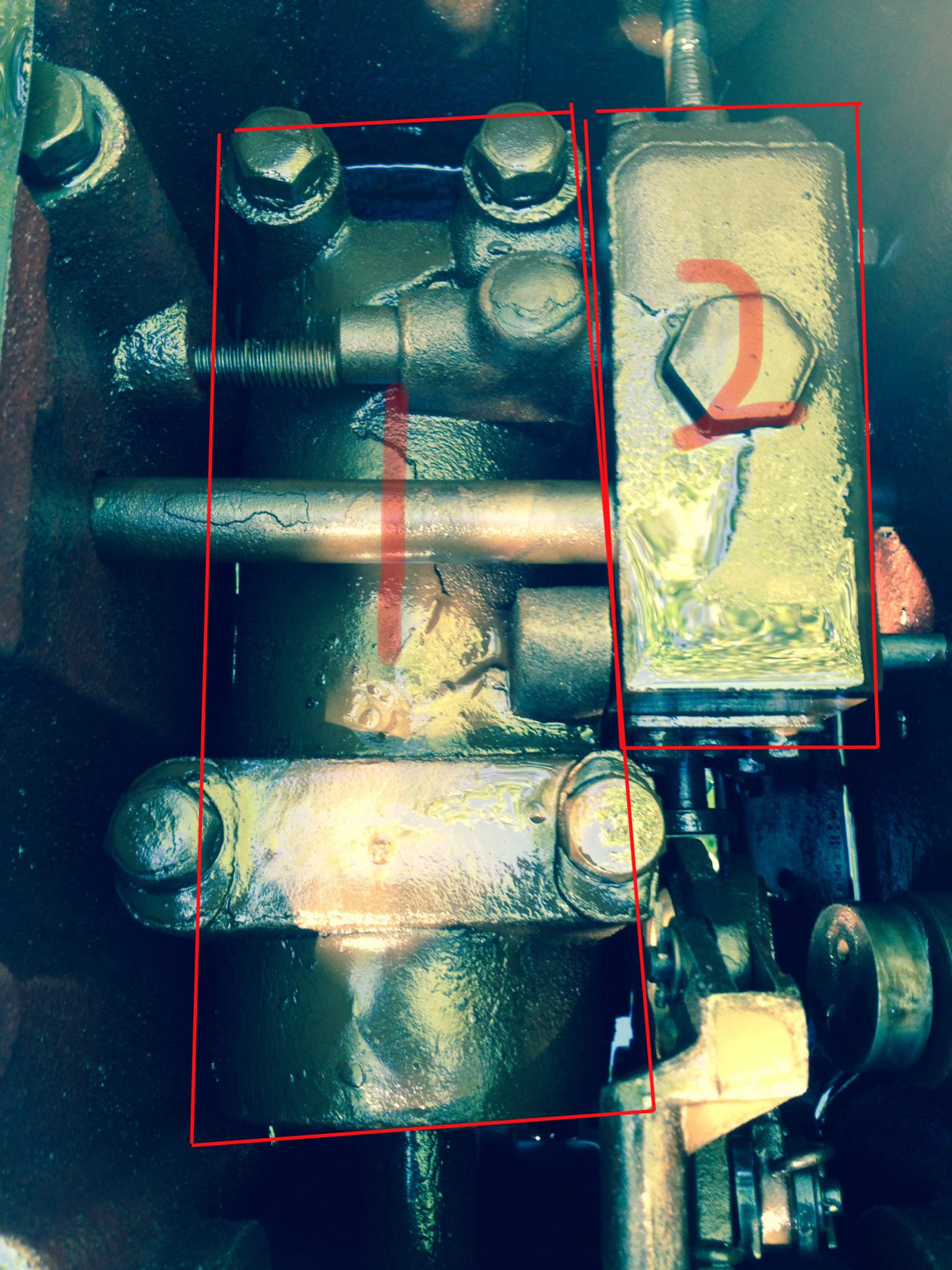

#2. anybody know where i can get one or confirmation on a saturday?

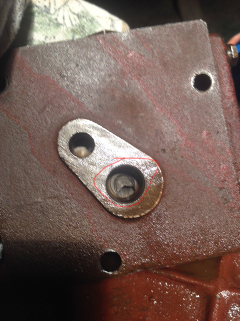

hey guys. without the manual.. this is from the sump. it most likely is considered the main valve. it controls the fluid to the rockshaft / return flow from rockshaft. thanks for the info i've been in touch with chip. . just weekends you know so curious to get info on it.. appears talking to a friend that this
circled part is ok.. thanks again.. hey by the way i wonder if you guys have any experience and may be able to check out this video i want to make sure its ok function-wise before completing reassembly..

I'm confused. The "rockshaft", in general parlance, is the shaft that the rocker arms ride on in the valve train assembly for the combustion chambers. Not sure what you are referring to in this case, can you be more specific? I can't understand what the relationship is between the combustion chambers and the lift box.
   / Need this part
someone had called this (#1) the rockshaft.. without a manual i see online that its called the rockshaft cylinder.
I was making the relationship between the rockshaft (cylinder) and the valve pictured below (#2) and how together they control the 3pt lift.
   / Need this part #7
Appears to be the valve assembly under the right floorboard (for lift and draft control). Don't know if the pieces can be purchase individually, or if it comes as an assembly. Chip will likely know.

A rockshaft is any shaft that doesn't turn 360 degrees. Like the big shaft that turns to lift the 3-pt arms.
