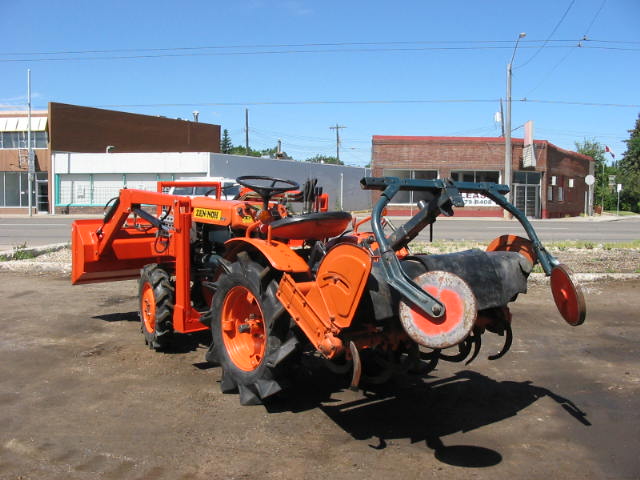

Zen-Noh (Kubota) B7000. Massey Ferguson MF35
I got a well used tiller with a small Kubota tractor. The only identifying label on the tiller that I can recognize is "S1000". The tiller is approximately 42" wide and looks like the tiller in the attached picture. I need six tines for this tiller. Help in identifying the tiller and sources for tines would be much appreciated.

Chances are the tines are not specific to the tiller.
Take one to a local implement dealer for measureing and they can look through the tine suppier books to find ones that fit.
I've done this only it was a local farm coop.

The gauge wheels on the rear don't really look like what I've typical of a Yanmar, could be though. I think it may be a grey Kubota tiller, since the tractor is labeled a Zen-Noh
   / need tines for unknown tiller #5
Are those gauge wheels or hillers?
Here's a post that may help with replacement tines.
LINK

I presume a "gauge wheel" would hold the associated implement a certain distance above the prevailing terrain. I do not know what a "hiller" is.
Thanks for the link.
   / need tines for unknown tiller #7
Cleancutter has a catalog with measurements of tiller blades they make. they may be able to help you.
