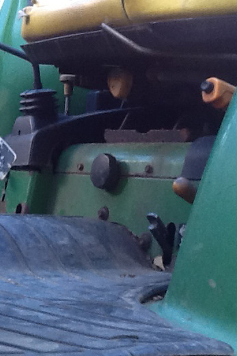

Greetings to the venerable John Deere tractor experts and gurus. I apologize if this has been covered in the past but my searches could not unveil the answer to this challenge.
I just became a first time tractor owner purchasing a used 4200 TLB with about 1030 hours. It came from a Portland electric utility company and apparently the Deere 47 backhoe had never been removed. I also picked up a Bush Hog and rollover box blade but I am unable to remove the backhoe to try them out. I went over the instructions carefully but the rockshaft will not move. I have tried adjusting the drop speed valve under the seat but to no avail. When I move the rockshaft control lever nothing happens and I don't hear any noise like you would expect from applying a load on the pump or the relief valve. I pulled off the seat to check the linkage to the rockshaft control arm and the drop valve and all seems intact and functioning. There are some light hammer marks on one side of the curved stop plate at the end of the control shaft as if someone had banged on it a few times to loosen something up. Is it possible that there is a valve or internal linkage that is stuck? If that is all it were I would thnk I could hear something going on with the hydraulic pump. Power seems good except with backhoe but that is probably not related and should be good for another post.

You may have to disconnect the backhoe hydraulics and open the valve behind your right foot.:)
Thanks Egon but not sure I understand what "open the valve behind your right foot" means? I have tried disconnecting the backhoe and hooking up the Power Beyond line several times to make sure I have a positive connection.

Black knob in the middle. With backhoe on it should be closed. Backhoe off open. :)
