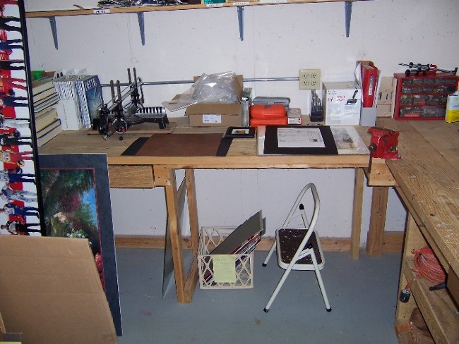

Sounds like you're wanting to build something out of metal and wood.
My workbench is made out of 2X4's and 2X10's and is the most sturdy workbench I've ever had. I used the 2X10's for the top instead of plywood because I like to be able to screw right into it if I need to hold something in place. The construction is pretty basic, but it's held up well over the years.
Here's a picture of part of the bench.
   / need workbench ideas/pictures/plans #4
You can see that I built it in an "L" shape. The leg on the right in the first picture is about 90" long.

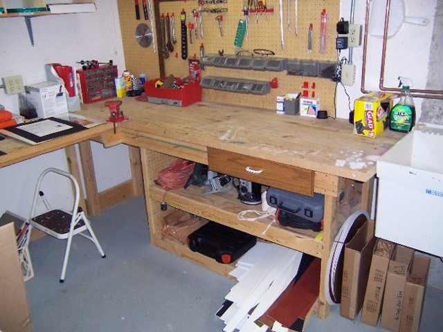

Here's a picture of the left side, which is about 80" long.

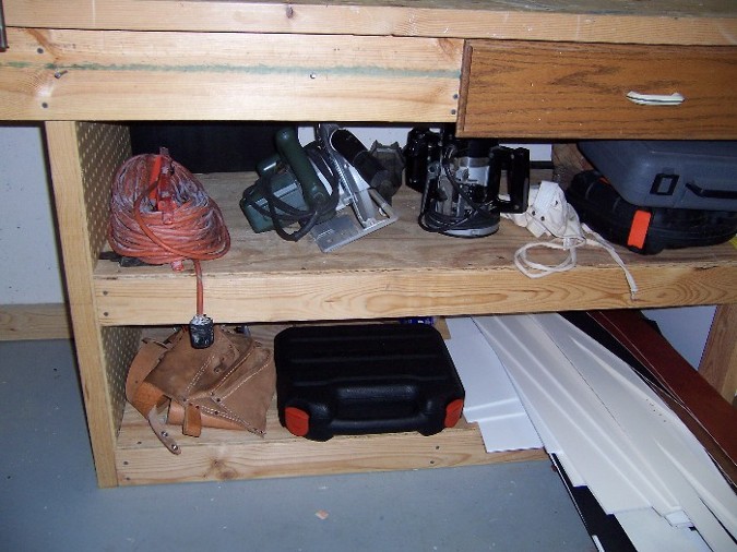

I added a couple of shelves under the right leg, and even threw in a used drawer I had laying around.

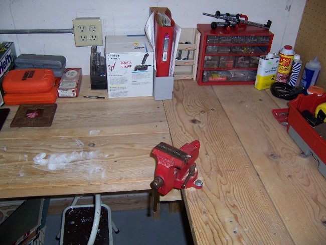

Here's the last picture. This shows a closer look at where the two legs meet.
