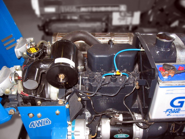

Needs pics of wires on G174 starter PLEASE

I forgot how they attach. Thanks!

How many wires do you have 2 or 3?
   / Needs pics of wires on G174 starter PLEASE
One from battery, one from alt and I think one from ignition.
   / Needs pics of wires on G174 starter PLEASE #4
This is the only picture I have handy. The alternator and battery + go on the larger terminal together on the solenoid. The smaller wire coming from the start switch is a spade female and can only go in one spot on the solenoid (the thing above the starter motor).
