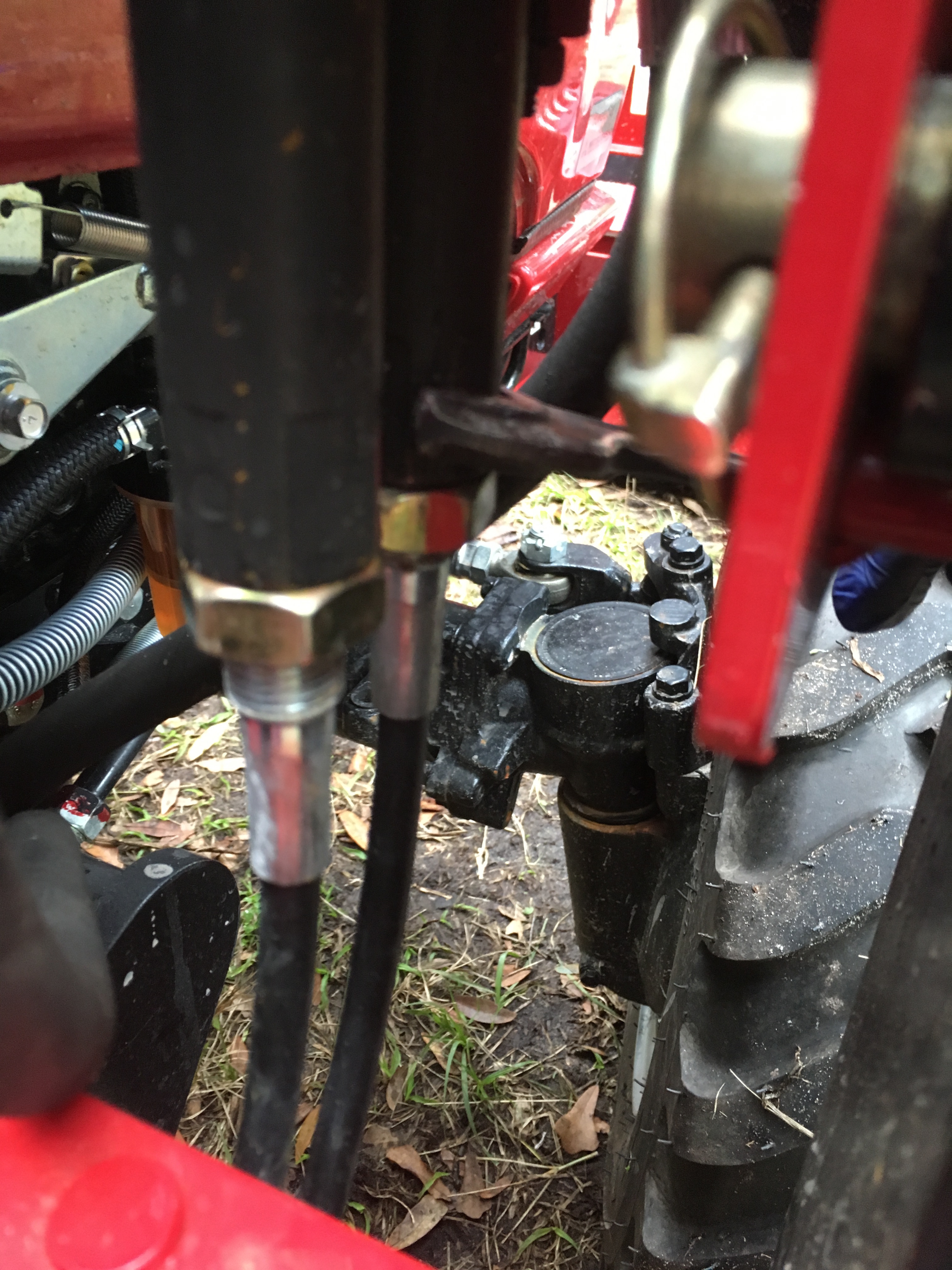

Spent some time on the loader control valve - thanks to 1st Tractor for the hints. Got both float and fast dump working by adjusting the cables
There are two adjustment points - one below the control, and one where they attach to the valve body.
You can see how the cables just hang below the floor board here:
attachment.php
The adjustment under the handle just moved the center of the stick left/right forward/rearward. I wasn't able to regain the float or fast dump with these. You'll need a 24mm and a 12mm wrench for this.
The adjustment at the valve body did a lot better - I rotated the black section (you'll need two 24mm for this, one for the black section and one for the nut) while holding the cable end with a plier. The direct that worked for me was to "shorten" the visible threaded part of the cable. Everything is updownside here, so that was the easiest way to describe it. The front cable (front is front) was the up/down control, and the rear was the curl control. A few turns in and I started to feel the float click into place - a few more and I got full engagement and it would stay. Similar with the fast dump - I went from not feeling the extra spring (curl down, handle to the right) at the full movement to starting to feel it, then full travel.
Adjusting these -also- moved the control handle center point. Neither of these tightened up the "loose" center feeling. I ended up adjusting the center off-center a bit to put it in a better position for my hand and for ease of in/out on the right side. I had to make a guess about correct adjustment - I suspect it's definitely possible to over adjust this and not get complete travel..... obviously there's nothing mentioned in the owners manual for the loader.

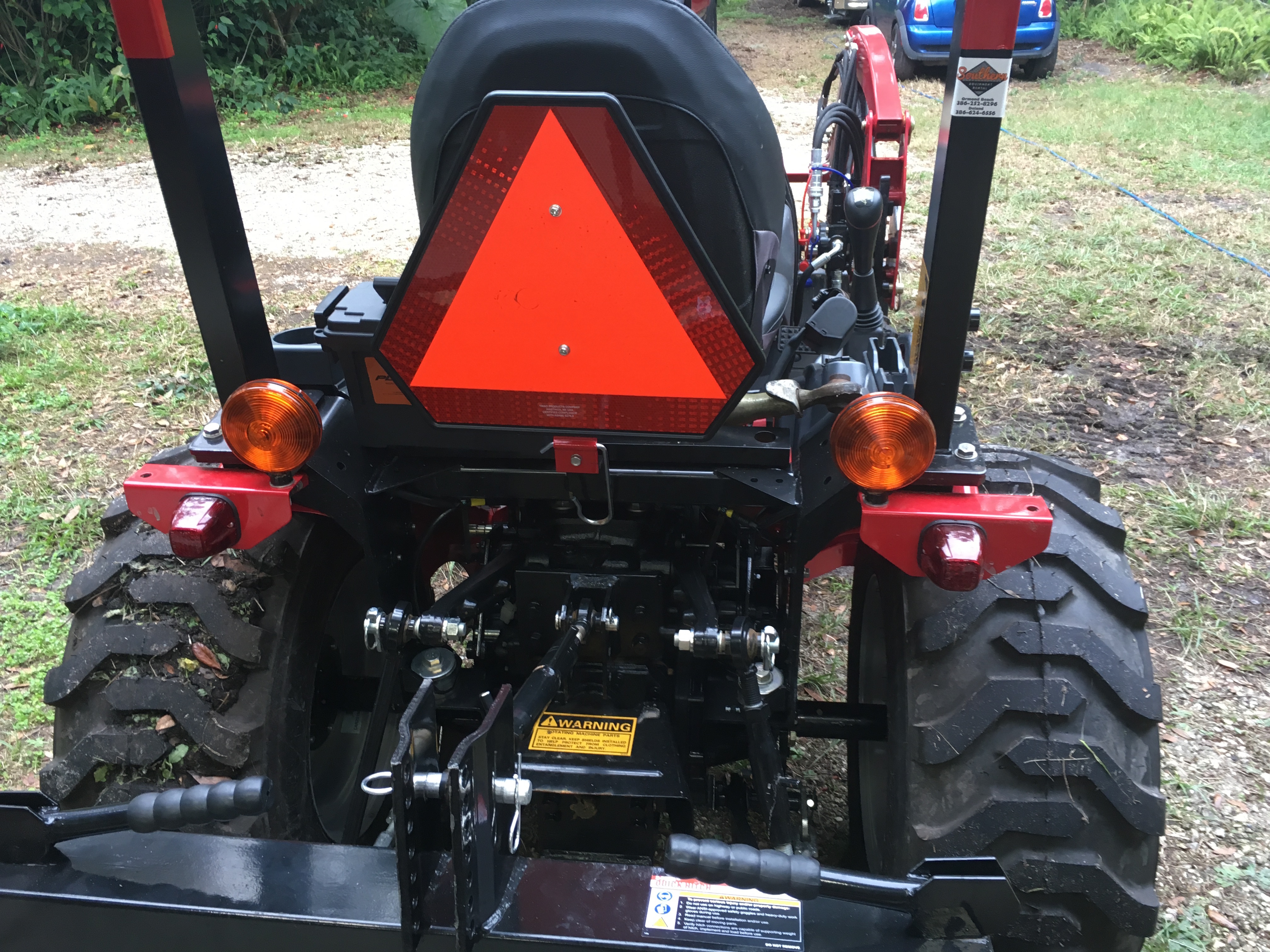

I also moved the flasher lights to the inboard mounting holes - these were going to be the first thing I removed since they lasted about 2 days on the old tractor....but my wife pointed out the inboard holes, and they're less likely to get taken off by a branch this way.
