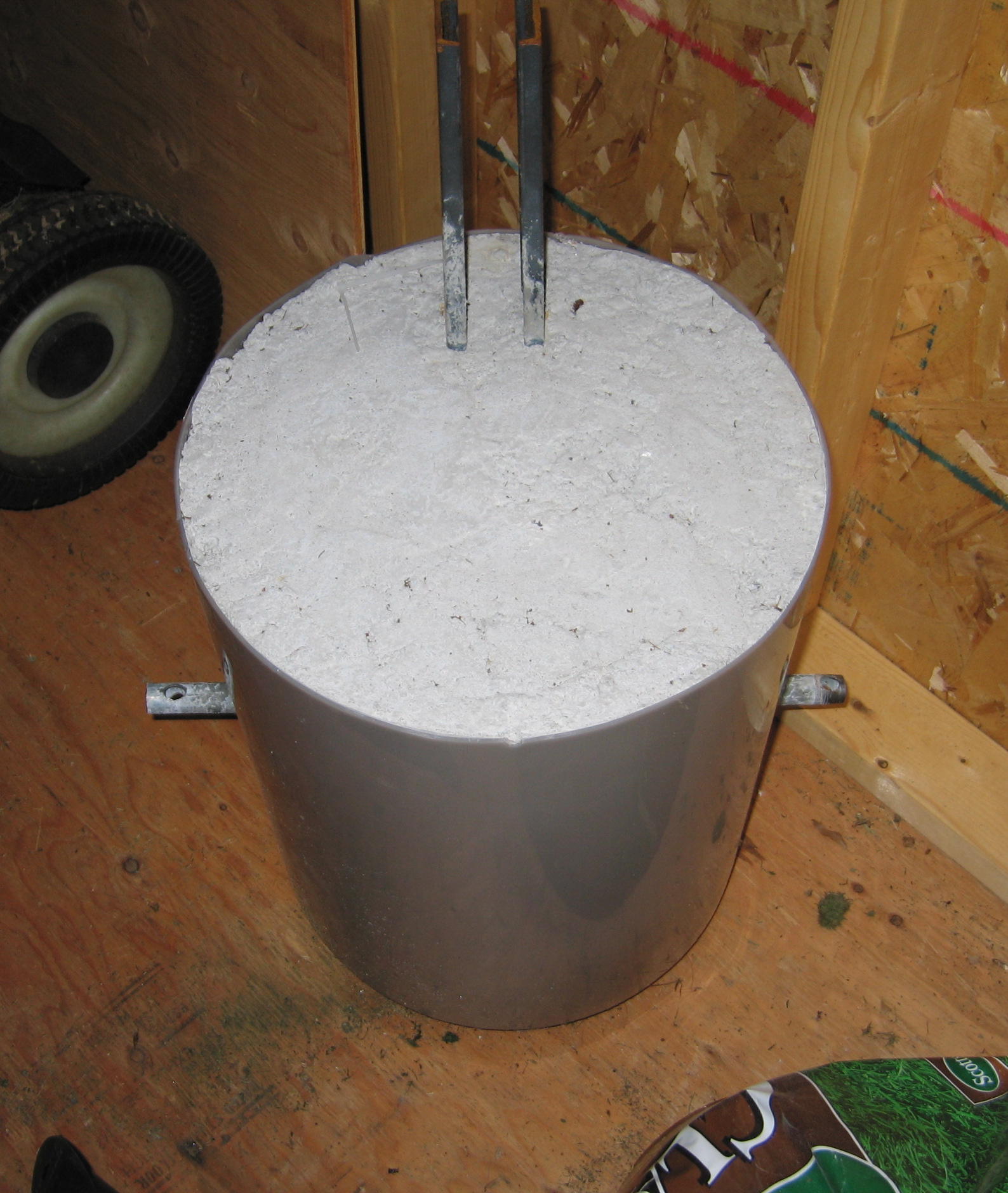

I added about 240lbs real easy and real cheap to rear wheels. went to local homer depot and bought a 35 gal trash can 3 bags of crete and a steel conduit long enough to get through barrel (35 gal can) and a c channel piece of steel.. drilled 2 holes for conduit at right height for 3 pt hitch lift arms with holes in the steel for a clevis pin. filled barrle with crete, with c channel mounted to pick up 3rd arm holes pre dilled. cheap like real cheap and we are talking 240 lbs counter weight. pics can be added if needed..
Thanks for the reply can you post the pics

Here is a pic

Fireguy; Did that give you enough counter weight to really load the front bucket?
