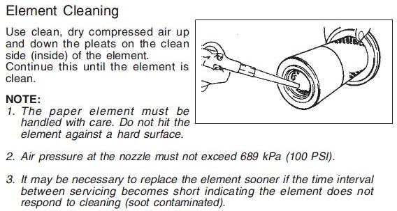

Howdy, I just got a new 2816 myself, 10 hard hours of work she's given. Nice to have others to compare notes with. I recently removed and inspected my air filter as my first day of box blading was dusty. It comes out easily when you unclasp the side panel. Wish I had carried compressed air with me. See pic.

I wouldnt change that air filter so soon. I just take mine out bump it off or spray it with air and put it back in. Mine still looks almost new @ 110 hours. Doesnt the manual say replace every 250 hrs?
