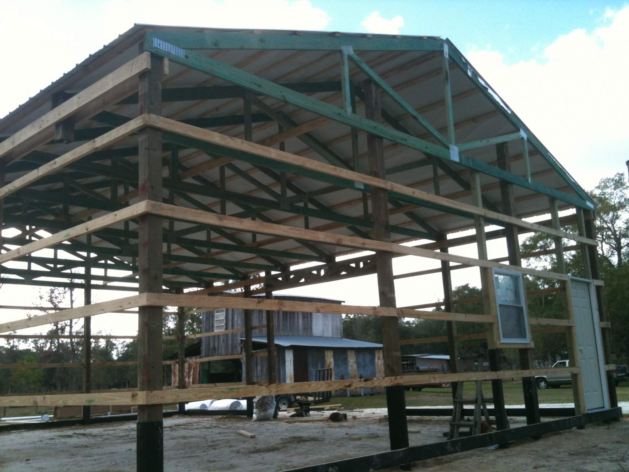

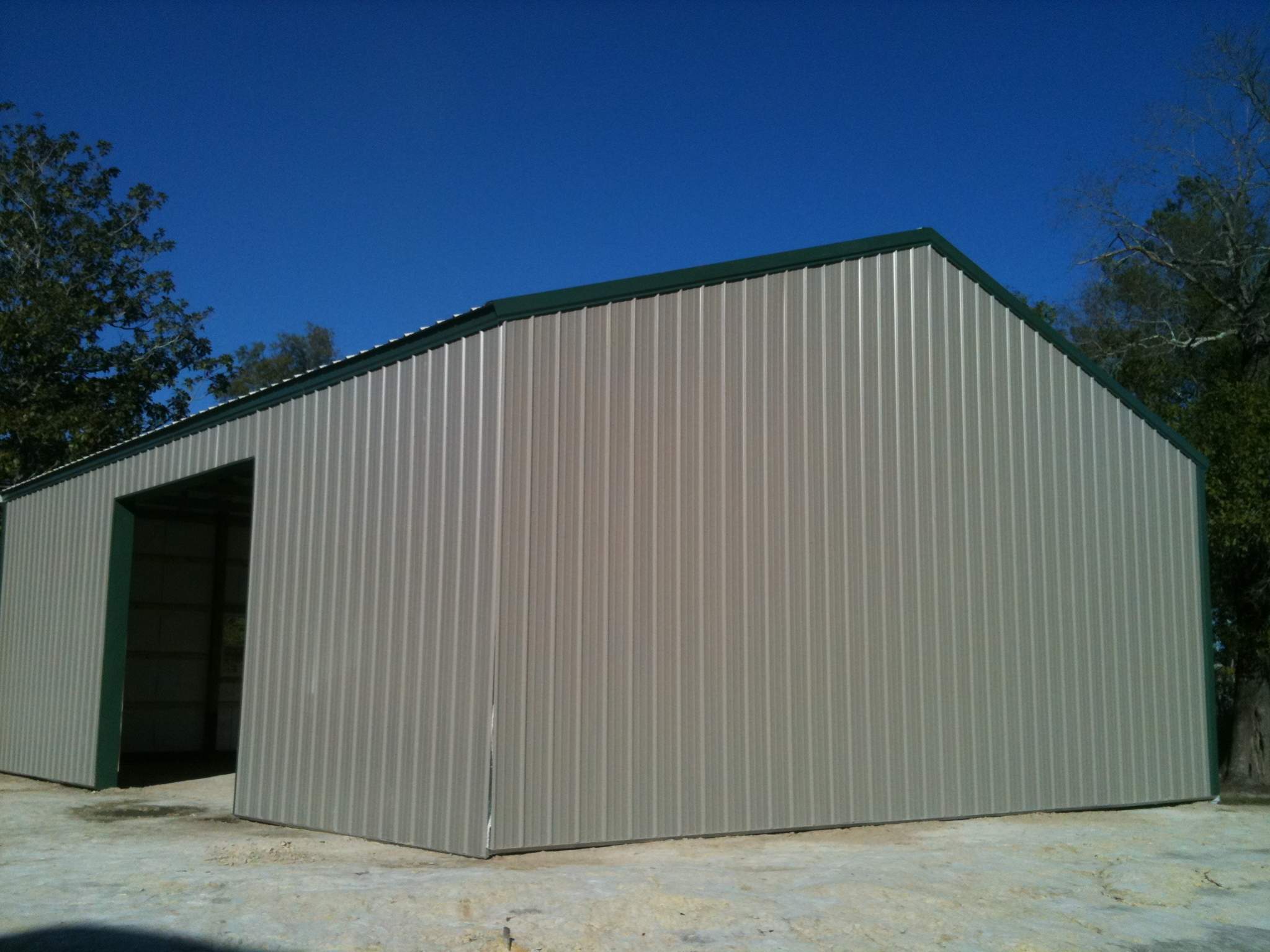

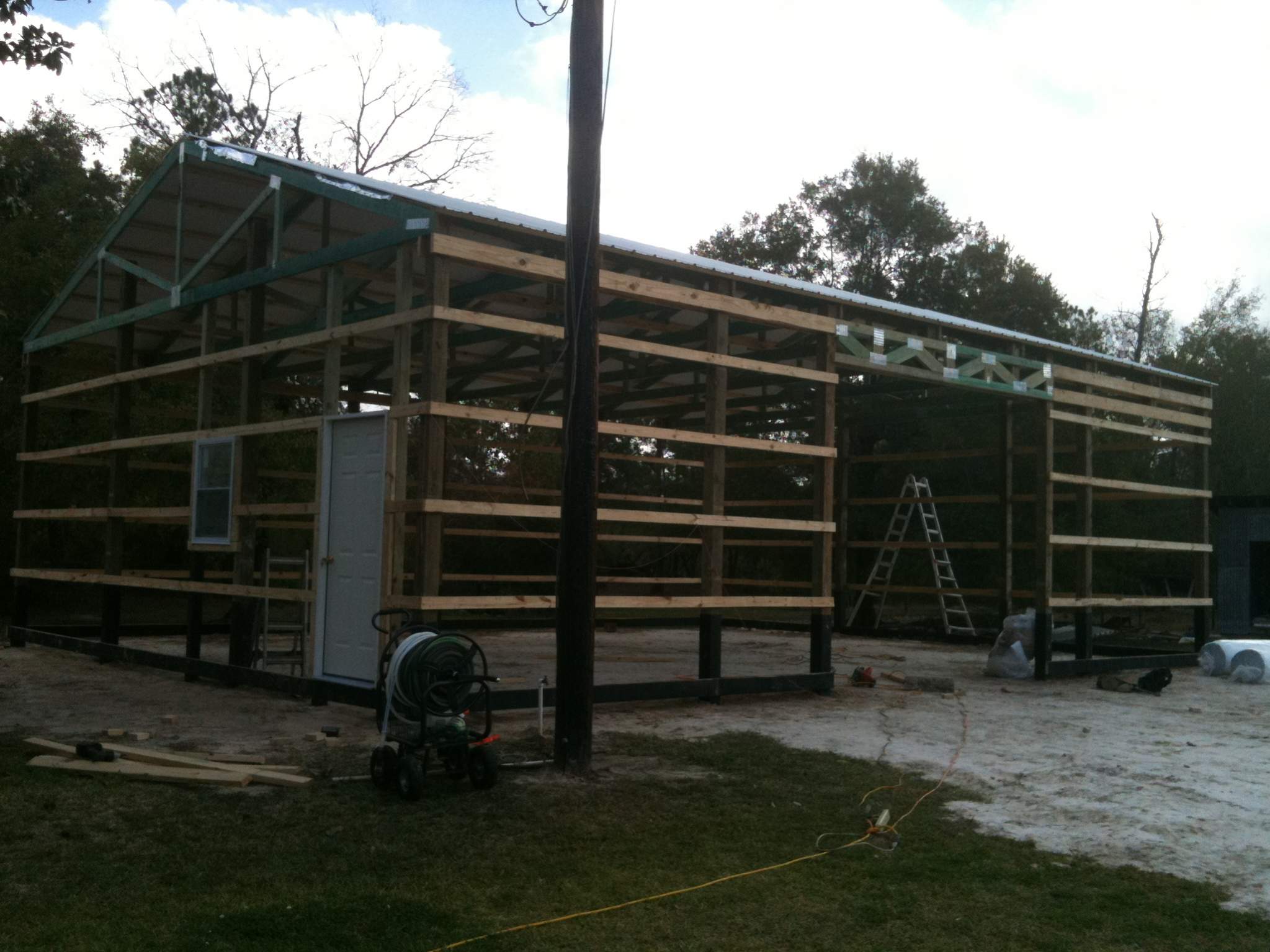

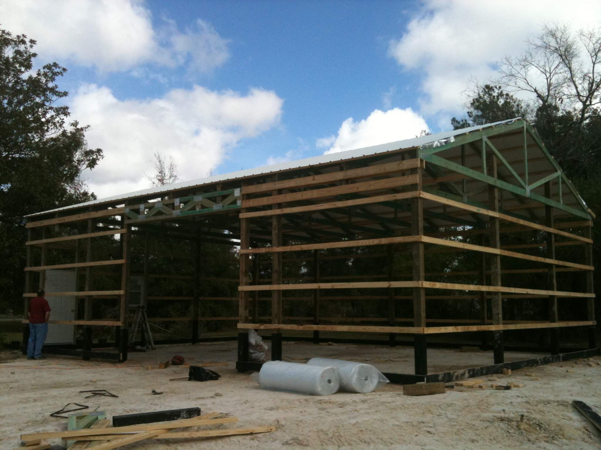

Thanks to all of the previous pole barn posts, I finally got all the information I needed to get started with my pole barn project. I got quotes from all over, but decided on a local company, Mallett Buildings in Iowa, Louisiana. They beat every other quote I had gotten plus they are local which I think is important. The building will be mainly used for tractor and implement storage. I ended up with a 30' x 40' x 12' with 1 walk in door and a 10' high x 12' wide sliding door. I am also getting post protectors, vinyl wrapped skirt board, insulation, rat guard, 1 window and a slab. For now there won't be any electricity, water or sewer, but electricity may be added in the future. Here are a few pictures. I know the posts are useless without pictures! In the background you can see the sad old barn this is meant to replace. Termites have made that one a lost cause.

Sharp looking barn. Looks like a pro build job to me. Its amazing how much bigger a barn looks with tall walls compared to ones with shorter walls.
   / New 30' x 40' x 12' Pole Barn
I know what you mean. When they got the poles up and I walked in, it looked huge! The footprint was pretty much what i had imagined, but it seemed really tall. So far it does look like they are doing a great job. I don't anticipate any problems.

It looks like you built the area up with sand? Is that correct?

wedge40, It's not sand, it is 60/40 fill material. I built the area up about 2 to 2.5 feet. The previous owner had a shed here but it was torn up pretty bad in hurricnae Rita. I demolished it and started building the area up to match what he had done before.
I'm not only amazed at how fast these guys work, but how they put up the trusses with two guys and no crane! I was at work and I didn't get to see it, but I am asking them how they did it when they come back after the holidays.

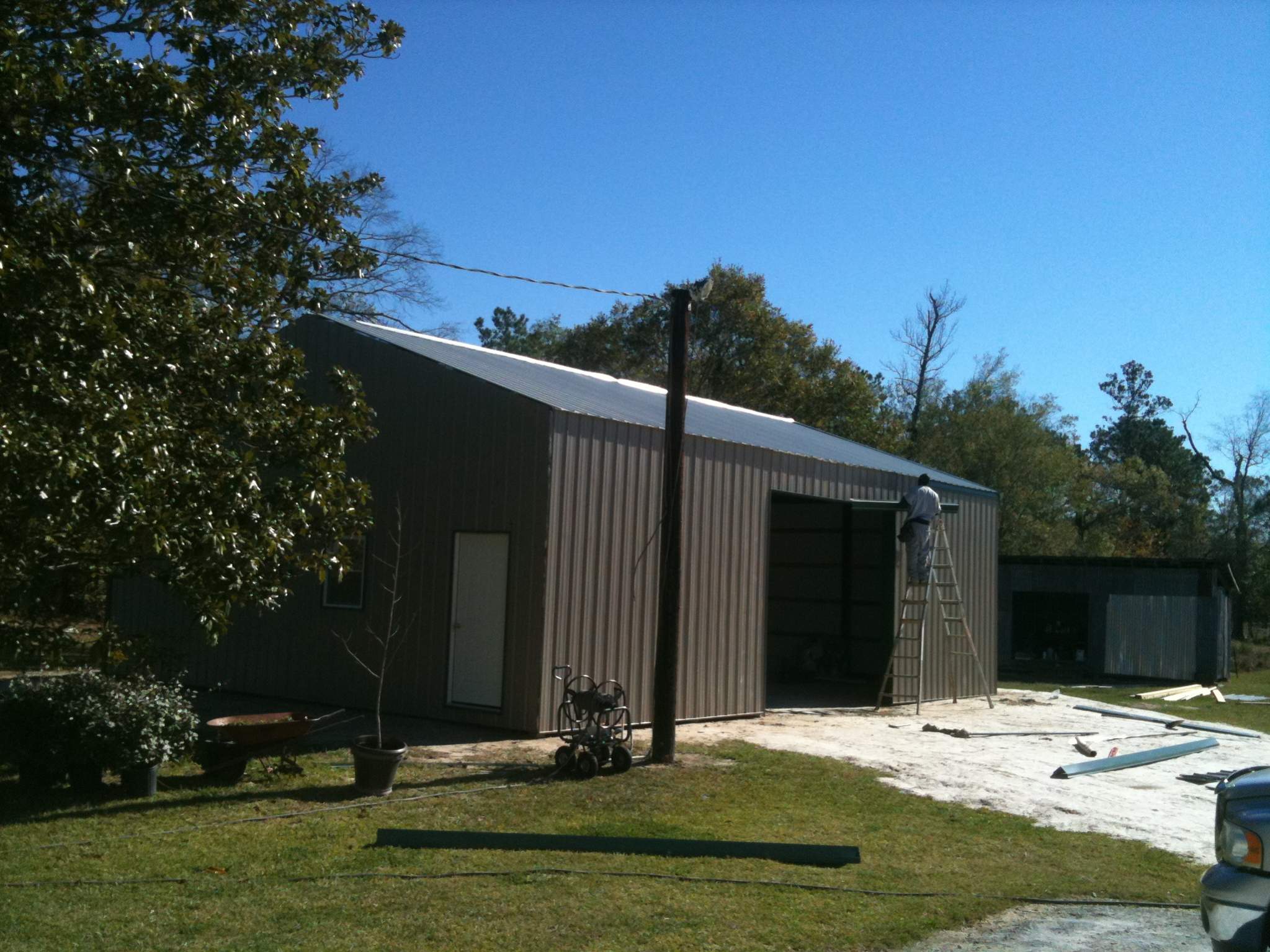

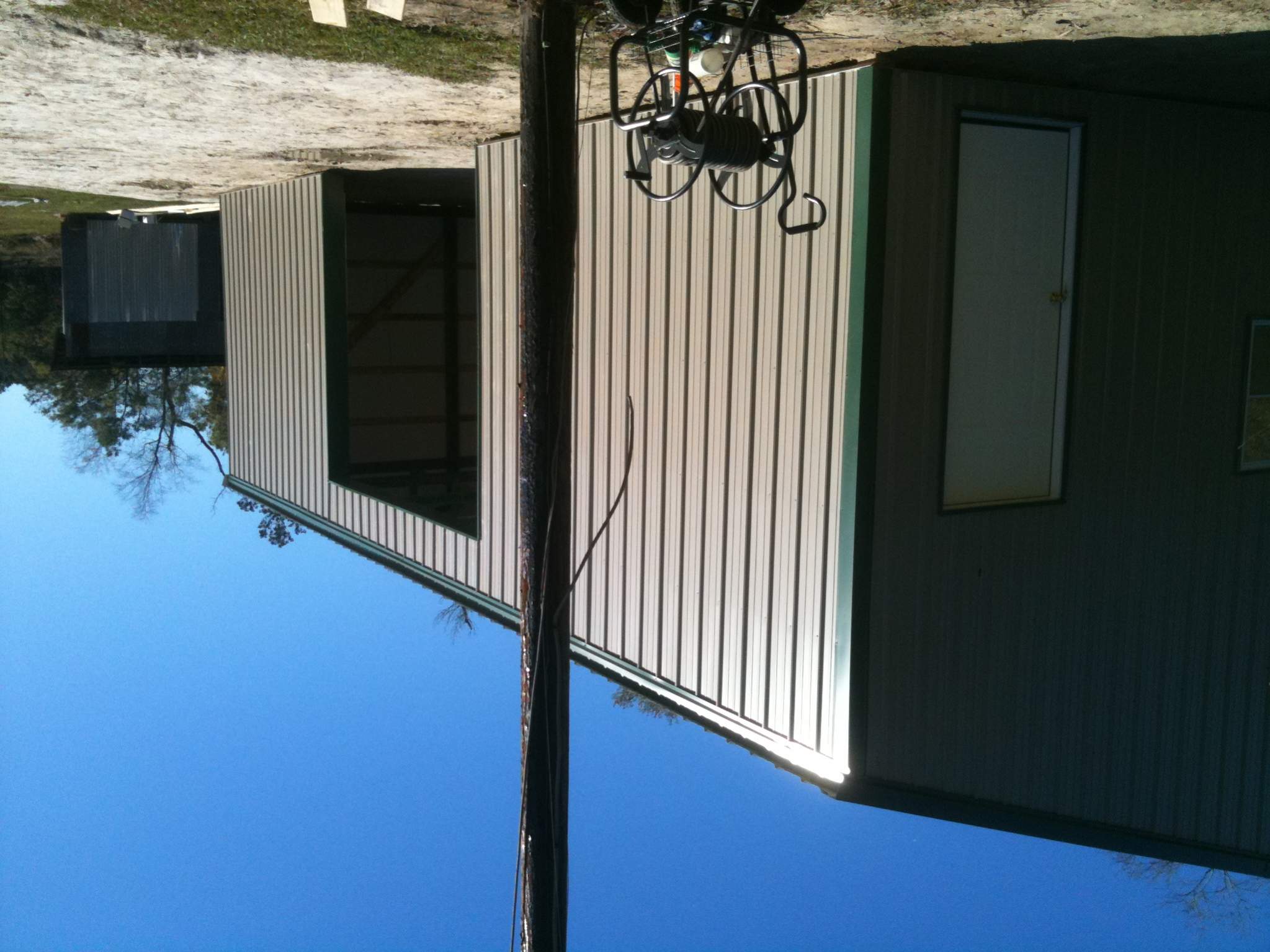

Finally had time for some more pictures. Got sand delivered today for the slab. Door tracks & trim should be in next week and hopefully they can get the slab done then as well.
