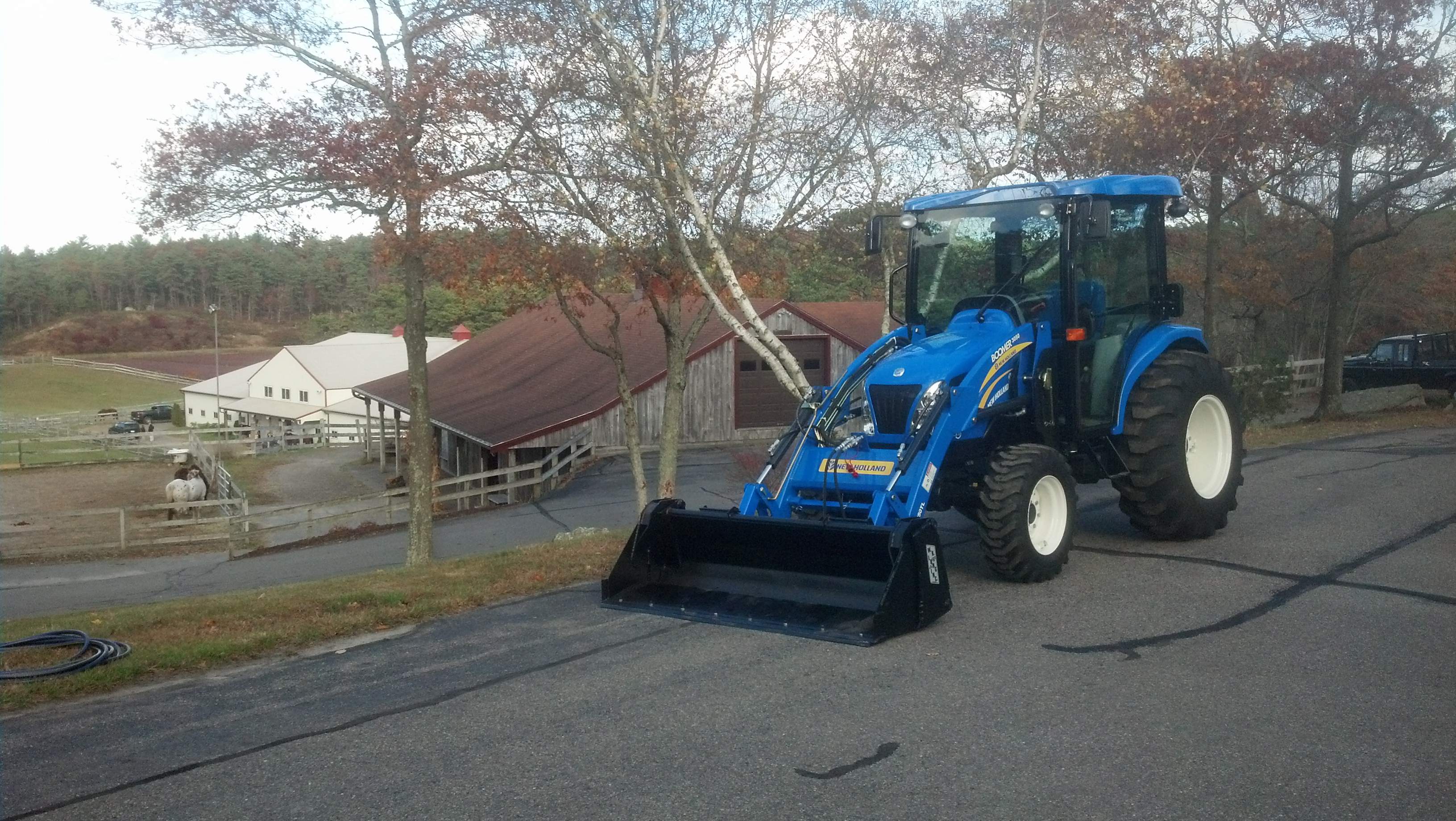

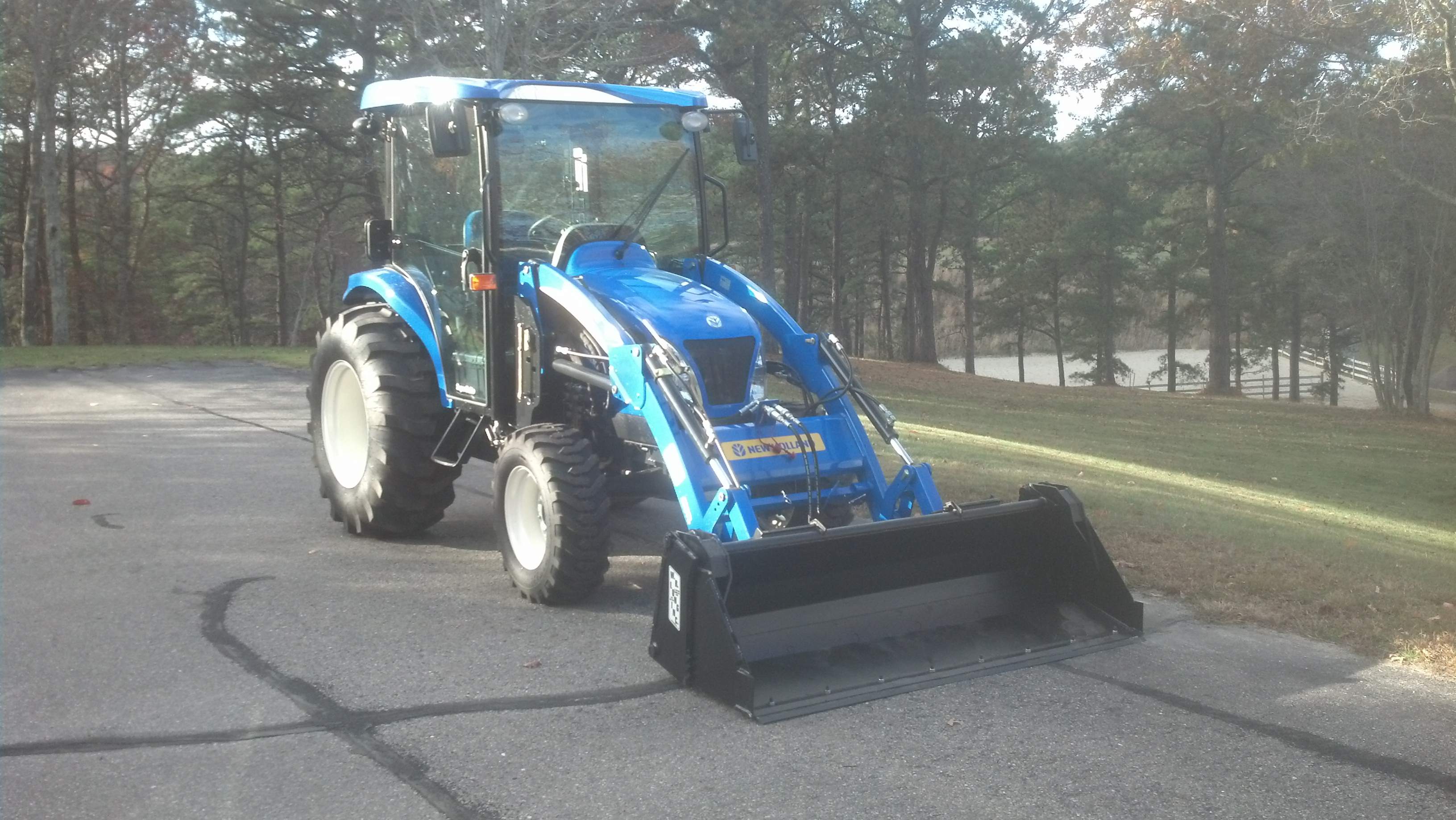

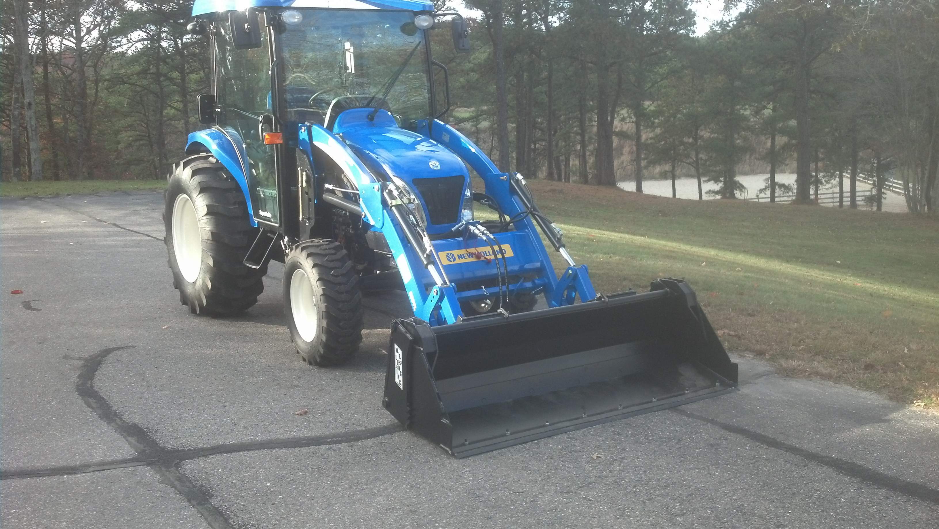

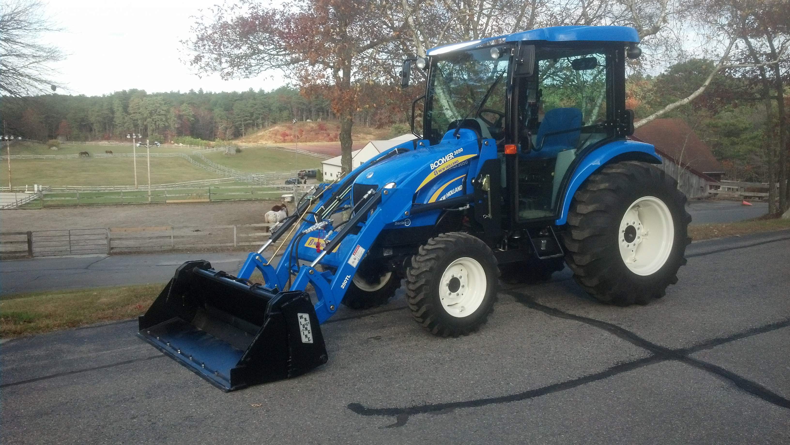

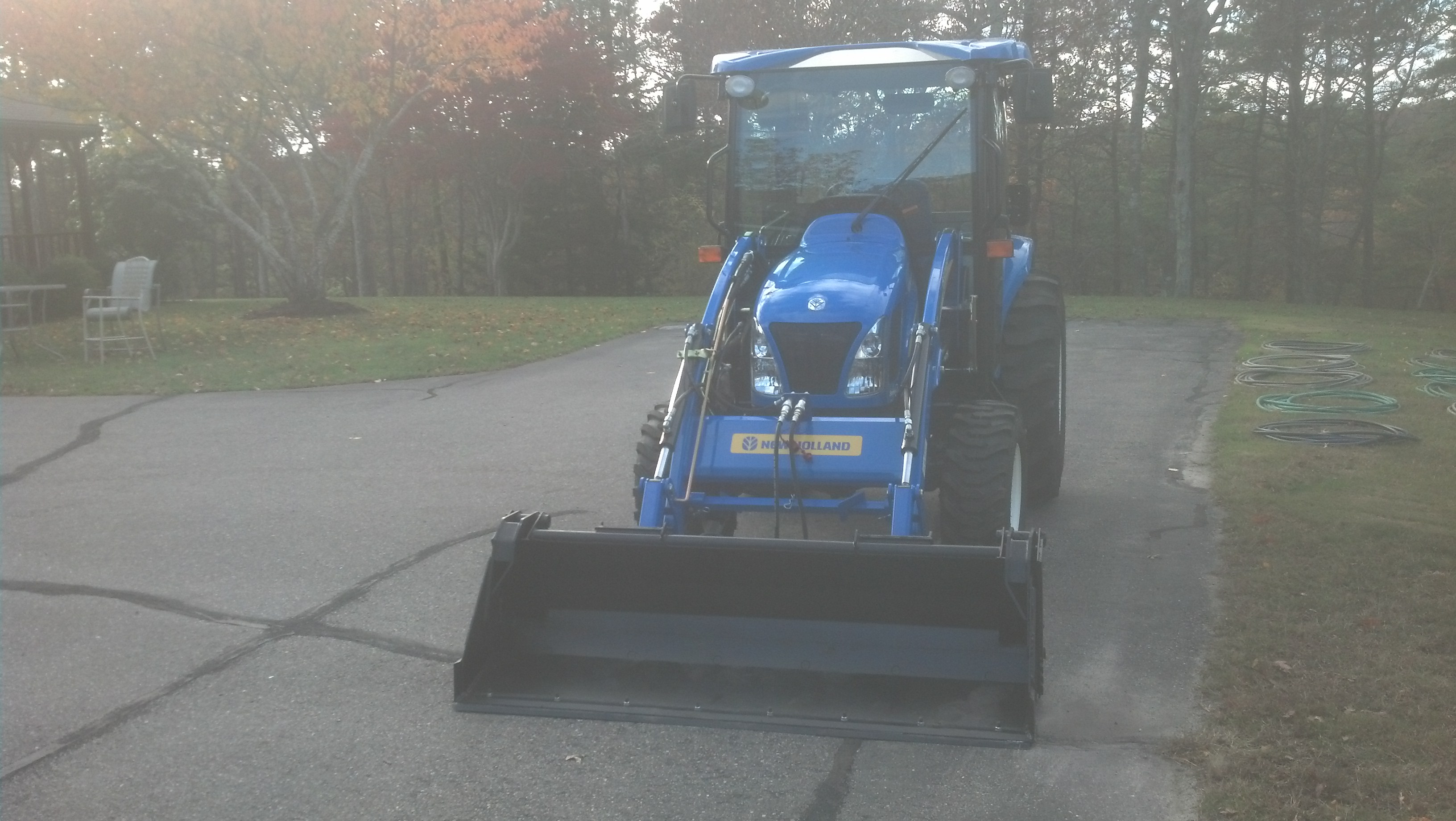

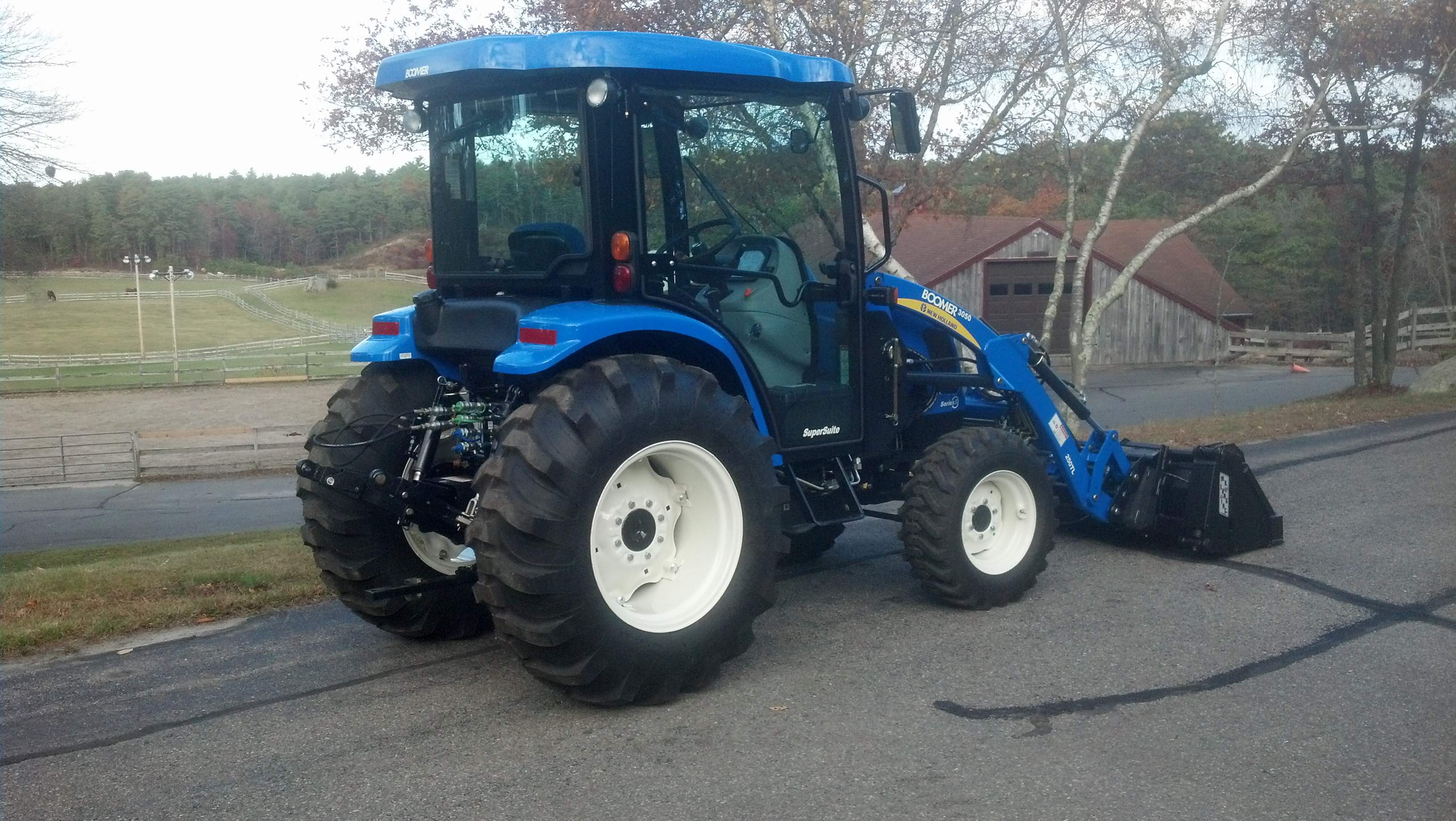

Here are some pictures of our new 2013 3050 CVT "with all the whistles and bells" as Jim said. Sorry it took so long to get them up. It arrived last Wednesday less the long 4 in 1 bucket which was delivered direct to us the next day because of a manufacturing delay. So I figured I'd wait until we had the bucket hooked up to take pictures. Jim the cab is a lot quieter than the Curtis cab on the TC45DA HST you can actually hear the radio with out blasting it and the visibility is great. The rest of the creature comforts are great also- heater and AC Bluetooth radio (auto connects to my phone)plenty of outside work lighting. Only misgivings about the cab so far are no convenient grab rail for climbing in and there is no illumination for the switches for night work but once I learn/remember their use and location that shouldn't be a problem. The tractor is definitely different operating than the TC45DA HST but I'm getting the hang of it. The biggest changes are not using my right foot for forward/reverse, the parking brake is on the right now and learning the deluxe CVT transmission operation. The engine is an updated version of the one in the 2012 TC45DA with the oil fill down on the side so you don't have to worry about the oil hydro lock problem when filling from the top. The engine compartment is packed though with the AC lines hydraulic lines etc. It's so tight I think I'll be disconnecting the loader to service it, as the oil and fuel filters will be hard to get to without disconnecting it. The oil dip stick is also real difficult to get to, so I plan on modifying it some how. I've been using a long pair of needle nose to get to it. Anyone come up with a work around for this yet?
Overall after 12 hrs of use so far I am pleased with the tractor and hopefully it will give us many years of reliable service like the TC45DA did. Now if I could just stop trying to back up with that right pedal that isn't there anymore.:laughing:

Jack, I have the exact unit you have (Shibaura engine) now with 50 hours, and it is a great tractor with a few minor inconveniences. Just did my first oil, oil filter change but have not figured out how to get to the fuel filter though I have many tools for the job. Just no room to get at the ring. One of the great things I like about the CVT transmission is that you can set the engine speed manually depending on the job with the manual throttle, then determine forward speed with the foot pedal. Great for backing up while shredding without the cutter speed decreasing. Having said that, the cup holder stinks and I've had two different travel Mugs with hot coffee bounce out and onto the floor, the ignition key slot could be positioned in a more convenient place (Especially in the dark) and..... The windshield wiper needs a "intermittent" position for fog or light rain.
PS- I love the deep buckets on the NH FEL. We have a JD about the same HP as the NH and the JD bucket is way too wide and shallow. I can move almost twice the volume of soil with the NH over the JD In the same time period. Not putting down JD, just prefer the NH set up.
