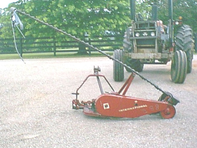

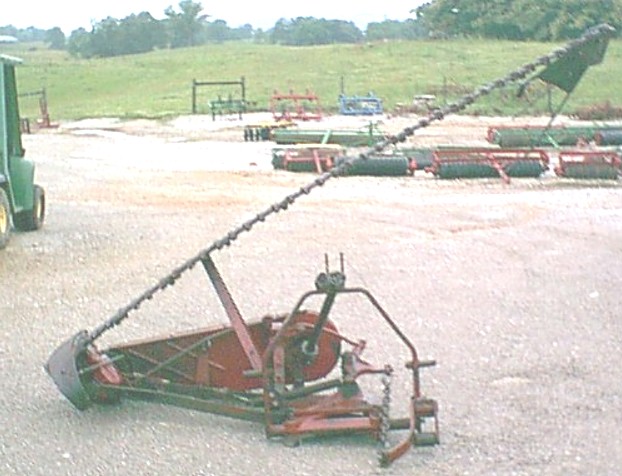

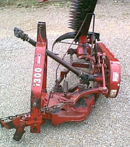

Here is the answer to your problem. A International #1300 beltdrive (same as Ford 505) with 9 ft sickle bar at $1750 + maybe $150 shipping to a business in IL. Wiil cut just like it is laying in the picture or 70 degrees below horizontal. Ken Sweet
