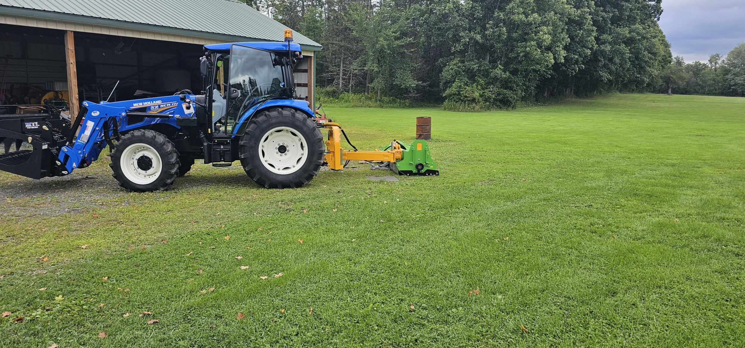

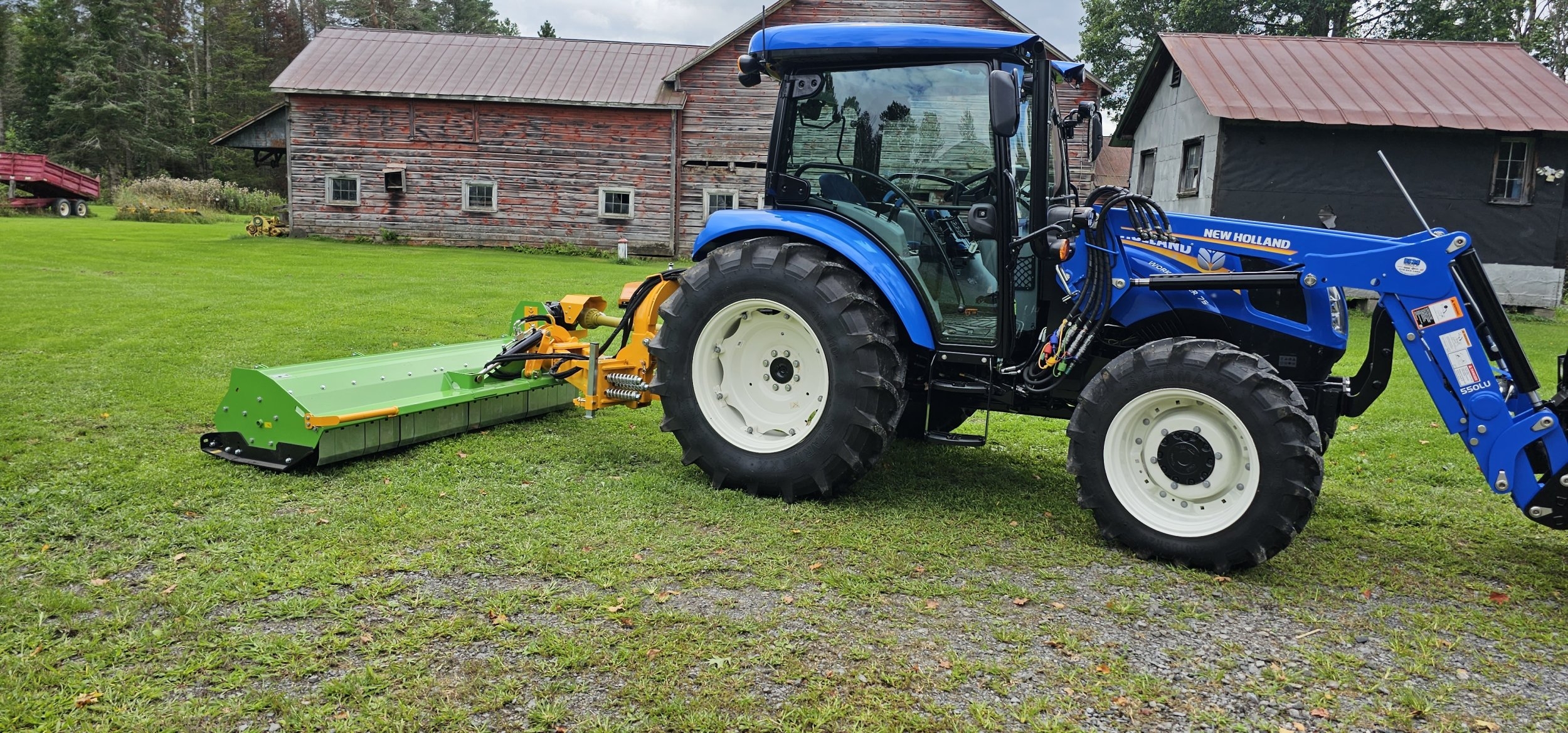

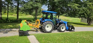

After spending years looking for a good offset flail And not wanting to spend 12 to 14,000 upwards of even 18 Grand to mow a few ditches on the farm decided to give the Chinese a shake. Victory tractor free shipping delivered to the farm for less than $5,200 I've got to say quite impressed incredibly balanced machine excellent powder coating bushings grease fittings and a substantial drive line with five belts Hammer blades takes down 3 to 2 in saplings and overhanging tree limbs like they're not even there. It's a little bit of work to put it together about 2 hours but considering my dealer is quoting me something like nearly 12,000 for a machine that looked half as well built it is quite impressive in the long term we'll have to see how it lasts but even some of the parts like bearings can easily be replaced with better grade overall I give it a 8 out of 10 wasn't expecting the best but it pleasantly surprised me I'll post more updates as I use it of course it's been raining Non-Stop

Forgot to mention weighs about 2,100 lb very heavy glad I have the tires loaded and definitely leave the grapple on the front at about a thousand pounds gets a little sketchy going from the center of the tractor 11 ft out quite a bit of reach it's quite amazing the Gearhead sits at the very edge of the machine so it gives you that extension as I said I'll post more pictures it definitely will run better on the bigger 95 horsepower tractors but the workmaster seems to handle it quite well not a horsepower issue just a weight issue perhaps putting some side weights on the tires or counterbalancing the arms will definitely help. Also I added an extra lift cylinder to the one right arm which definitely helps compensate for all the weight going to the right of the tractor facing forward of course take care

What's really impressive is regardless of how far out you set it there is absolutely zero vibration it is absolutely balanced within grams I've never seen anything like it I wish my new woods mower would run this good it's incredible I even demoed some Italian flails and they had 10 times the vibration especially standing them up at a 90° angle mowing hedgerows on the farm

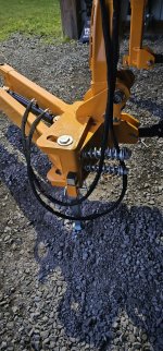

Here's a side shot before the Gearhead was installed all the way to the left running on five belts surprisingly good quality
