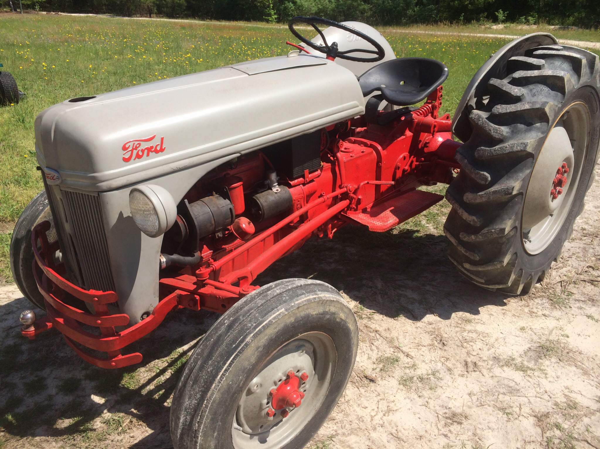

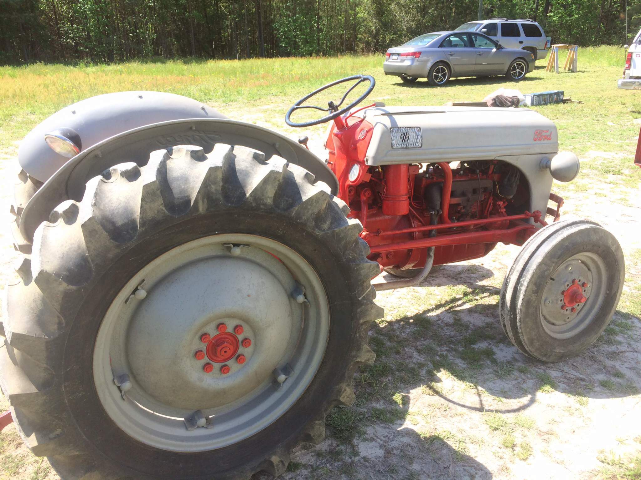

Hello to all! I just recently purchased my first tractor, I believe it is a '52 8N, but I have not been able to decipher the s/n just yet. However I do know it is a later 8n with the proof meter and side distributor etc. I bought it off a little old man that finds old tractors, cars, trucks, etc. and brings them back to life and sells them(he had a really cool old 1920's dodge brothers car) I had planned on buying the tractor as nothing more than a work tractor for various jobs such as working my dirt driveway, bush hogging, and maybe some light garden work, with the attitude of if it works don't fix it. The more I tinker with it though, the more I like it and want to start tackling every little thing I come across. I can't afford a complete overhaul/rebuild right now, but maybe sometime in the future :D . What I know so far: be PO said he replaced the rings and valves because of low compression/smoking bad, and new fluids. What I have done so far: changed plugs auto lite 437, plug wires(TSC ford) distributor cap( old one was cracked) new fuel screens( sediment bowl, elbow to carb) cleaned out and rebuilt carb(full rebuild kit). Have the points, condenser, and rotor to replace but haven't quite gotten there yet. Waiting on a wiring harness(currently a hodgepodge of random wires even speaker wire, and stranded residential type wire) manifold gasket and proof meter cable from just8ns, hopefully will be in this week and I can see if the meter works.
I have only put about 6 hours on it so far using a borrowed box blade with teeth to rip up the ruts and pot holes in my driveway, which was a lot of fun by the way :D . (I did manage to rip up my internet cable btw, I told the installers not to bury it in the driveway, oh well, maybe they will listen next time). Any way, it ran pretty well pulling the box and I'm overall pretty pleased with it. Did learn that the hydraulics have a slow leak when the pto is off and that one of the brakes is almost shot.
So, my question to you guys, what would be the most important things for me to check out/do before I put to much more time in the seat? Thanks in advance!

sounds like it is ready to work.
a 3pt tht drops rather slowly when pump off isn't too big of a deal.
try adjusting the brakes maybee. plain drum brakes with a star adjsuter wheel.. just jack up that side and go at it with a big screwdriver..
