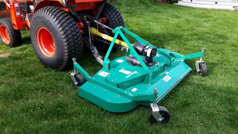

I took deliver of my new 6' Agmate Rear Mower from Agri Supply this past Friday.

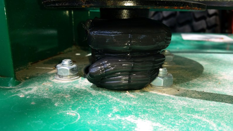

First thing I did was to make sure everything was tight. Next I checked the gear box for oil, and had to add some. Last was to grease each spindle. The center and right spindles (looking from the rear) both took about 30-35 pumps of grease until I saw it coming out the bottom of the spindles by the shields. The left spindle, after 40 pumps wasn't showing any signs of grease exiting. I took the top covers off and all the grease had come out the top. The center and right didn't have any come out the top.
Would this just be a bad bearing seal on the top?
I called Agri Supply and explained it to the CS rep, he said he'd send me out a new spindle assembly right away. I've purchased a few things from them and there customer service is great.
Another thing was I had to do was cut down the driveshaft. Once I tried hooking it up to the tractor, the u-joint was an inch beyond the PTO shaft.
With the deck mounted and the driveshaft connected, despite the spindle seal issue, I decide to try it out anyways. The mower did a great job! It was quiet and really did a nice job cutting.

I purchased the same mower this year and so far it's been great. I was glad to see the driveshaft was long enough for me to use the mower on my quick hitch. I too put a lot of strokes from the grease gun into the spindles without seeing any grease come out. Looking at the photo of the spindle on their website I suspect it has sealed bearings anyway. I just read their description that claims it requires 60 strokes upon installation. Either way I wouldn't be concerned about how many strokes I put into it or which end it came out of. Spindle Assembly | Agri Supply, 78582
A lot of mowers use sealed bearings in their spindles. I'm thinking the grease in the space between just absorbs some heat or may work it's way in past the seals.
