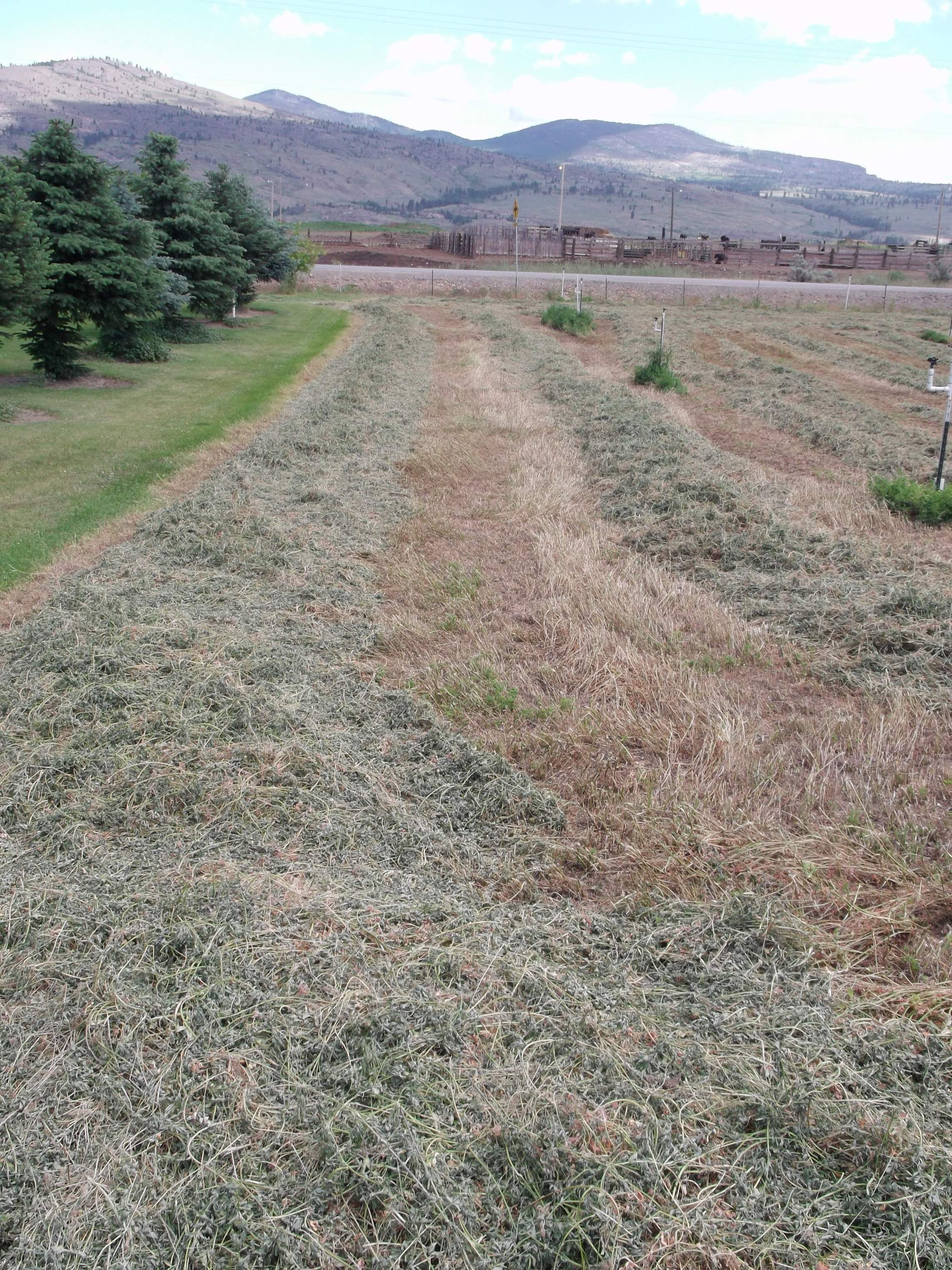

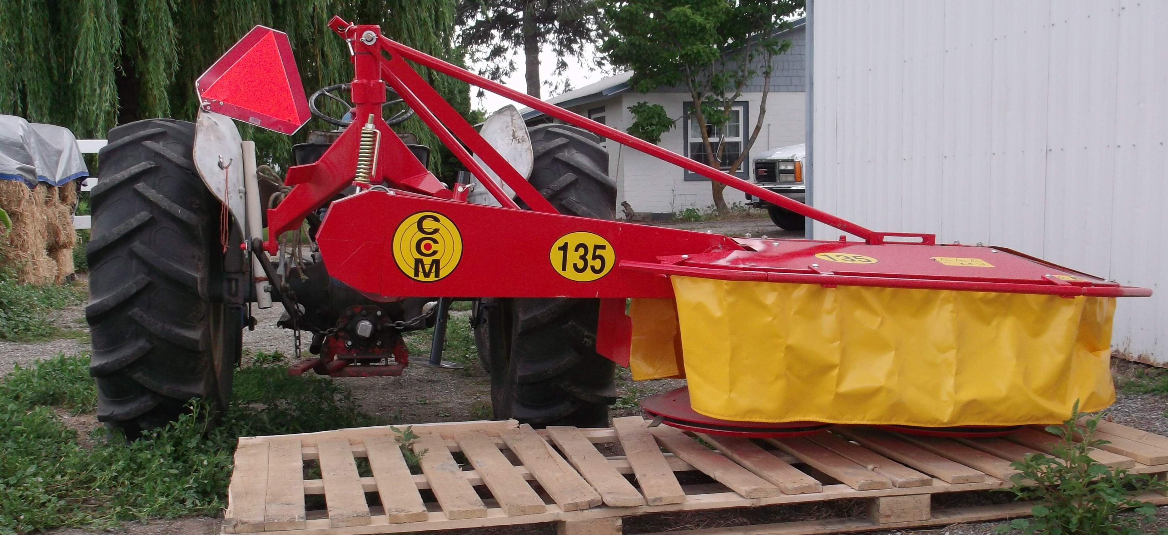

I started haying alfalfa about 8 years ago.... Bought a sickle bar.... WAPITA.... Rebuilt the cutter,still had problems..... finally I bought a drum mower.... what a dream to cut hay with.... doesn't plug up when cutting..... mows clean at about 1 1/2"..... hay dries fast without conditioning.... I use it on my NAA....
I can highly recommend a drum mower.... My neighbor cut my alfalfa, while I was between mowers and he used a disc , JD mo-co 14' wide.... It was faster than the 4.5' foot cutting width of the drum.... but that's about all.... the drum is fantastic....
