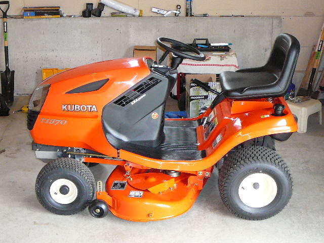

My new T1570 lawn tractor has a decal on the engine that says 'KUBOTA hydraulic valve lifters' on it. Also the oil filter says 'Kohler' on it. Does Kohler build this engine for Kubota and do all Kohler engines have hydraulic lifters?
This is a 15 hp single and is extremely quiet.

I could be wrong, but I would be very surprised if it were a Kohler engine. Kubota usually makes all their own motors.
   / New baby Kubota #3
Most of the Kubota mowers and garden tractors with gas engines are either Kohler Command or Command Pro engines. In the recent past some had Kawasaki gas engines, but I'm not sure if they're still using them on their products. Not all Kohler engines are listed as having hydraulic lifters.

Hound is correct. For example the Kubota T1760 employs a 2 cylinder, 17hp, liquid cooled, Kawasaki engine.

all of the T series utilize Kohler engines. We used to use Kaw. but we had problems with them and discontinued their use.
