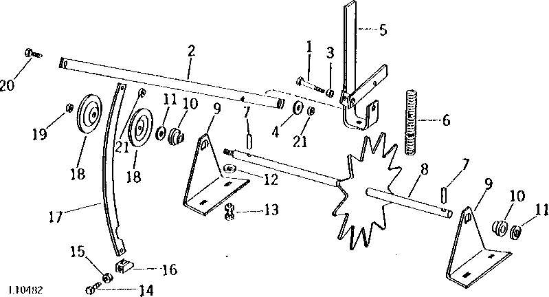

maybe i'm off -- but in my experience the size (length) of the bale has little to do with the tension. If you adjust the tension, you will get tighter or looser bales. If you want shorter bales, move the adjuster on the needle trip arm. Two separate adjustments for different purposes and desired outcomes.
Now if the weight is an issue -- both length and tension can be modified to adjust the weight :)
You're 100% correct. If I chose to I can make a tight 18" or 36" long bale with my JD 347 baler that one will have difficulty getting their fingers under the wires.
   / New Baler for small (light), but very tight bales of an accumulator with grapple? #19
^^^^^ What TxJim and mattv1 said - bale length and bale density are two different adjustments... ^^^^^
