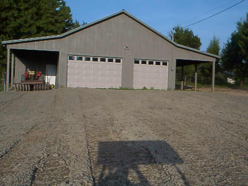

Here us what I did with a 30 foot main slab for my barn which has 12 foot wide sheds on each side. I had one 14' wide door and one 10 foot with a 2 foot divider in the middle. It works just right for my welding receptacle behind the 2 foot divider and my machine sets right at the wall out of the way of everything else and close to the outside so I can reach my outside welding needs or work off my table at the door.

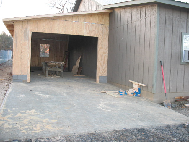

I recently put on an addition on the rear for additional storage. It is 14 wide by 30 long and I had a 14 x 18 slab poured outside the door for boat washdown area. I am thinking of putting a 30 x 20 pad on the front of the shop where the two front doors are.

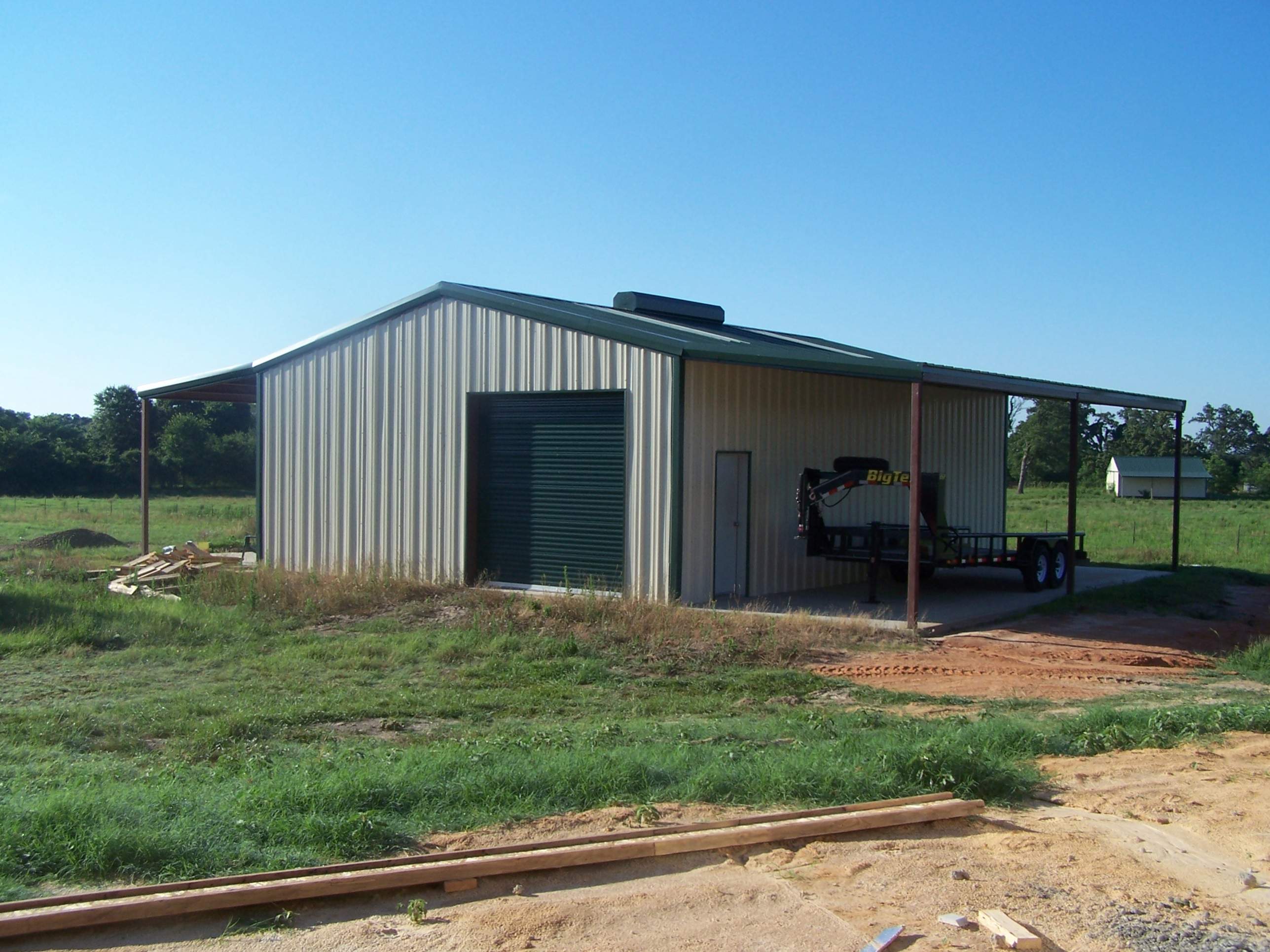

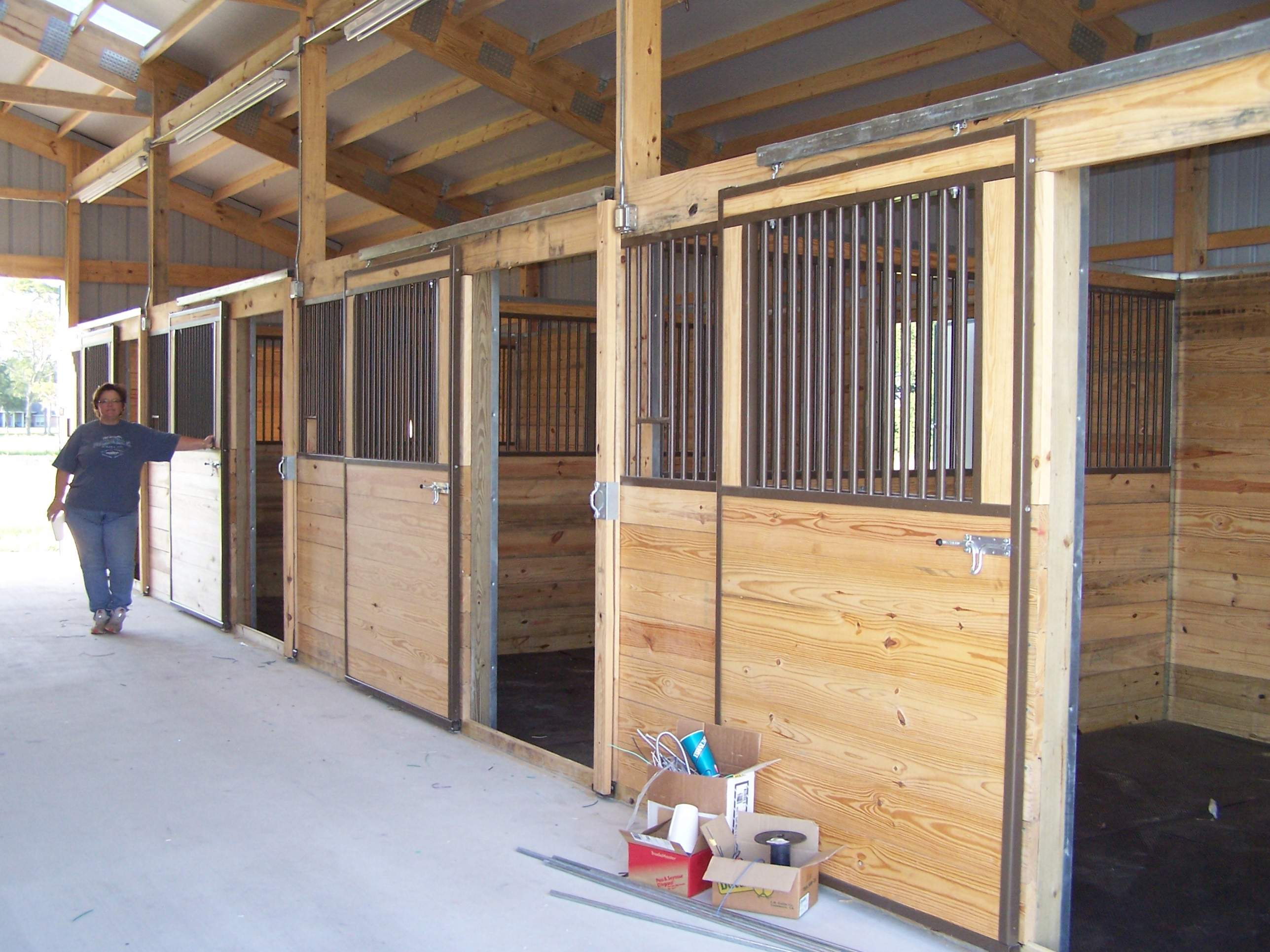

Depends on how much clear space you want on each side of the doors. I offset mine on the hay barn, 30'X40'X12' with 12' awnings. There is a workbench and shelving units down the side wall next to the drivethru bay. I store hay and stuff on the other side. The horse barn, 36'X48'X10', has the doors centered with stalls on each side.
