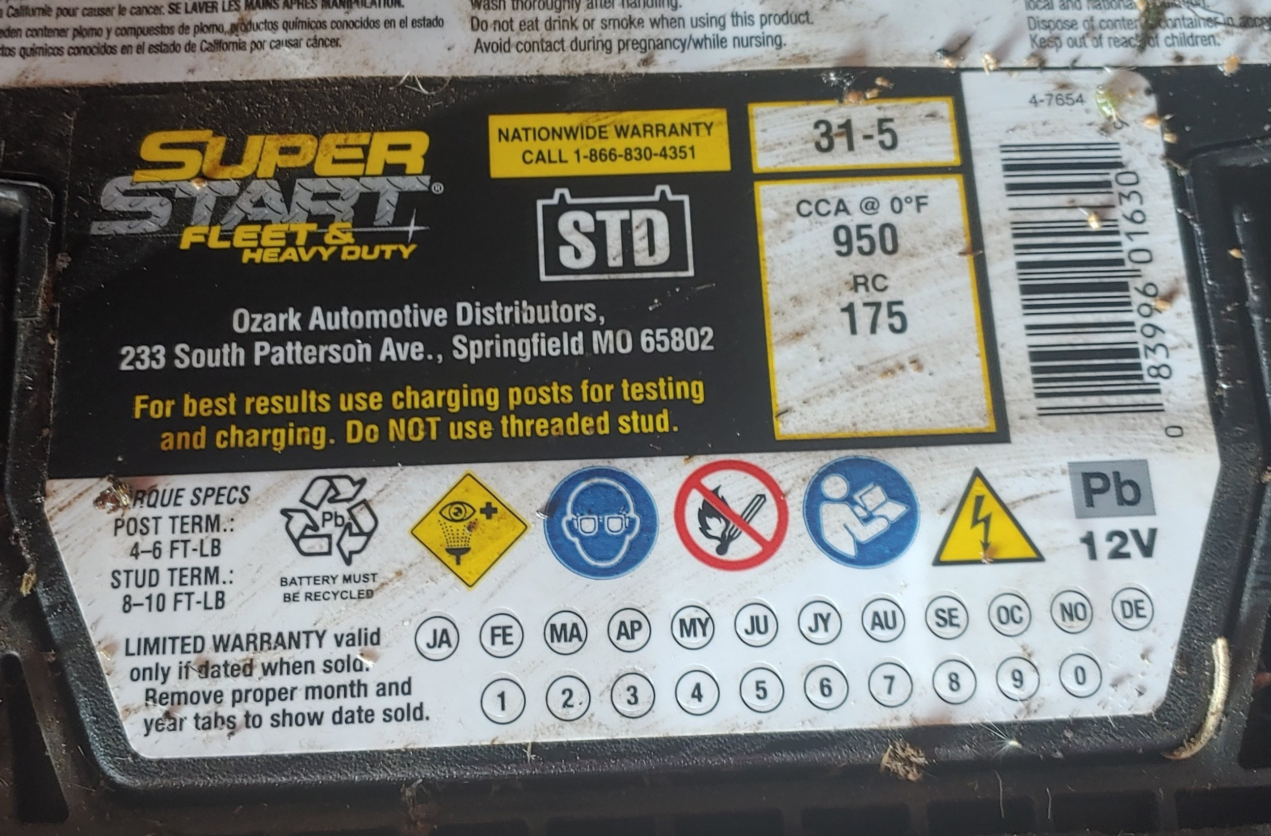

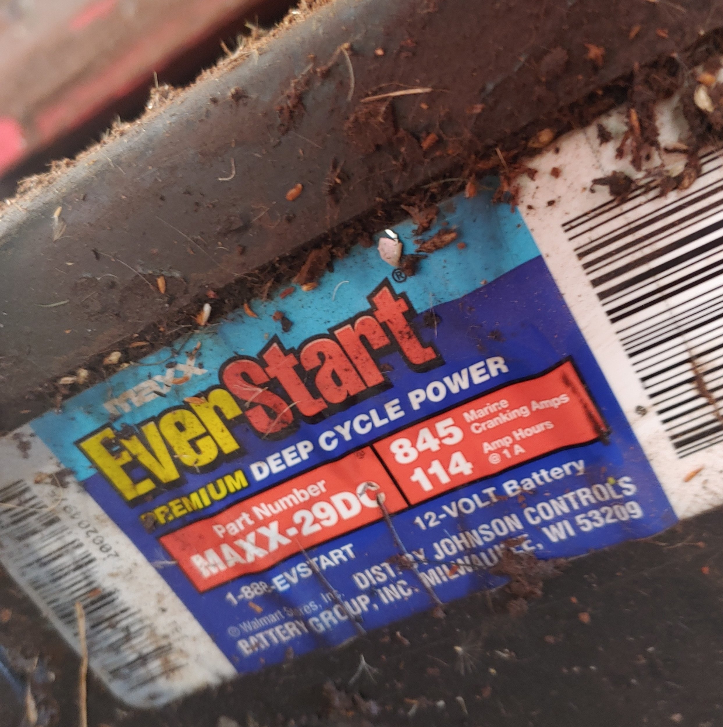

Back story: I had ran out of fuel in the woods and upon refueling, I ran the battery dead attempting to start the engine. I got my Shumacher 1000 amp jump starter to kick her off and drove back home.
I charged the battery overnight, all seemed fine until my next attempt to crank and the battery was dead, or extremely low. Just turns over a time or two and nothing more. Very weak.
That battery is at least five years old and other than this occurance, I've not had any issues with it.
This weekend, after a few more charging/cranking attempts (I jumped it off successfully from my truck and another time from the Shumacher) I bought and installed a new battery.
The battery acts the same... a couple turnovers and no start.
Pictures of the old and new below.
Old battery: 845 'Marine cranking amps'
New battery; 950 CCA.
What am I missing here?
Thank you in advance for any advice/wisdom.
2nd question: I would like to purchase another jump start unit... anyone recommend a specific brand/model at a good price?

Charge the new battery again. Take it to a location that has a Carbon Pile Tester and have them test the battery. If the battery passes start looking at the starter. You will probably have to take it off to have it tested. Check the cable leading from the battery to the starter with an OHM meter. Clamp the OHM probe leads to each end of the cable leading from the battery to the starter and then wiggle, twist the cable to see if continuity is maintained.

It's likely that the heavy starting loads from jumping (you are also running current to the dead battery besides the starter) have built up a large resistance on battery cable connections. Easily cleaned with a file or sandpaper. OR: you have burned thru a cable either at the connections or internally. Always disconnect the dead battery when trying to jump with a jump-pack. A battery only gets to be flattened a few times before the plates swell and short thru. You might also check the water level in the battery cells. I use distilled water because tap water probably has minerals in it that are conductive. Rural King sells distilled water in gallon jugs.
   / New battery not starting tractor #4
My guess is you fried a battery cable / cable end. If one is super stiff and kind of cracks or insulation cracks off if you try to bend it then that's likely your culprit.
