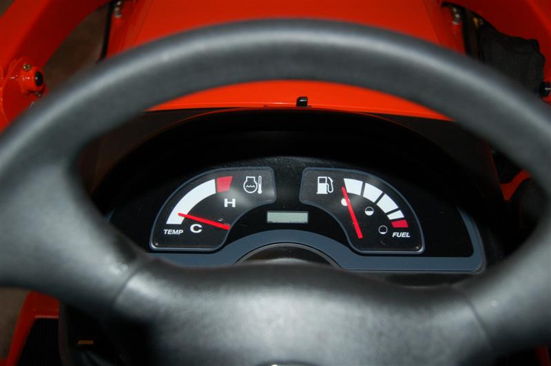

More pics...this is the new, backlit dash. (Lots of dummy lights, you just cant see them here...)
