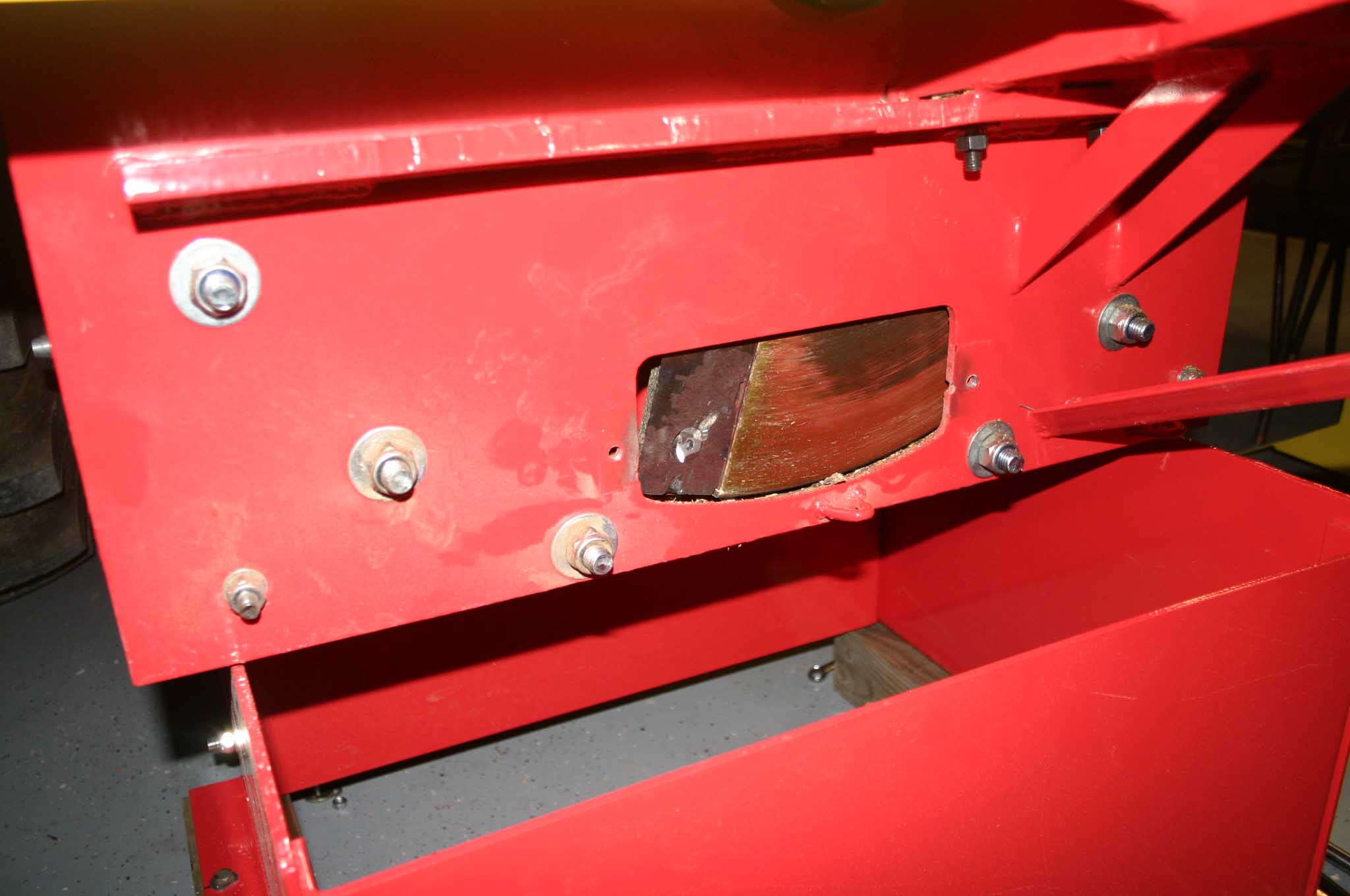

I find the blade gap out of adjustment on everyone. I have found on a couple where a little grinding was needed to allow the anvil to lay flat.
A picture of the broken blade was be nice/interesting if possible.
The blades/anvil are so hard they are brittle and must lay flat.

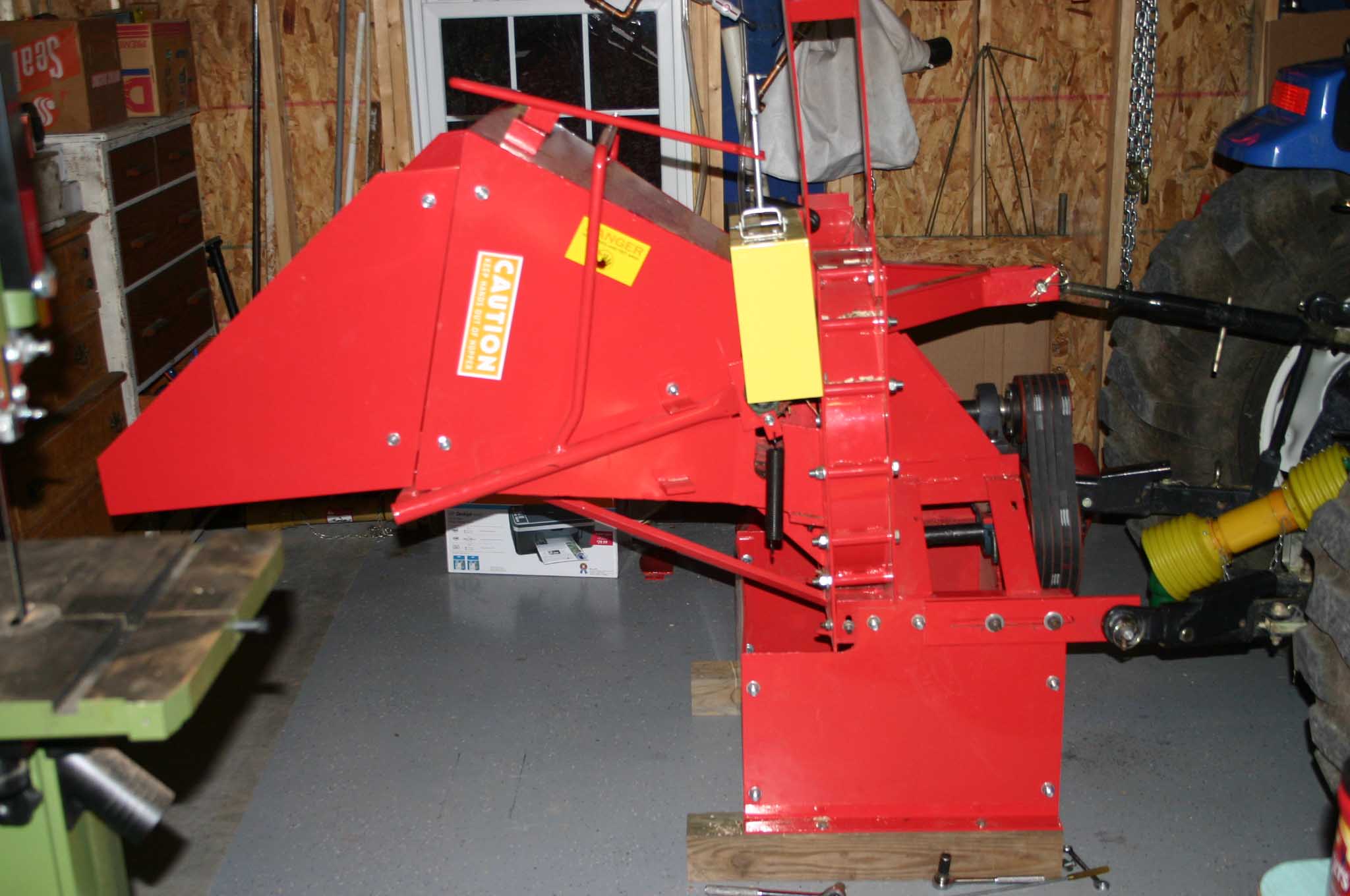

Here are two pics of the chipper. I already had the blade welded and back on the machine when I took these pics. I spent several hours checking this chipper before I ever used it. I was chipping 3-4" oaks when it happened.

Good lookin chipper. Even with the broken blade, you'd have to admit its a great machine for the money. FWIW, on my old chipper, i had a machine shop make me new knives (4 inch) out of hardened tool steel. It cost me under thirty dollars (i gave then an original to copy). Just something to keep in mind should you have any more knife problems.
