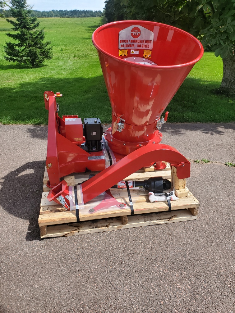

I had a Wallenstein BX40 for many years and got so fed up with it jambing the exhaust shoot that I decided to sell it. I was originally going to purchase a bigger unit with a hydraulic feed and hope it would work better. I happen to find the Split-fire 4003 and I'm sure happy I did. First the design made to much more sense to me. The disc speed is much faster, allowing the chips to fly out easily. The exhaust is shorter, and on the horizontal plane leaving the chipper, compared to the other designs that shoot the chips upwards. Also comes with a safety Emergency switch. I bought it with all the options. The hitch will be nice to pull along a trailer.
I was able to test it on freshly cut spruces, aspens, and birches. It just ate everything without an issue. The disc weighs 100 LBS so it keeps momentum in heavy stuff and makes for a smoother operation. I ran it behind a Kubota MX5100.

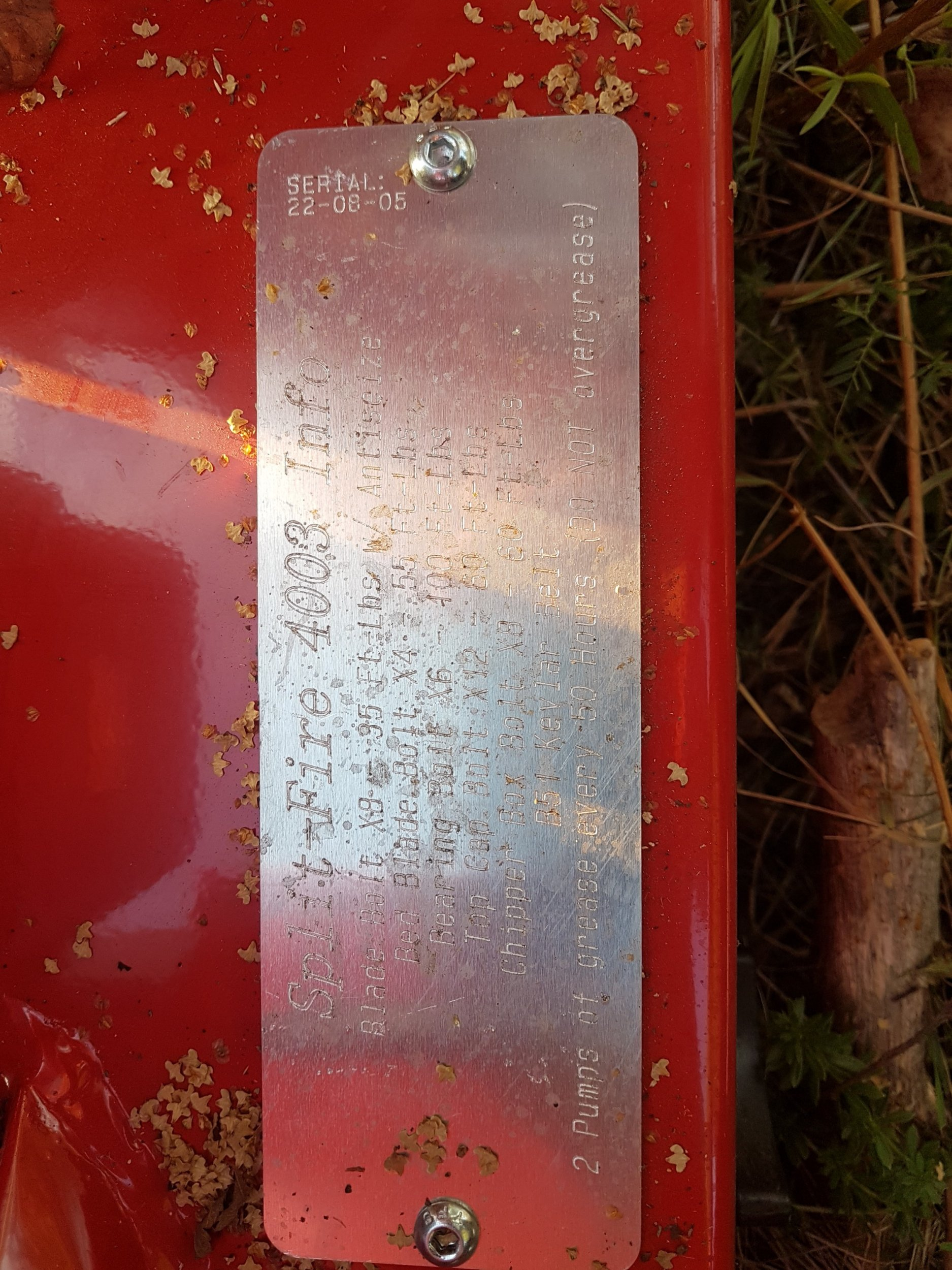

As you can likely determine, I'm really happy with it. It's well built and the details are nice. It has a metal plate with all maintenance info stamped on it for example. Made in North America too, which is a nice bonus to me.
Anyone looking for a chipper should at least look at it in my opinion. It's rated for 3.5" material, but the opening is bigger for twisty stuff. For me anything bigger than 4" I keep for firewood.
I'll try to get pics of it in action, for now all I have is a pic of it nice and shiny on a pallet.
/ New Chipper: Split-fire 4003 #2
I'll be looking forward to your next pictures............
Is that RED...or is that RED.

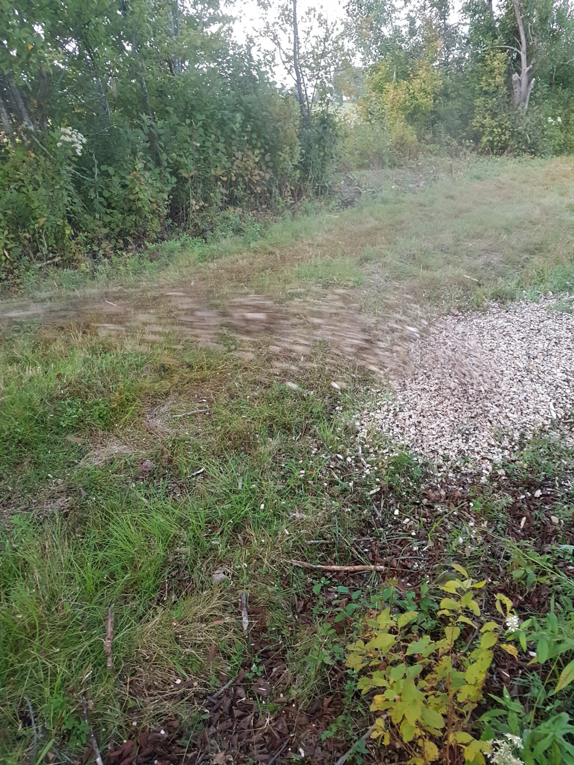

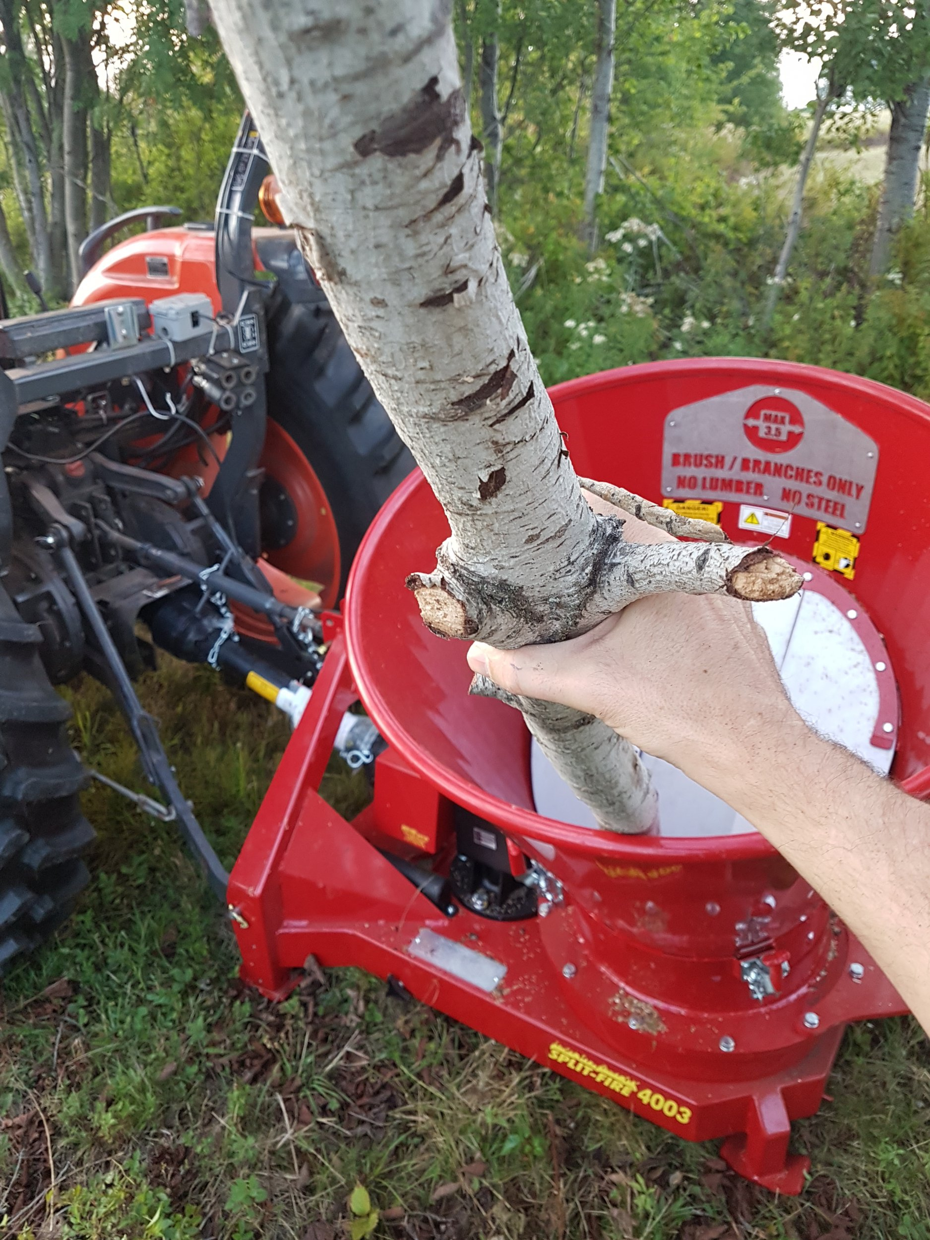

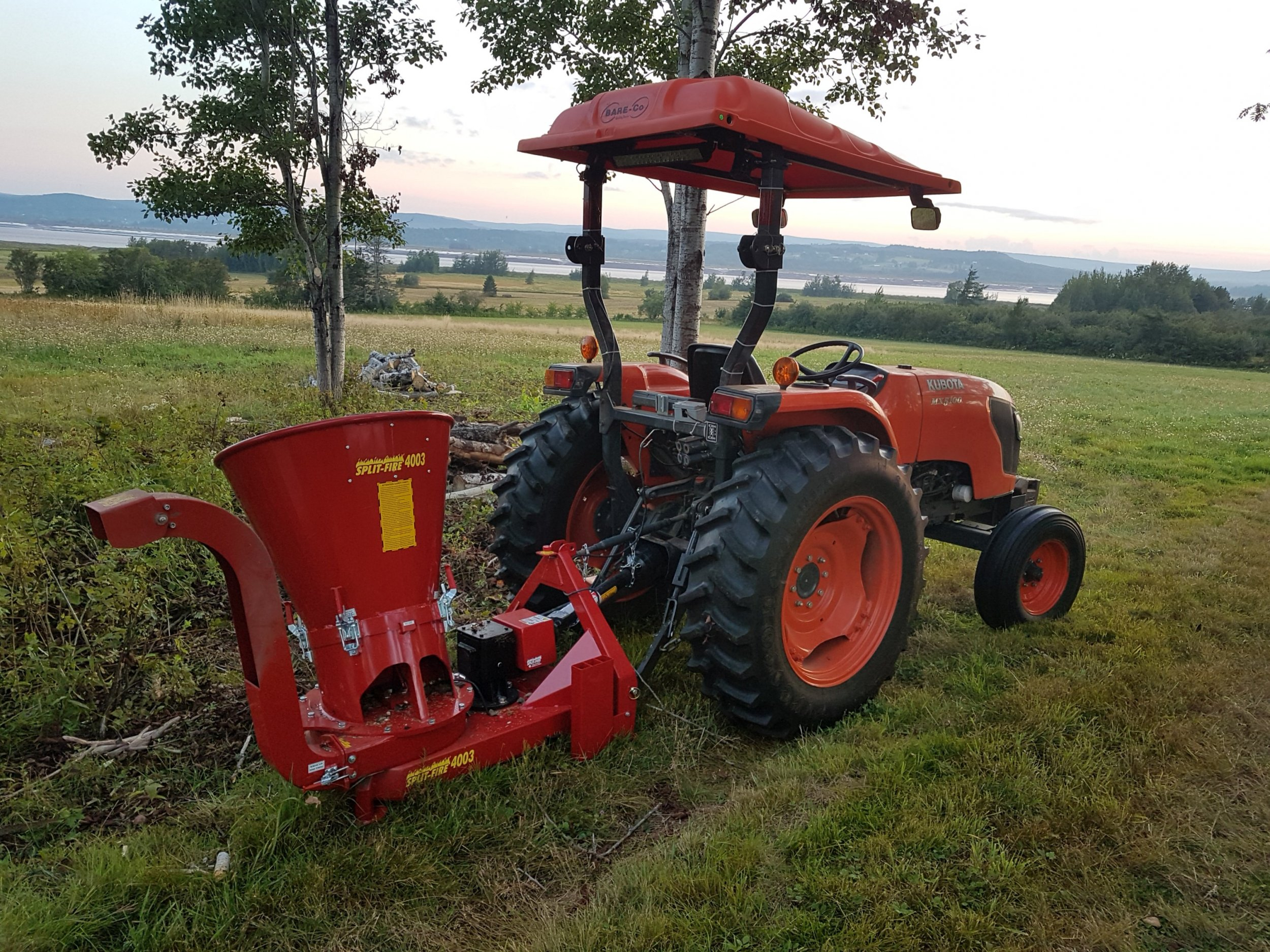

So far I'm really liking the Split-fire. I took a few pictures to try to show the air flow that it generates. So far I fed a good variety of wood fiber and it eats it up.
I have a few pics of the items I chipped tonight, and how it ends up. In one of the pics the chips can be seen flying up the shoot. Also included a picture of the maintenance plate. Wiring the switch took a bit of time, but I'm happy it's done.
Here are a few pics to show the shiny red paint. 🙂

Yes, the manual feed unit do pull in quickly. The worst for jambing for me in the bx40 were birch trees. The tiny branches would bunch up in the shoot.
The Split-fire does pull too, just not as aggressive.In the pictures I had limbed the branches, but there's no need. It'll take bushy branches no problem.
I'm familiar with the slap as well from the bx chippers. The branches do move in the Split-fire too so it has the same attitude at times. If I load from the right side of the feed tube there's no problem.

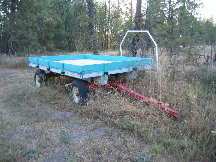

Nice chips you got there.
Going to hook mine up this morning .

Question for oldballs...
What material are you using for the back-stop in the trailer?
/ New Chipper: Split-fire 4003 #10
It is a sheet of aluminum about 1/8 " thick. Sometimes I use some 1/2 " plywood IIRC.
