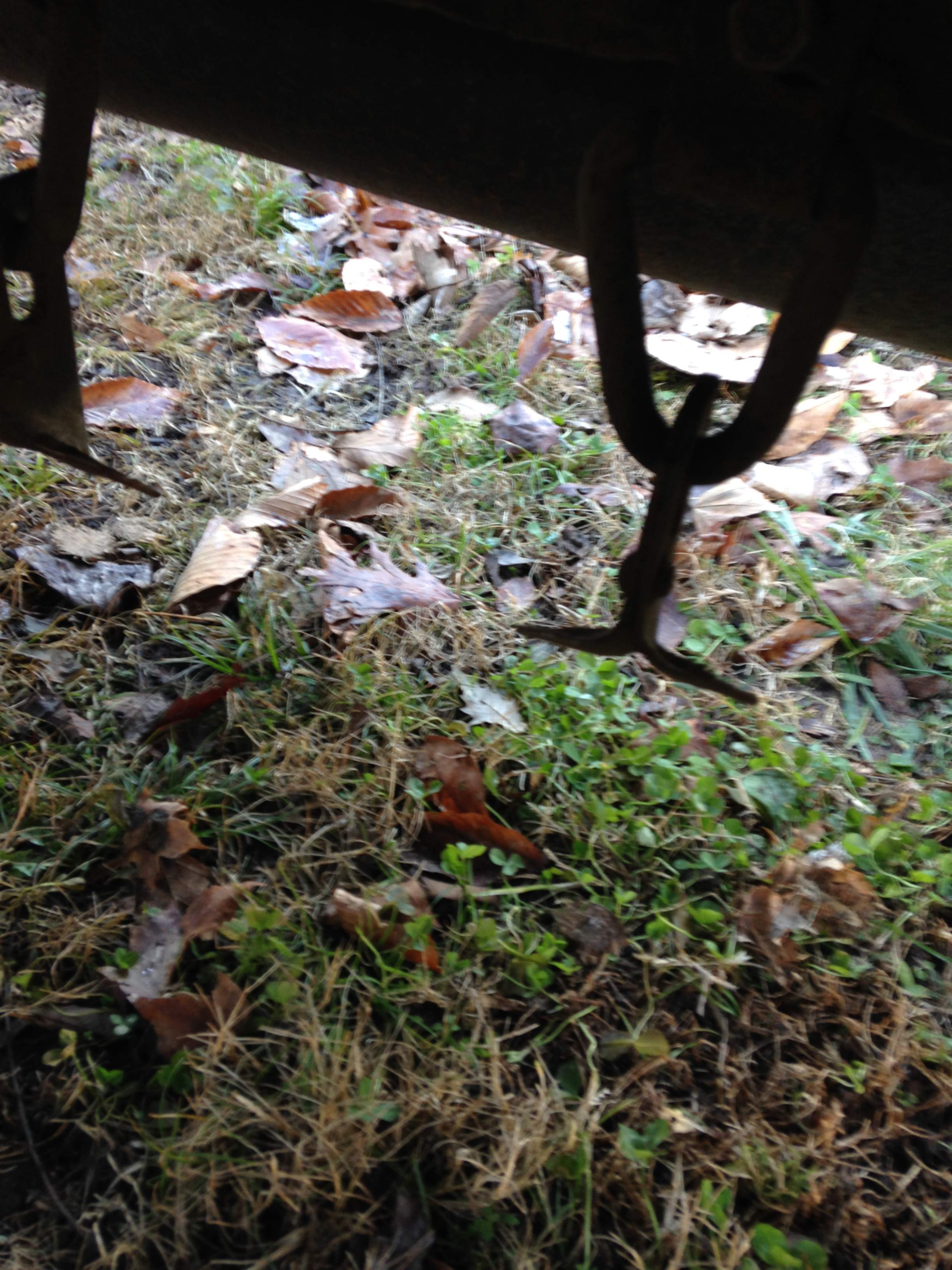

I had an expensive weekend. I bought a four bottom plow, a 10' transport disc, and this 7' Ford Flail mower. I am not sure what the model number is, can anyone tell from the tag?
I am looking for a manual, or any maintenance instructions. Specifically what to put in the gear box, and how full?

That is a Ford 907 and fill the gear box to the level of the sight plug on the back, with 80-90 weight gear oil. If there is a bottom plug, drain and flush it first.

I broke a belt on my new mower today. My fault, I was mowing thick grass, too fast, with the cutters too low. I thought I got a wiff of burning belt, but I ignored it.
Anyway, its a ford 907. Its about 7' wide. To refresh memories, here it is.
What size belt do I need, or a link to an online supplier? Does Tractor Supply have anything this heavy? Does anyone have a link to a manual, or do I have to buy one?

Use messicks home page and type ford 907 in the search box.
I dont know off hand what size V belt you need BUT
you can get good belts just about anywhere.
As long as you have the old belt they can measure it
for you and get you a new one.
Just be sure to ask for a kevlar belt (green belt) and you will be fine.
/ New flail mower #13
I believe you will find this to be a metric belt. Google ford 907 flail mower.

I did some googling, and found this thread.
http://www.tractorbynet.com/forums/new-holland-owning-operating/239223-v-belts-ford-907-fail.html
I will see if I can find a C53 belt for my pre 1970, non-spring idler. The thread says the post-1970 models have a springed idler and use a C52 belt.
ALL V-belts and roller Bearings are metric.
