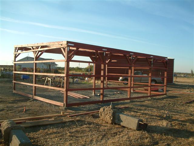

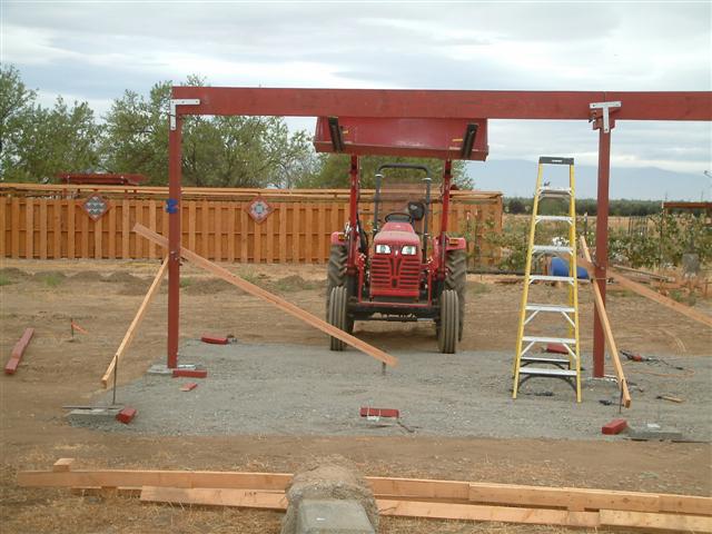

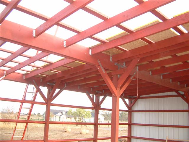

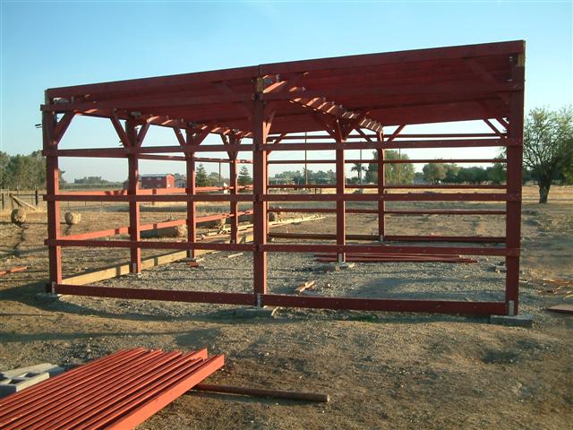

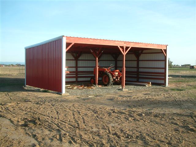

Hmm-concrete blocks--not my idea of simple and easy. Makes my back ache just thinking about it.
Why not go with a pole frame design. Here's a 20x28 ft equipment shed I built a year or so ago--by myself (at age 67). It's has metal sides and roof.
The 2008 Mahindra 5525 came in handy getting the 4x12 beams in place.
There's about $3500 in materials and about 2 months of my time--I'm old and I work slow, especially when I'm on a ladder or doing the roof construction.
You can adapt pole frame construction to whatever garage design you desire. The nice thing about doing it this way is that the foundation is simple to build.
