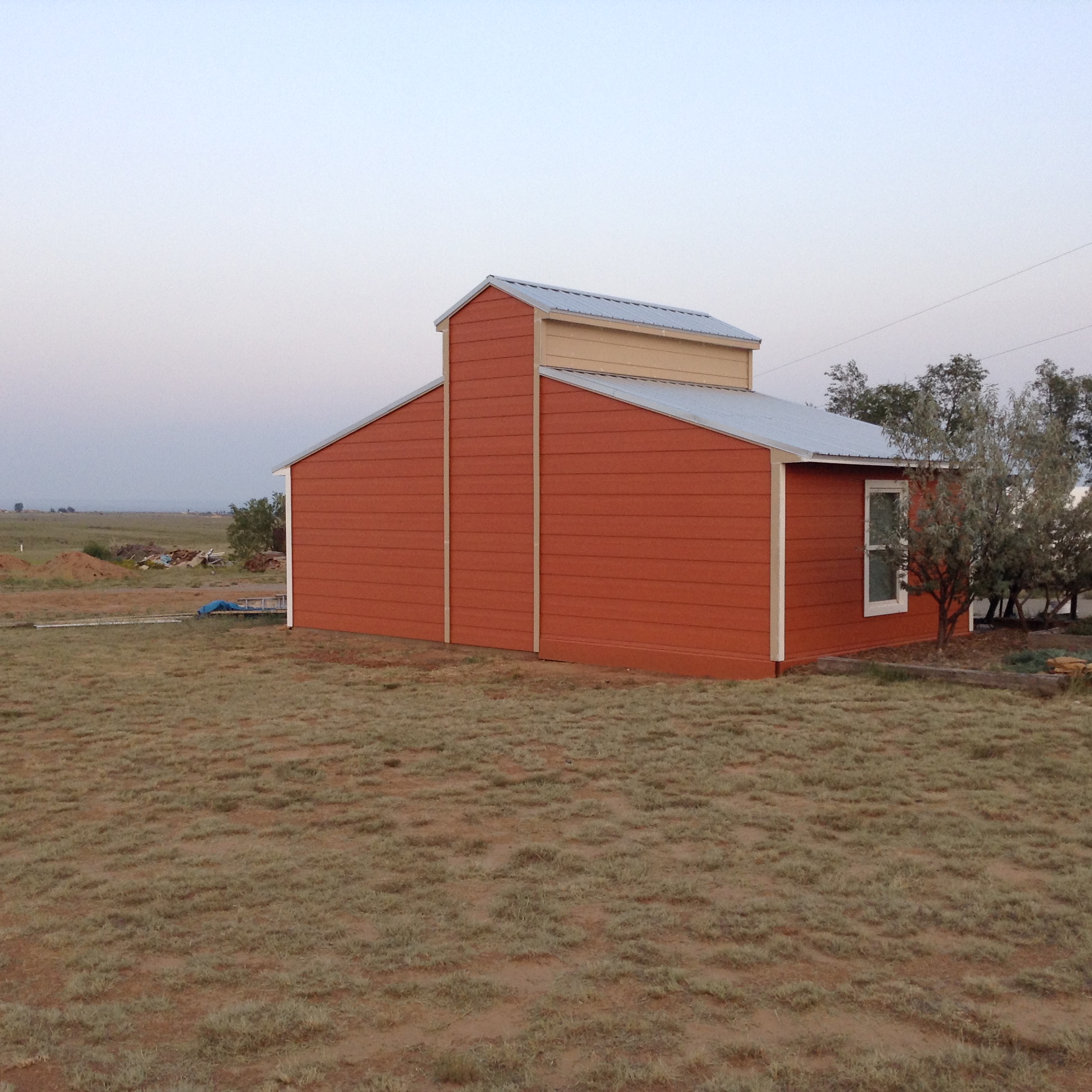

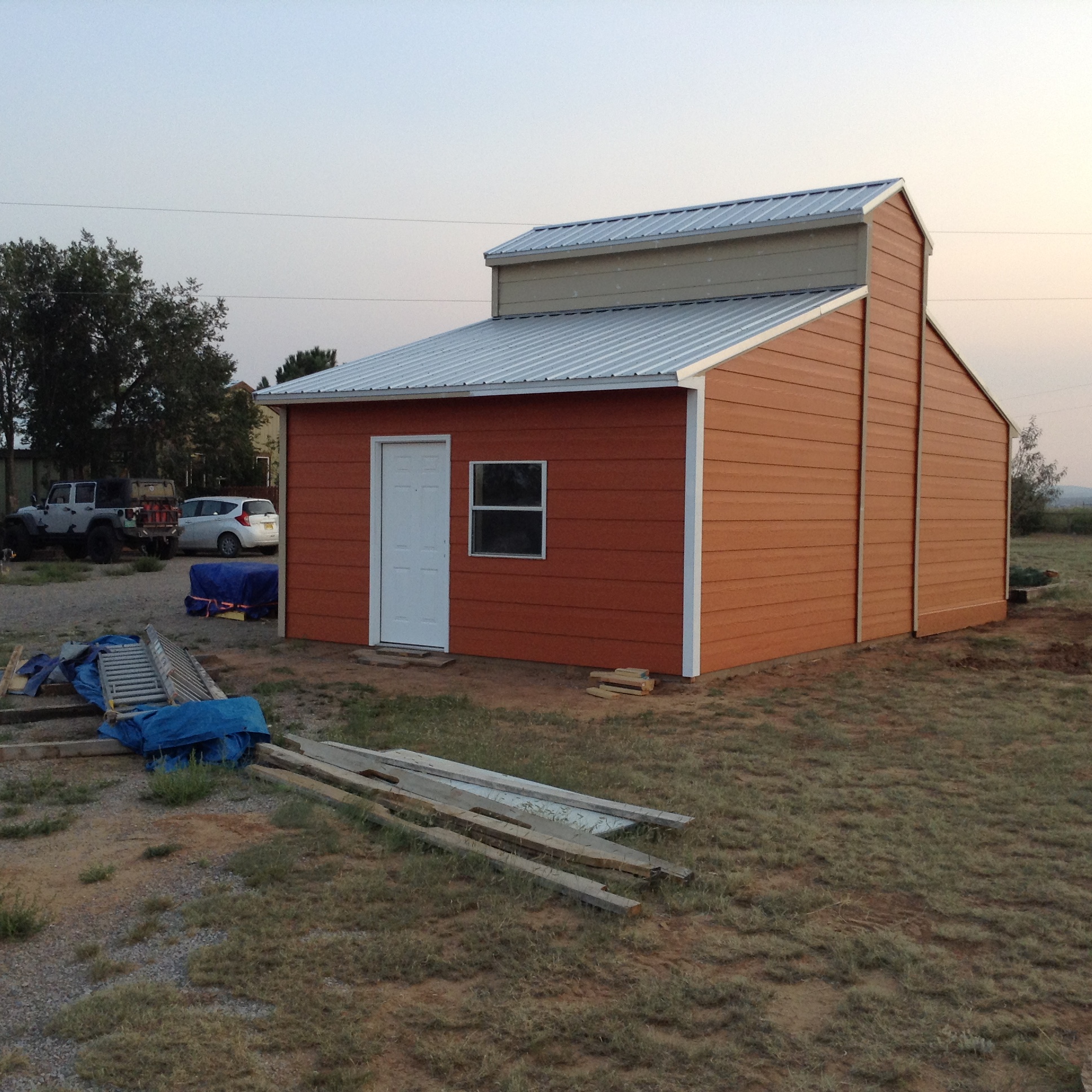

I just finished up my garage similar in size to yours. I used a composite/wood siding (11 7/8" x 16' ) called "rough-Tex" siding. I think it is made by Georgia Pacific. I know HD carries it, but I got it at a local lumber yard for about a $1 cheaper per piece. I paid $11.25 per piece. It comes in 3 widths: 6", 8", and 12", plus 4x8 sheets. I have attached some pics of the garage with the siding. I used the 12", 1 1/2" overlap. I have found pieces of this material buried (on the surface, maybe 1/2 to 1" down) that is probably there for 5 or 6 years and they are "almost" still usable. This is not the James Hardie concrete siding. That stuff is difficult to put up, is very heavy, and breaks easily.

That is very nice. Finally having looked at Morton site, I'll go with metal sheets siding. I effectively realized that with very little attention i'll be able to avoid the "potatoes warehouse" look.
