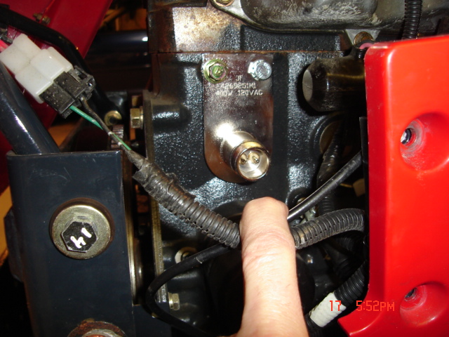

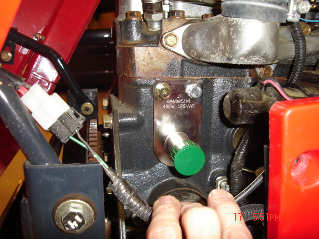

   / New GC 1710 Cold Start #6
I agree; although the M-F block heater is way overpriced, it's worth it. Fit into the frost plug hole beautifully, no leaks, works great. I also found that the electrical cord can be removed and it's retaining nut replaced with a garden hose cap for summer to keep the cord from being damaged.
While the tractor may not absolutely NEED the heater to start when it's really cold, I figure it's got to make life for the engine, starter & battery a lot easier. I put mine on 6 years ago and it still works great.
