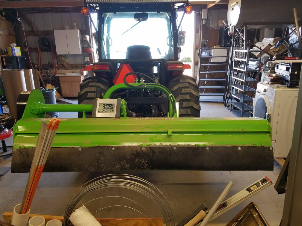

I'm generally mowing at 3-4mph. Usually medium-low. Occasionally pop it into medium high or go down on low range. I have a wide flail so am hurting for HP unless its light material. Even if I'm not hurting for HP I dont go much above 4mph. I'm generally on rougher fields. Even if it's a smoother field i don't feel like punishing my back.
