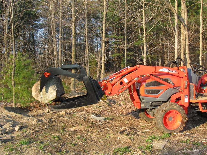

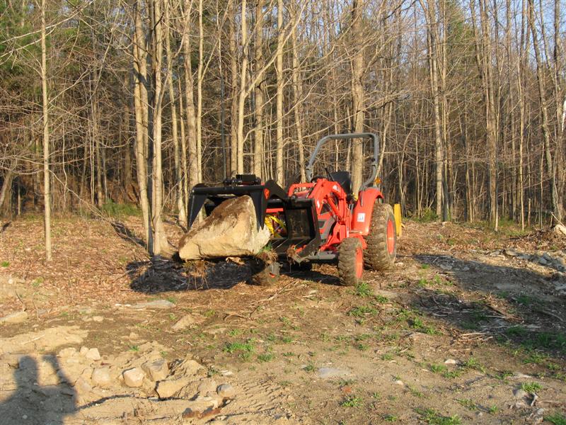

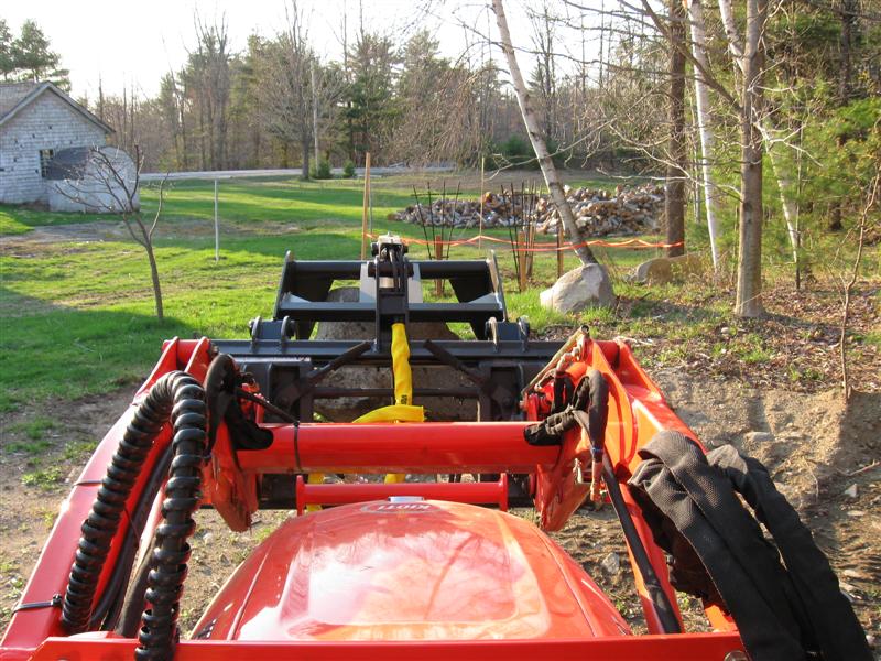

My new Markham grapple arrived yesterday and I got to play with it a little. I had everthing ready to go when it arrived and I wanted to give Island Tractor a special thanks for the great deal on the SS adapter and DHH for a great deal on hydraulic hoses and fittings. I purchased the rear hydraulic kit from my local dealer and that was fairly easy to install. I did have the dealer remove the detent balls in the valve so the control lever wouldn't lock.

The grapple is Markham Welding's 48" light duty grapple rake (light duty is an understatment) I had bottom spacer tines added ($100 dollar option) I told them I did not want the flat face hydraulic couplers they usally supply but I did want the hyd. hose. They are offering 1/2 price shipping right now, the whole package delivered to Maine was $1018.00.

You will love your grapple! Mine is two months old and I really have gotten my money's worth out of it. One surprise is how well it digs. I have been trying to change the slope of dirt roads to improve drainage, building water bars and channels to divert water off the road. I use the grapple to remove trees and roots and the box blade to grade and move dirt and clay. I have found that I can take a big bite of soil with the grapple and carry it to a spot I am trying to build up. I can get more "bite" with the grapple than with a toothed bucket. This helps to lower the soil level quickly and allows the box blade to work faster to lower the grade. Try it as it works amazingly well. I have the closer spacers like you have and most dirt will stay in without falling through unless its really sandy.
