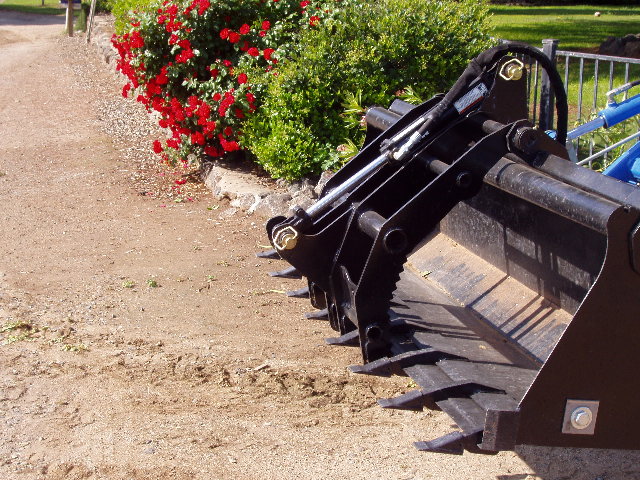

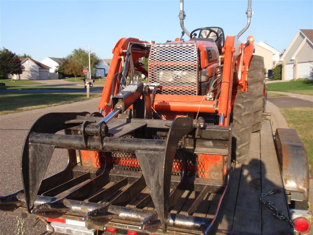

   / New grapple questions... #5
Here is the Gator/Markham 48" fully closed...
attachment.php

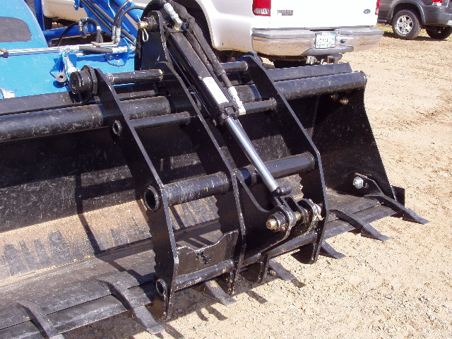

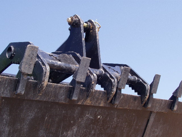

   / New grapple questions... #6
If you are considering a removeable upper grapple that attaches to your existing FEL bucket, also consider a toothbar at the same time as you will need to insure that there is adequate tooth/tooth separation between the two units when fully closed.
I sent a side profile of the FEL bucket to MIE and asked that they design the grapple for an "overbite" which they did. They sent me back CAD drawings and measurements for my approval and this is what I got back.
The toothbar is by others and I installed it before the grapple build.
